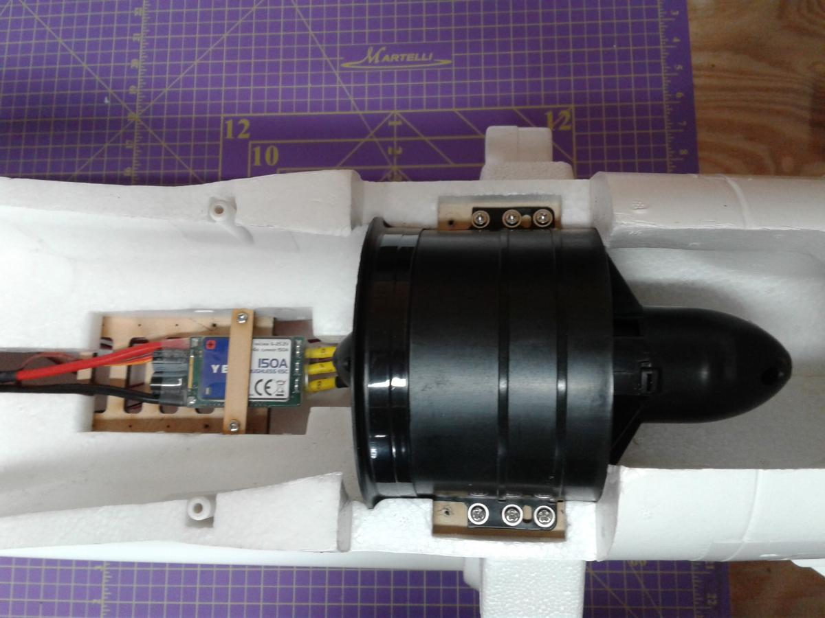

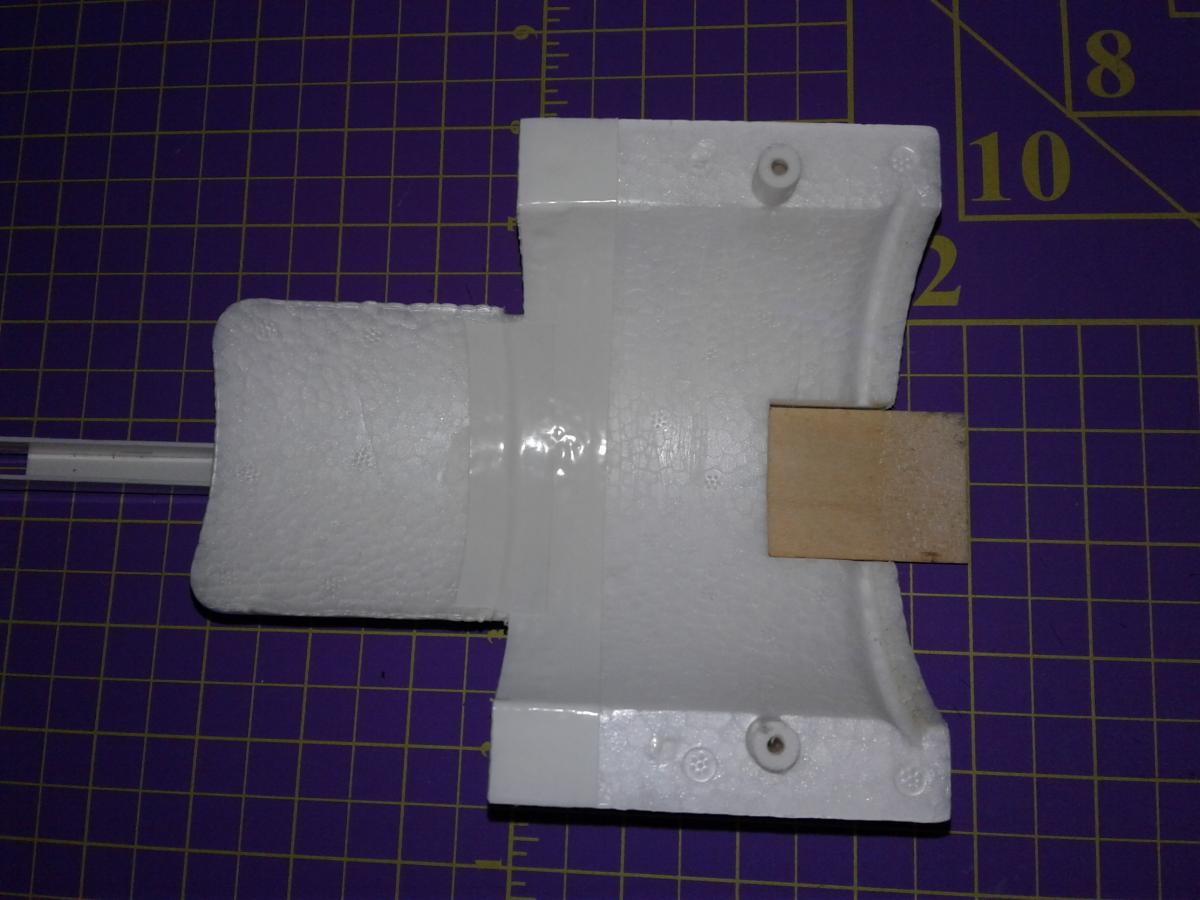

      Here is the mod for the FMS fan unit and YEP 150A ESC. All I had to do was trim the tabs on the fan unit and sand a small ridge away from under the hatch. I put tape over the area to help seal.

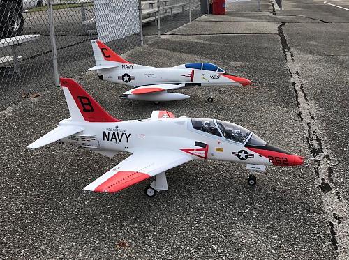

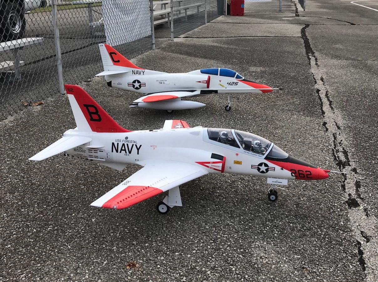

          • Finally got the T-45 in the air for its maiden. I think the CG was a bit too far aft, and I need to increase the expo on the aileron channel. Otherwise, very nice! Sets up very nice on final with gear down and flaps full. Looking forward to more. Guess I need a T-2C now. Click image for larger version

            • Really like the T-45. Keeps you on your toes when she is all dirty... Better fly her like a heavy jet. I almost lost mine on the maiden. Ran out of runway (pavement) and jerked her up to miss the curb. No problems after that until the battery (not Admiral or RT) hit LVC at 2:42!!! Pulled to idle and set up as best I could, then hit the throttle again and had just enough after reset to get her in without a bounce!!! :Whew::Scared: What a ride!!! Congrats to you on your maiden!!!!! :Cool: Glad it was not that eventful!
              • Congrats on the maiden.
                • Thanks Gentlemen! I can tell it's going to be a winner once it's dialed in.

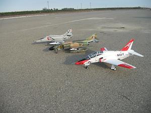

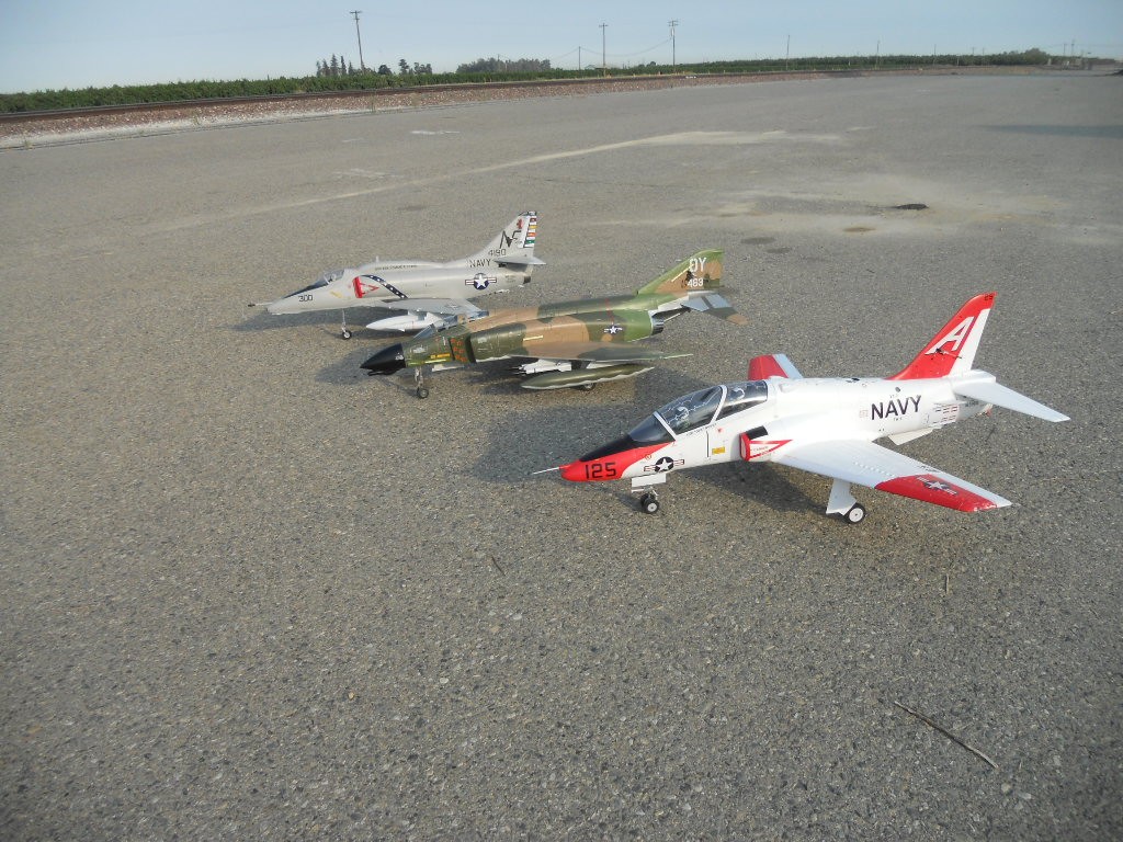

                      So, how is your build going? The T-45 is a great flyer and flies very scale too, I enjoy mine.

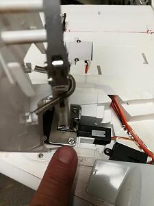

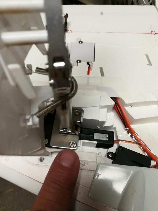

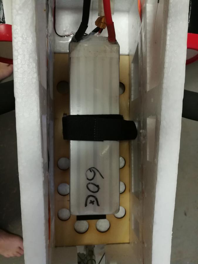

                                Another way to check CG is like this, gear down and with the jet upright, also make sure you have the canopy and the nose cone on the jet, just put your finger tips on one of the four retract mounting screws, the front inside one towards the slats, lift up and move battery one way are the other, you will be in the ball park at least, very easy to check this way. Your looking for a slight nose drop or if it wants to sit level that is even better.
                                Here is a pic of my Gensace 5000 60C battery placement and the screw I use. Of course your CG placement will change to your flying style. Hope this helps.
                                Click image for larger version  Name:	image_29770.jpg Views:	1 Size:	47.4 KB ID:	153893Click image for larger version  Name:	image_29771.jpg Views:	1 Size:	47.9 KB ID:	153894
                                • I didn't say "63mm aft of the front scoops", I said "located at the front lip of the plastic bunny ears [front scoops]". DCorsair's alternative method and pictures are good references for a similar CG range.

                                    Just going by what the manual says , 63mm from the front of the scoops or right in the middle of the top strobe light. I also like for a low wing plane to be balanced inverted .Now setting the plane on a balance fixture( inverted) an putting the pads on the screws like Dcorsair said ,I have a plane that's is level with a slight nose down attitude .and it's in line with the top strobe . I think this will work . Thanks for your help .

                                      Your way will work to but when your out at the field without your balance stand and you want to move your CG around, my way makes it so easy to change the CG, just reach down and place your fingers tips on the screws and pick it up, you don't even have to pick it up off the ground, it will drop the tail or nose as soon as you put pressure on the screws.
