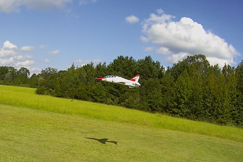

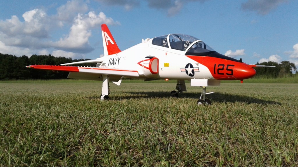

                                          Maidened the T-45 today! (yesterday now I suppose)
                                          Winds were mostly calm and temperature about 85F.
                                          Stock PNP outrunner, Admiral 6s 5000 50C (new version), FrSky Taranis X9D plus with X8R receiver and FLVSS voltage sensor.
                                          Flight 1 I held the nose on the runway which delayed takeoff and caused an over rotation. No trim required. Felt comfortable enough to do a low pass. Almost hit a pine tree later in flight.
                                          Flight 2 was 2 aborts and a short flight due to a fresh battery that had not been cycled. The battery was quite warm on landing. Changing to a battery with more cycles for the third flight made a big difference.
                                          Flight 3 saw a better takeoff due to proper soft field technique and plenty of power and speed.
                                          I flew the Admiral 6s 5000 all the way forward against the nose gear bulkhead. She required ZERO trim. I could not be happier. Planning to fly her tomorrow and Sunday before the weather goes bad here again.
