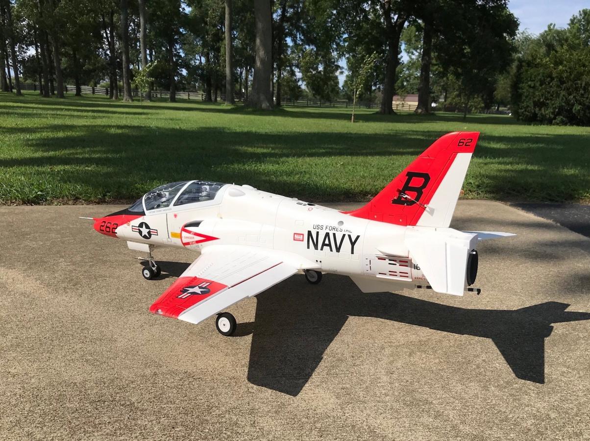

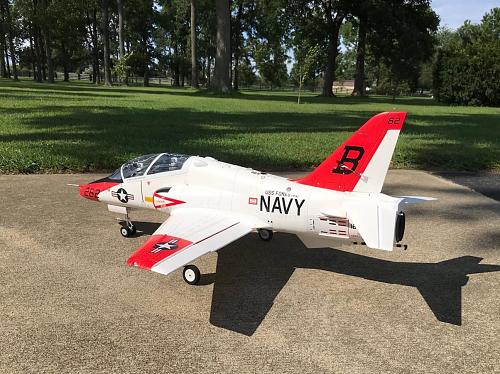

              Was able to get the T-45 put together today. Spent a few hours last night getting all of those pesky VT-7 decals off. Had a little fun taxiing around the driveway just now. Now to make it look cool with a little help from Callie, and set up control throws and slat/flap and speed brake integration etc. :):):) Click image for larger version

                Putting decals on a plane is just about the best ever! Can't wait to fly this one. Click image for larger version
ID:	147956Click image for larger version

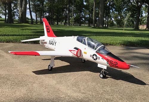

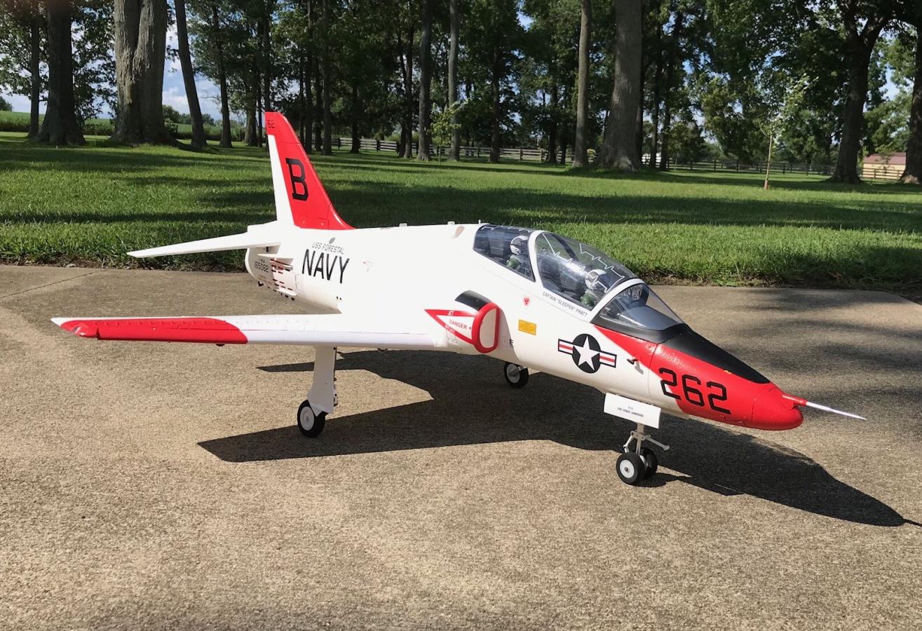

                                        After my T-45's argument with the tree, I have decided to re-power with the FMS90mm EDF unit and the YEP150 ESC. Hopefully testing this evening. With any luck, we will have video. And hopefully the grass is cut.
                                        • seaviper
                                          ATC retired
                                          • Aug 2016
                                          • 1092
                                          • Philadelphia Mississippi
                                          #200
                                          Ok I got in 4 good test flights today.
                                          Here is flight number 4
                                          Today, we arrived to find the field not yet mowed. The Bahia was rather high. It covered the wheels with some high ones sticking up above the bird. Improvise, adapt, and overcome. That we did.
                                          She performed quite well on the FMS unit. The sound is not quite as loud, or maybe as base sounding, as the stock unit. But it sure launched out of that grass no problema. My estimate is that she launched on average in about 150ft. That's with flaps 1 and slats out.
                                          Also, using the stock bec but without the landing light, there were no issues with the brownout thing.
                                          Overall I love the T-45. It makes a great jet trainer. Top speed is not record setting. But she is fast. And she really excels at energy maneuvers.
                                          As for the dings, I'm gonna fly her with spackle for a while. The stock decals were put on crooked and in the wrong places. Also the stock paint is not that great. So I plan on taking her down for a complete repaint in the near future. Right now I'm thinking a non-scale snow camo. But a scale scheme might be in the future too. We shall see. I'm just happy to have her back in the air and performing nicely.
                                          I really do recommend the FMS/YEP150 combo for this bird if one is so inclined. All I had to do was trim the tabs on the FMS fan a little and sand a small area under the hatch. Photos of that operation are available if anyone cares.
                                          And the XT90's work fine. The YEP 150 uses 12 ga wire.
