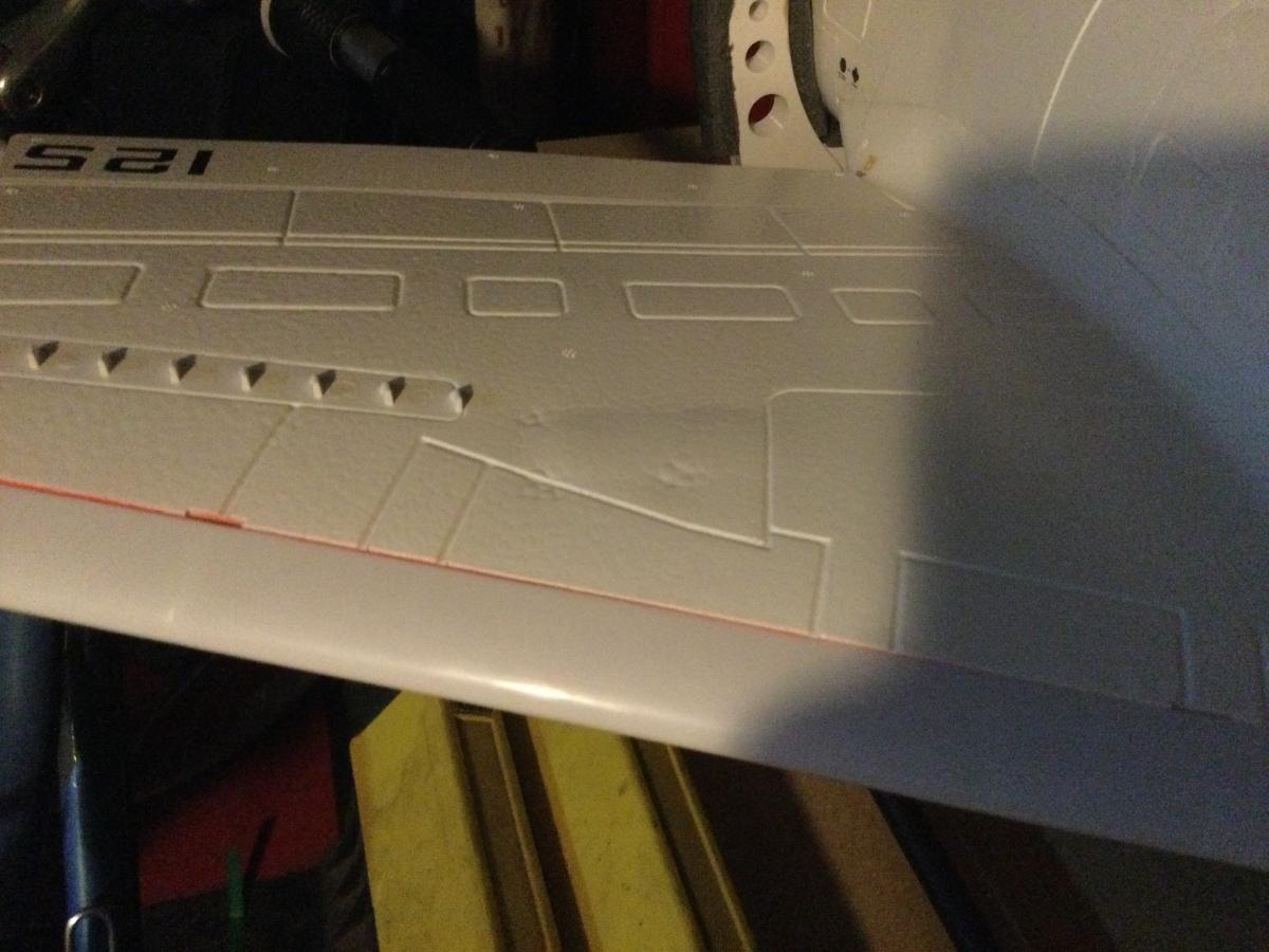

  • Rcfiddy1
    Originally posted by Tonybons
    So regarding my issue with bulging spots on top of wing straight from factory. I got email back from motion and here it is.
    They have looked through a few of the planes and they all have that slight distortion. I am sending you a picture. Best guess is it is done during manufacturing since they all have it. Sorry.
    So if your looking to buy this plane be warned your going to have the bulges above main gear until you decide to fix it. Utter failure from freewing.
    Hi everyone. I am relatively new to EDF’s. I fly large scale aerobatic planes, warbirds and turbines. I wanted something simple to load up and run to the field fir short days. I started with the 8S F4 which I loved. Took 10 flights to get use to landing consistently well and I lost the plane last week after 98 flights. I had no control of the plane but not 100% sure exactly what happened but I believe it was the wire to the BEC from the EC5 connector that it is soldered to, which came apart once before pre flight. It is a very thin wire that comes loose due to the constant connecting and disconnecting and pulling.
    I just ordered the T45 and started reviewing this thread. Can you attach a picture of the wing bulges you are referring to in the italicized post above.
    Are you all using the 70mm cg that someone mentioned in the thread or the 63 mm recommended in the manual.
    Tony
    This picture was taken the moment I assembled the plane.
    I can tell you that it looks horrible. I did my maiden this past weekend and even with 2 greased landings the top of wing has developed a small crack from left to right. There just is not enough foam above the gear mounting blocks to keep from cracking. After the second flight when I noticed the crack I wanted to see how much force was required to open it up. I pushed the wing down on the main gear and it opened up enough for me to apply some gorilla glue. I than tied a cord from main gear to nose gear to apply forward force on main to close crack. Not sure how long till it opens again since there really is no structural support front to back.
    Click image for larger version  Name:	BC87A4E6-979D-4976-A2CB-9680CBC86003.jpeg Views:	0 Size:	105.3 KB ID:	292423

  • Tonybons
    Tony
