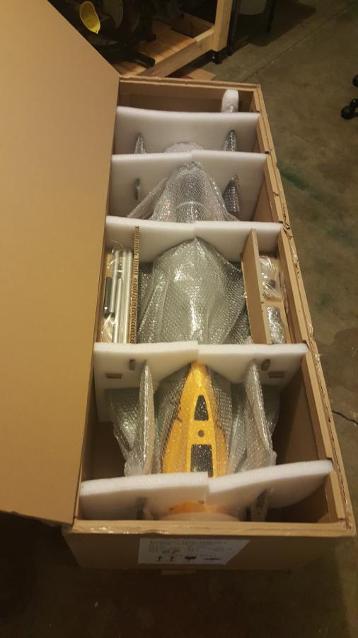

                      Thanks for getting back so quick. I was just curious about your impressions of the kit itself. Any pics of the unboxing? Overall impression of the quality of the build? Stuff like that...
                      • wolpertinger
                        Pilot ??
                        • 313
                        • Earth
                        Hey patrnflr,
                        The kit was well packed and protected. (had some pics but lost them) All the parts were covered in bubble wrap and supported by internal foam pieces. Overall finish is pretty good and fit so far is pretty good. Only thing that is a little off is on the vertical stab. It does not seem flow into the rudder. This is really minor as a small piece can be made to smooth this out. Plan on making minor cuts and adjustements as you go along. Here are some pics.
                          Hey patrnflr,
