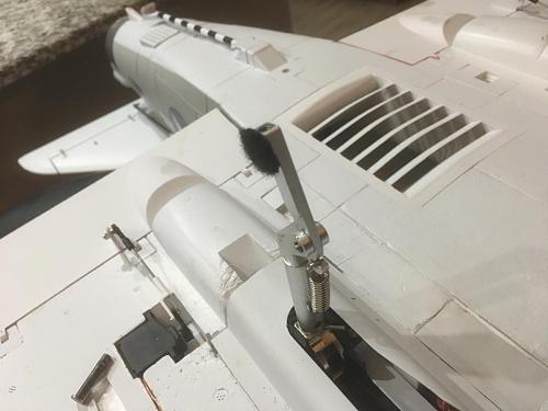

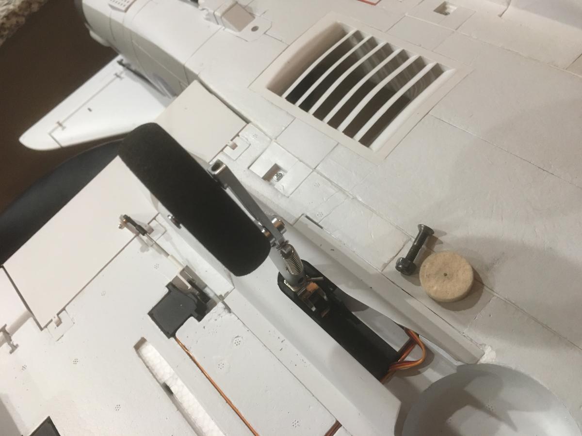

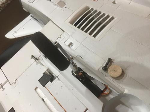

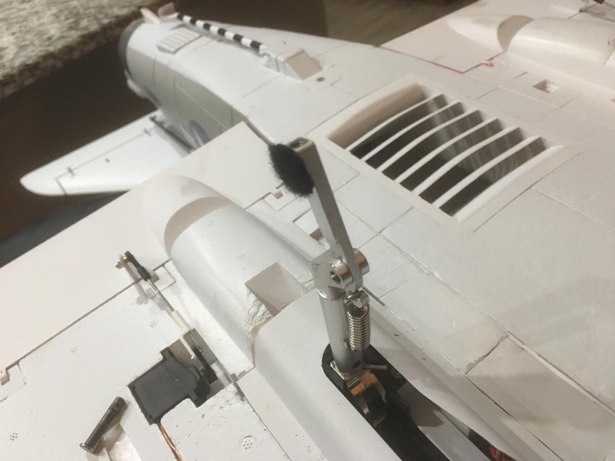

    Click image for larger version  Name:	136EDDEC-7B47-4EFF-8B6F-90FFEEDFC2FE.jpeg Views:	1 Size:	80.7 KB ID:	140639Click image for larger version  Name:	6072E982-7224-4C64-970A-CD387DA109E0.jpeg Views:	1 Size:	76.8 KB ID:	140638 MotionRC, please consider offering upgraded wheel axles and felt brake pads. I was able to reduce the landing distance to 75 feet by sticking Velcro on the strut. A felt disc would be ideal but I used what I had available today. My flight test was a success. There was only a slight increase in takeoff distance. All that’s required is a threaded axle, nyloc nut, and a felt disc. Braking action can easily be adjusted by tightening or loosening the nut. I posted my test flights on YouTube.https://youtu.be/hpUg-jOeoyc
