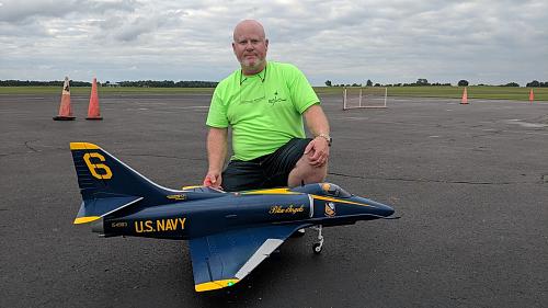

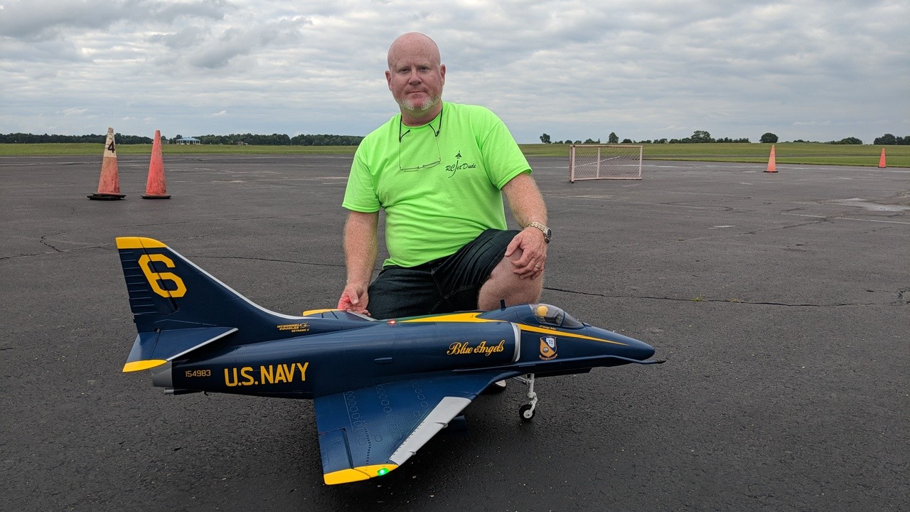

    Thanks Hardway!:). Someone recorded my landing:
    Shots from NEFI. The one is with Dan Grossman's Bearcat Blue Angel.

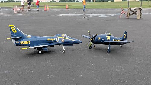

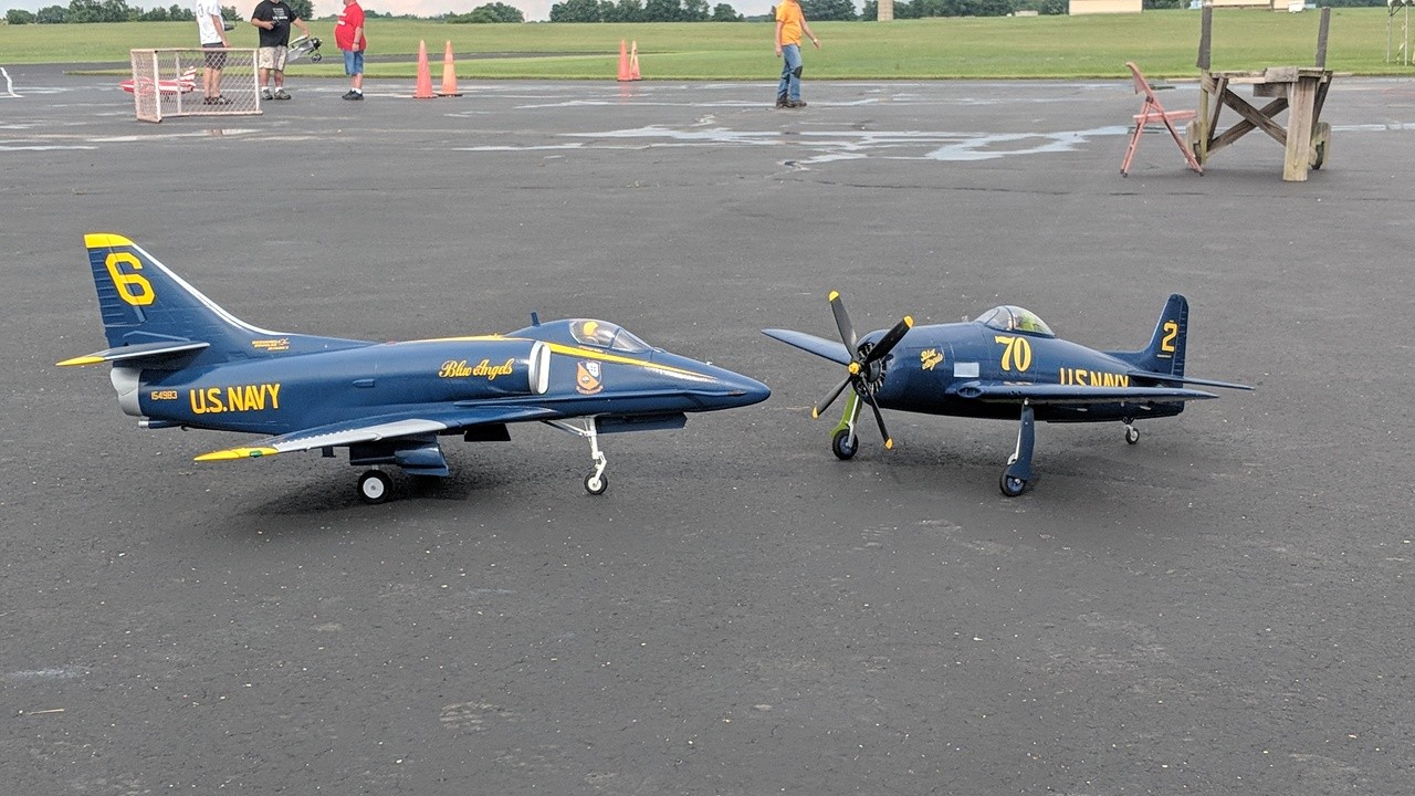

  • Ted7rns
    Wow, what a great little jet. We have 5 flights with the A-4, hope to have more and add a 3rd and 4th jet to the formation.

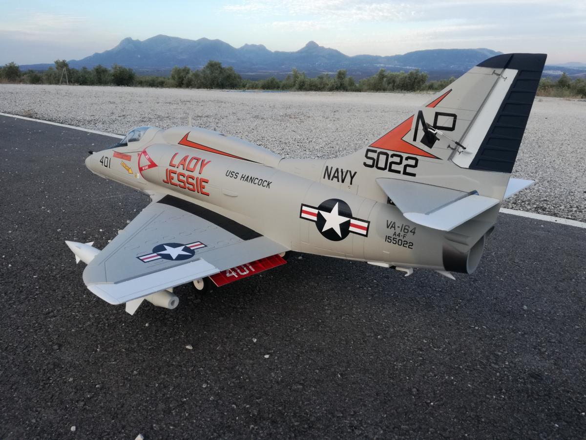

    Hmm you are right..much better to use a high end 80mm unit. Thanks for you input. I just purchased the A-4 a couple of days ago from Motionrc EU.. its great to have you in EU now. Look forward to mounting it! Graphics from Callie :).
    Welcome to the Squawk Pet! Glad you are here bro!
  • Petronio
