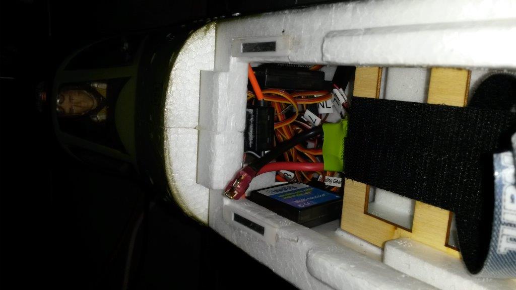

          Here's a photo of mine from last spring. Since then, i've add a telemetry module.
          But to answer your question. I have the light control and gear control on the sides of the fuselage, and my receiver attached to the upper inside of the fuselage.

                     Hi Pilots It's funny to hear everyone comment on the wiring mess in this plane, to put it mildly its a mess I installed the sequencer and light controller on top of each other and placed on left side  of the wing. After carefully placing the wiring in some kind of matter it's still a mess. I was able to install an AR-636 stabilizer in it,I placed under the lip of the cockpit and have no issues.  But I also have the issue with the gear and wing I have to replace the whole thing, seems to me the wing needs some reinforcing to help this problem the landing gear is an issue even if you grease a landing your never quite sure if the gear survived. I will be reinforcing the wing with carbon rods hopefully this will solve the problem.  I love this plane its too bad the gear and wing have issues, its too bad it's not as reliable as the FMS T-28 because the gear is basically the same set up but the T-28 just keeps on trucking.

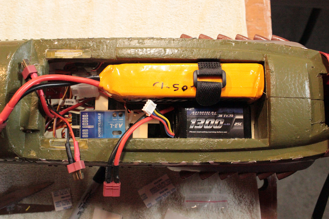

              I have the light controller and the L/G sequencer side by side at the most forward position on the wing. On top of the Starboard box (can't remember which one it is) I have the A3L mounted. I have the receiver mounted on the port side wall just aft of the battery board.
              So what I'm thinking is to try and mount the light and gear boxes to the fuse and hopefully eliminate the problem of short cables when trying to pull the wing.  I could use cable extensions, but then that's just adding to the mess.  I'm really surprised that no one in the industry have posted anything regarding this.  Sounds like a good vid for Captain Mike and Pilot Ryan.

                No, this one flies well without a GYRO.  I have the sound system; therefore things are a little tight in the fuse.

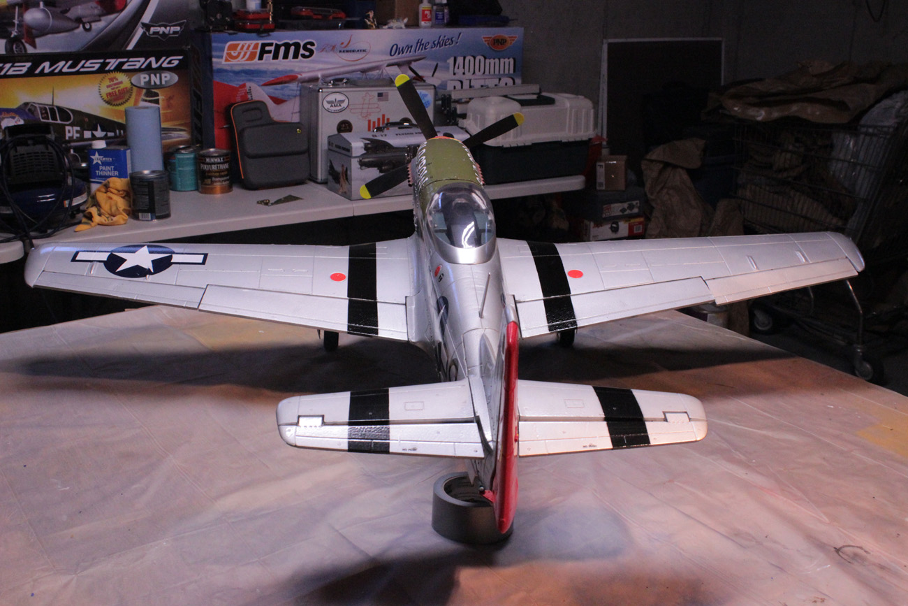

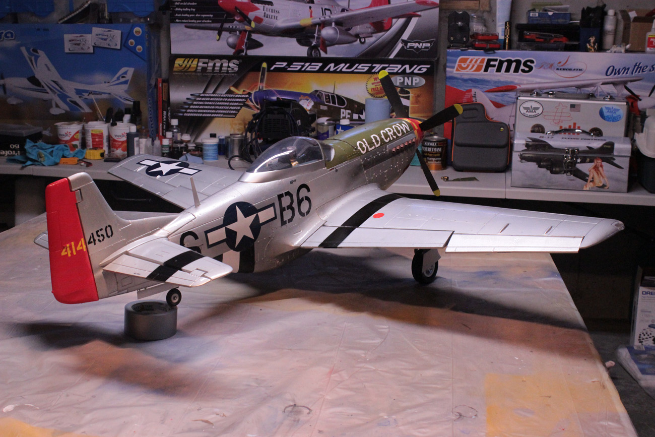

                    Hey guys, well the rebuild is going well, got the invasion stripes painted on the new wings, new retracts and servos all installed and checked out.  One thing of interest if you replace your wings is that the lower insignia comes separate as it covers the aileron servo, its a water slide decal, so your best to map out the position and cut the hole for the servo arm before hand.
                    Anyways, the paint went on without a hitch, its curious how well paint sticks to the original surface of this particular plane, barely any lift off, such a pleasure to paint.
                    So the age old question of where to place the L/G and light control boxes.  The problem is that unless you want to add extensions to the wires, the wing is simply a b.....h to get on and off.  As I mentioned elsewhere, I did find a home for the gyro
                    Looks as if it will work fine.  So now I have to figure out the most convenient place for the rest of the boxes, hmmm, today's challenge.

                        According to the manual, they want them on the side of the fuselage, in the cockpit area.  Works fine for the L/G box but the sound system is on the other side.  Ended up having to use extensions for the ailerons as the plugs barely stick out of the wing, a silly three inches longer would have been nice, but oh well.
                        The simplest solution I found was to invert the fuselage, and the stand the wing up on its leading edge in the forward side of the bay, then connect the remaining wires, then lay it down in place, sliding the trailing edge in and working it into place.  Ended up putting the light box on the forward part of the center section of the wing as I did before.  This should allow me access to the inside of the fuselage should I ever have to get in there again, I really hope I don't!!
                        She's such a cool looking plane, a real miniature P51D in looks, photos really don't do her credit!
                        I tried the Varathane water based clear coat for a change as Doc loves it, it really does do a nice job, I think he's right about it being better than Minwax, thanks Doc!

                          Beautiful job Gman!
                          Roy B.
                            • 7430
                            #73
                            RE: Freewing P-51 Mustang
                            Thanks Roy, now I just have to get the gun smoke stains back on her and the nomenclature.  Calli Graphics has a great set of nomenclature decals if anyone is interested.
                            Thankfully, everything worked the first time, so I didn't have to pull the wing off again.  The Varathane is very nice, I see what Doc was talking about, if you like Minwax, you'll love the Varathane.
                            Hey Lon, help an old guy out, what is a telemetry module, is it like a gyro?
                            I see where you mounted your L/G box, thats right where the sound module goes in mine.
