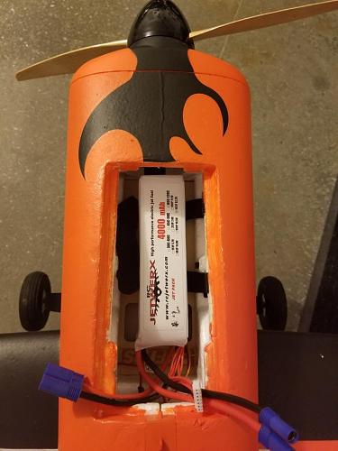

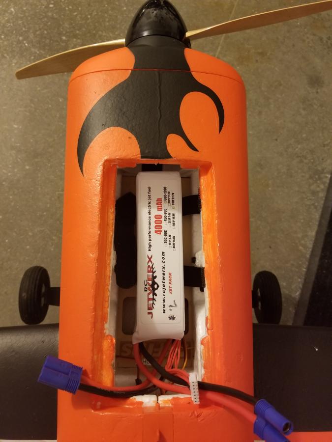

                        I have a very serious question regarding the FMS Votec 322... Today, my friend tried to maiden his and it didn't go well, due to a CG issue... We set the CG using the Great Planes CG meter at 120mm back from the leading edge of the wing per the manual, and it balanced perfectly with 56g of weight added to the internal area of the plastic motor mount with a Hyperion G8 6s 3300 battery that weights 399 grams (which is VERY light for a 6s). I saw one person was using a Zippy 6S compact 4500 pack which weighs 725 grams in this aircraft. Maybe he should sell the super light ones and buy heavier packs that weigh around 700+grams? When he attempted to take-off today, the CG was very tail heavy, and he saved total destruction by aborting a takeoff...
                        We checked the plane again on the CG meter, and he thinks that the center of lift is actually 40mm forward of the 120mm (manual suggested CG) making the accurate CG possibly around 80mm? If that is the case (and I didn't see anyone on here mentioning CG issues with this aircraft??), we measured with the plane on the Great Planes CG meter that it would take around 1,200 grams to balance the aircraft with the battery in the most forward position. However, this seems very strange to me (due to the amount of weight needed and he made no modifications to the aircraft), so I wanted to reach out for some help with this please from some actual FMS Votec 322 owners? He is dying to actually get it into the air, but it is grounded until we hear back from you... Thanks again guys!

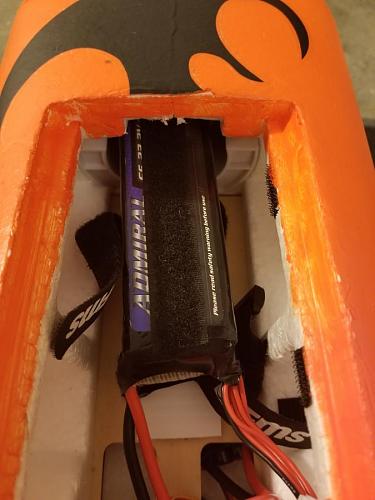

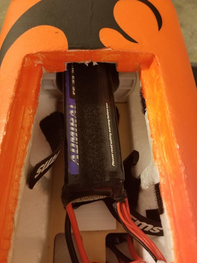

                          The Admiral 3300mah 6s i use are about 490g and about 740g on the 5000mah . The past few flights i've been using a 4000mah Jetwerx 50c that's 550g . I really don't find this plane CG sensitive and have no added weight at all .

                            Thank you very much Hemidoo... Can you or any other Votec owners please confirm that you are using the 120mm factory CG setting with your batteries all the way forward? I guess our idea to move the CG to 80mm is not the right idea... Thanks again!

                                Hemidoo, thanks again you're the best! So you are pushing the battery all the way forward and have it over the hard plastic part on the back of the motor mount pushed as close to the motor's rear as you can get it? We were stopping the battery right at the end of the balsa area prior to the plastic firewall section. Thanks again for checking the CG mm you have it set at, including which battery (and its weight). We used the manual and set it at the average which is 120mm and we used a 399 gram pack and added about 50 grams of weight to the inside of the firewall section. Thanks again Hemidoo, once we hear back from you we should be able to try the maiden again on Thursday.

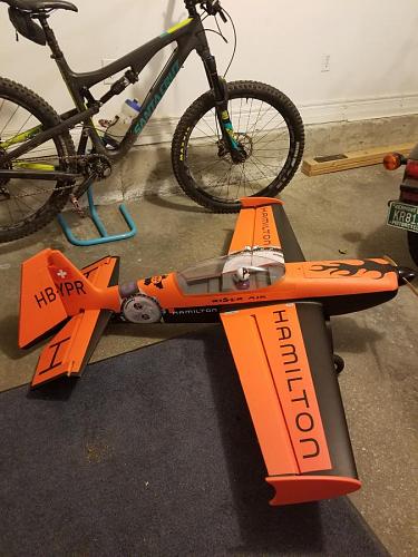

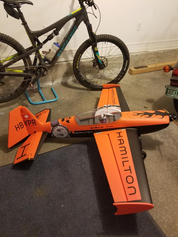

                                  Hi Vegas
                                  after checking the CG , with the 3300 its really close to 120mm battery weight of 490g. And yes its tucked all the way up the plastic mount.. Click image for larger version

                                  With the 4000 it's 120mm with myplacement, 550g battery

                                    Hemidoo, thank you so very much for taking the time to help a couple of rookies.... This is the exact information and pics we needed so he can actually get it to fly! You didn't have to do this but you did because you are a GREAT PERSON!!! You are beyond kind and thoughtful thanks again Hemidoo and may all your flights be blessed!!!!

                                          Sorry for the delay... We took it out and it flew VERY well he did some sport flying and all was well. Until the landing... He did several passes and it was about 10-15' off the runway and then he was at 5:40 and needed to get her down before the battery died (3300). He brought her in hard (straight down) and it crumpled the landing gear and ripped the landing gear foam area and gear right out of the plane. He ordered a new fuse from Motion that will be here tomorrow. We will rebuild her tomorrow... He was very upset but is staying with it but he will have to get the landings down on the paved runway.
