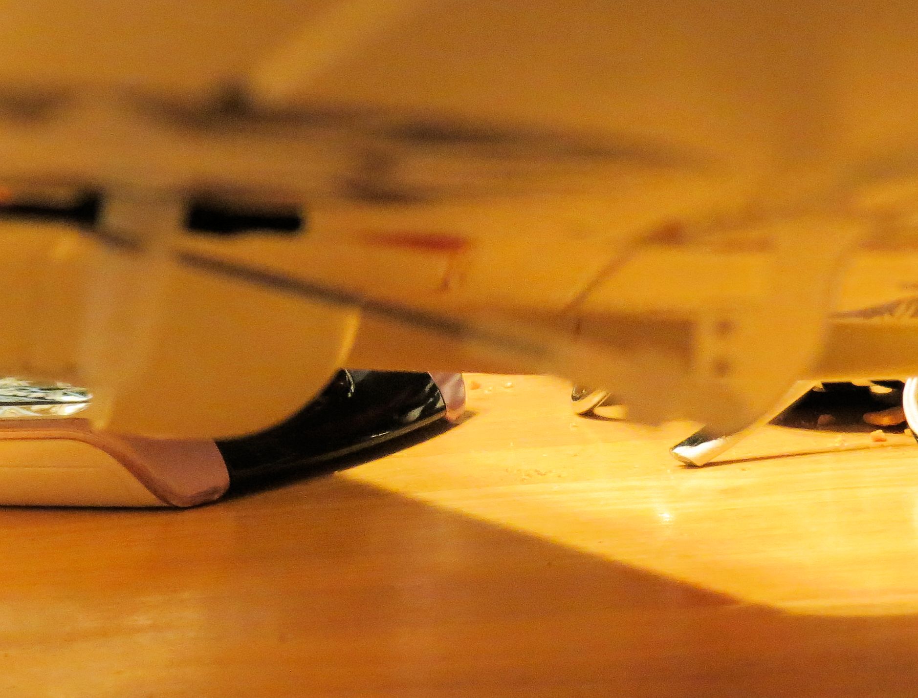

        Correct me if I am wrong but; rc planes should have right and down thrust (motor should be cocked a bit right and down), also moving the clevis toward the flight surface on the control horn will give you more throw, you want to move the clevis away from the flight surface to the furthest hole away from Aileron, rudder, and elevator for less throw.
        Setting up your control rod the way that is pictured here will give you the least amount of throw.
        If I am wrong please correct me, but this is what I believe is correct.

          Sean,
          What you stated about the control horns is correct, but the note from MRC stated to move the rods to the inner holes on the SERVO ARM. That would have the same type of dampening effect as moving a clevis to the outer holes on the control horn. But wait, I see they also mention moving the clevis closer to the control surface! They ARE wrong, and you are right! Also, I don't think they worded their response very well about the engine thrust, but I believe they were just referring to the tendency of the plane's torque to pull it to the left and why the pilot needs to be giving right rudder. Warbirds are notorious for a hard left turn on take off, but the slower and easier you go, the less the impact of that torque pull. I'm always ready with plenty of right rudder right as the wheels leave the ground.
          Hope you get your parts soon and back up in the air with more success! Keep us posted!
