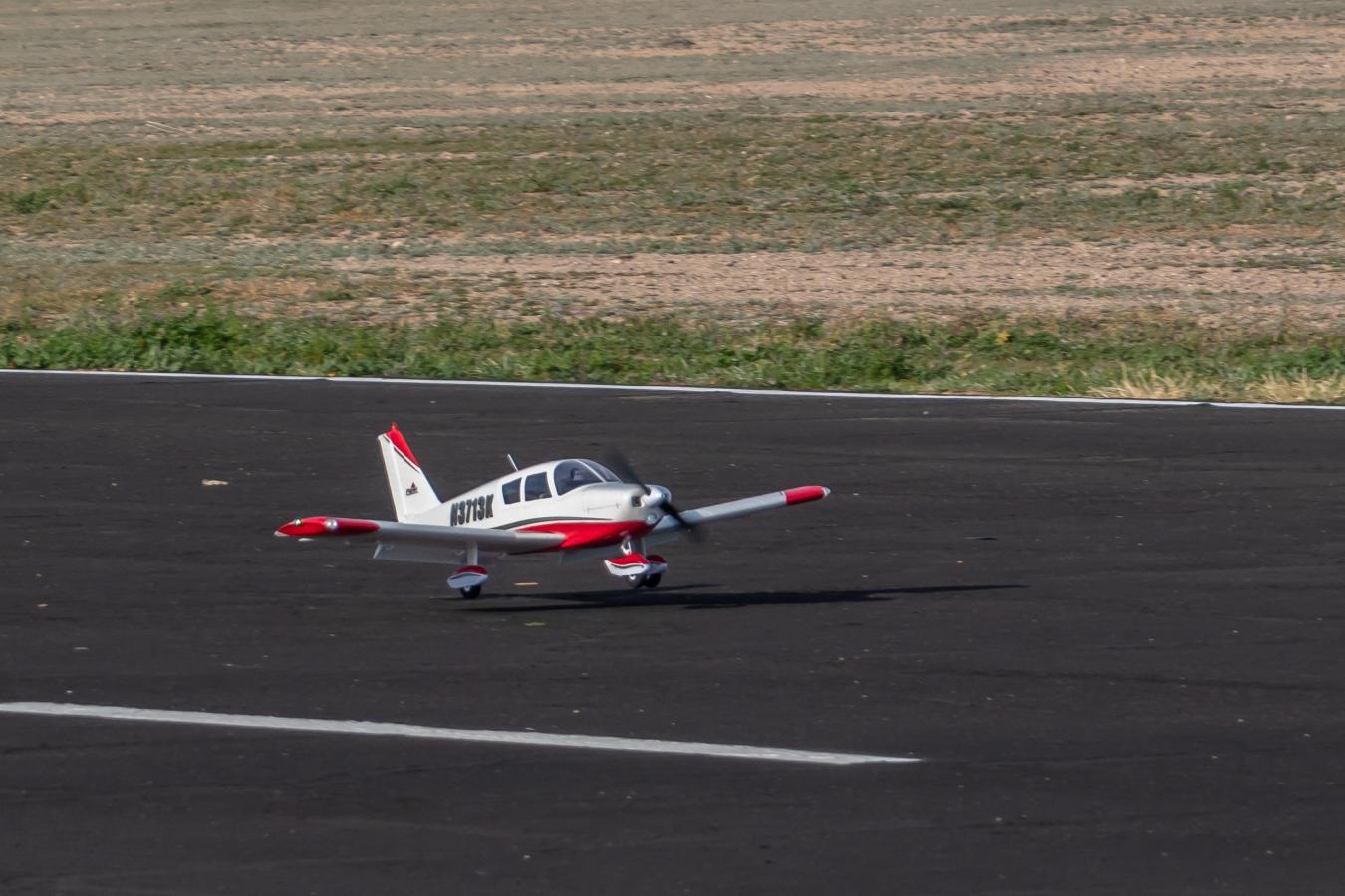

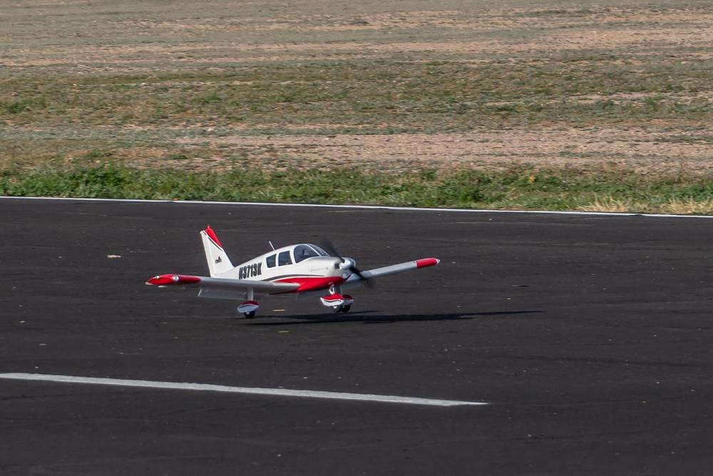

Slick landing shot!
Not a pothole or gopher hole in sight, lucky goose.Live Q&A every Tuesday and Friday at 9pm EST on my Twitch Livestream
Camp my Instagram @Alpha.MakesComment
You are absolutely correct, sirs! We used to have a grass infield - now it is just hard dirt and rocks. Kinda fun with the right airplane like a Carbon Cub or Timber. I actually have more landings in the dirt with the Ryan than on pavement.
Anyone visiting Phoenix will be welcome to fly with an AMA card, c’mon down!Comment
I see a paved runway as a double edge sword, while wonderful for the planes I do have, the paved runway would remove limitations on the planes I can buy. Having a grass runway helps keep me from buying EDF's or a lot of other planes.
The picture of the Cherokee touching down on the mains with the flaps down is just outstanding!Comment
