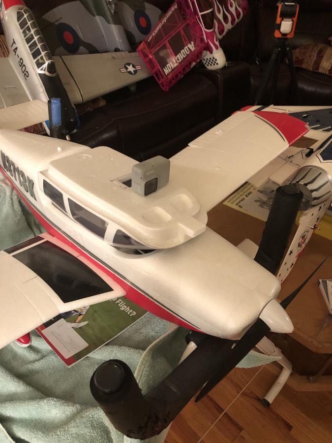

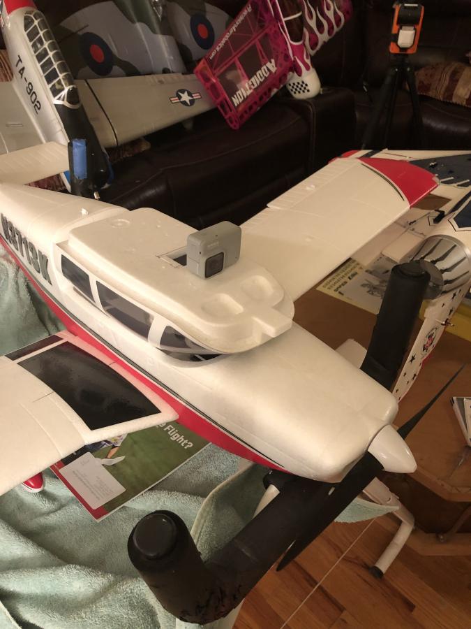

              I have been flying the crap out of mine for over a year even in strong winds of up to 30 mph Love practicing cross wind landings with this one. I just cut out a hole in the bottom of the Canopy to mount my Go Pro inside the cockpit and do video's hopefully the video's will look OK. seen this on another site and decided to do the same in his video you can see the instrument panel and the view is awesome in the video. I can not wait to try this out
              Click image for larger version  Name:	Cherokee.jpg Views:	0 Size:	76.8 KB ID:	221879
