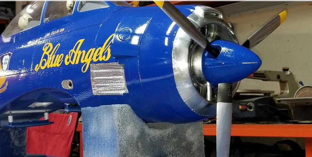

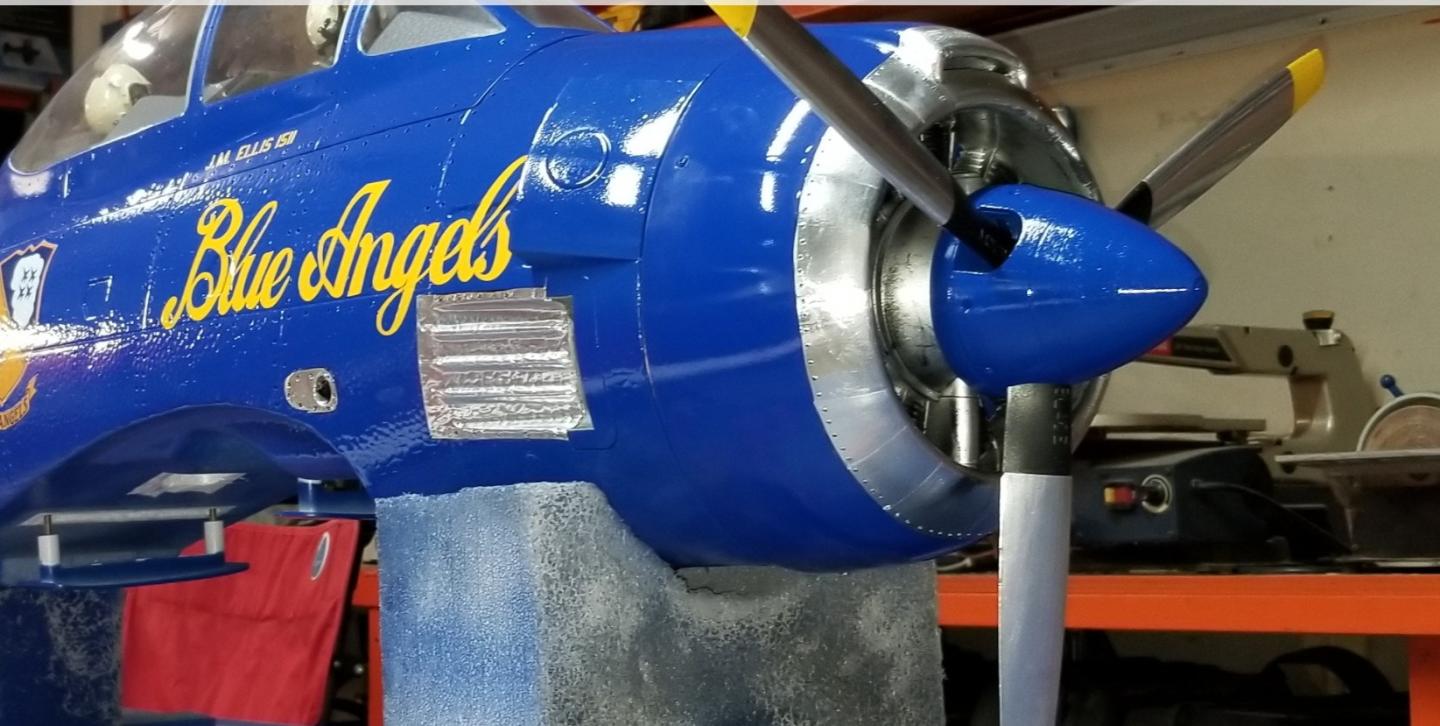

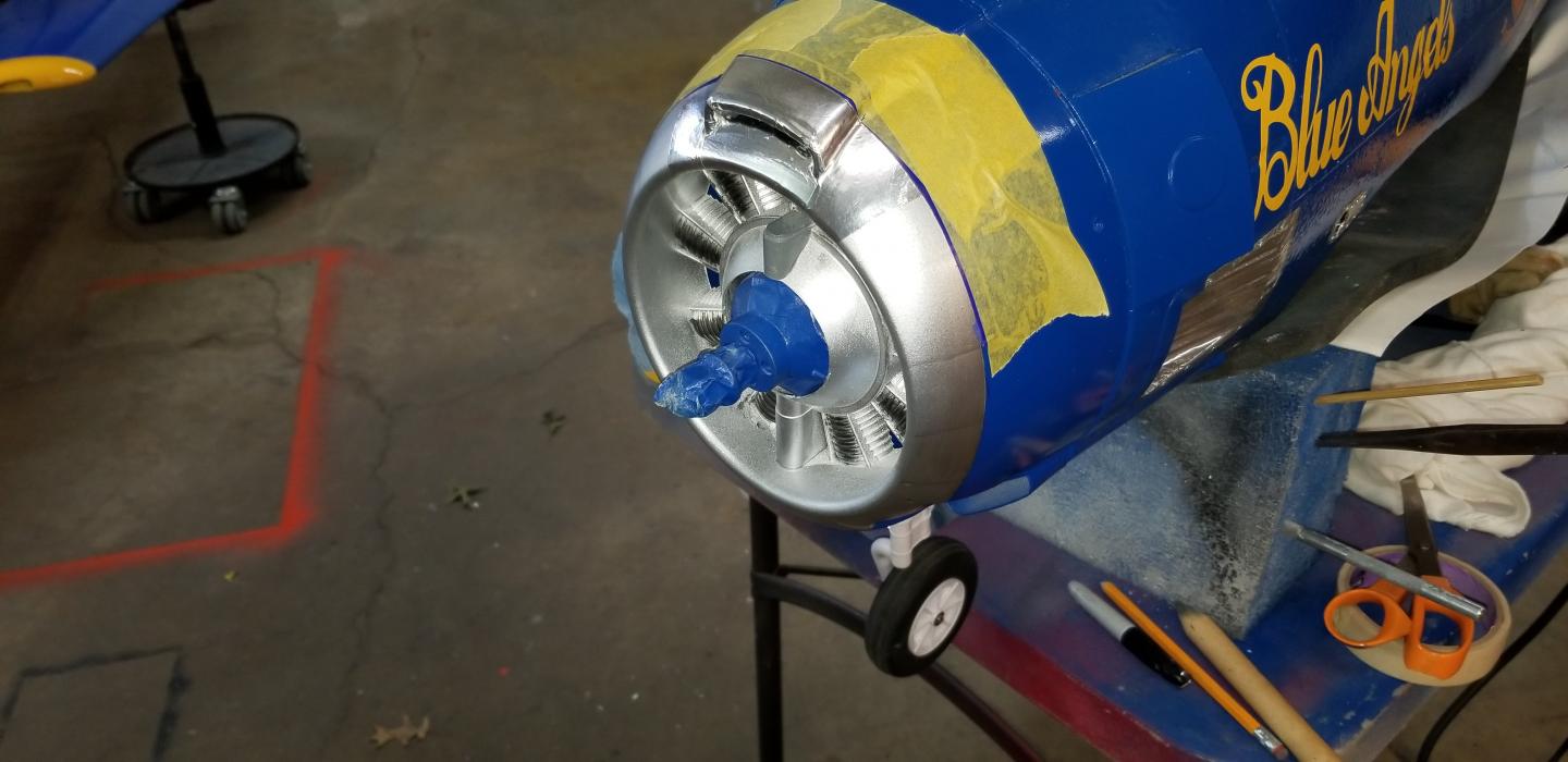

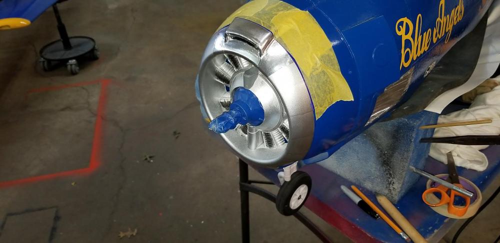

ID:	154973 I put the flight metal on in small pieces around the cowling.
    The tape is where I will cut it. The tape helps you see the line you have to cut on.

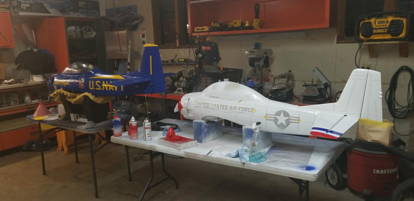

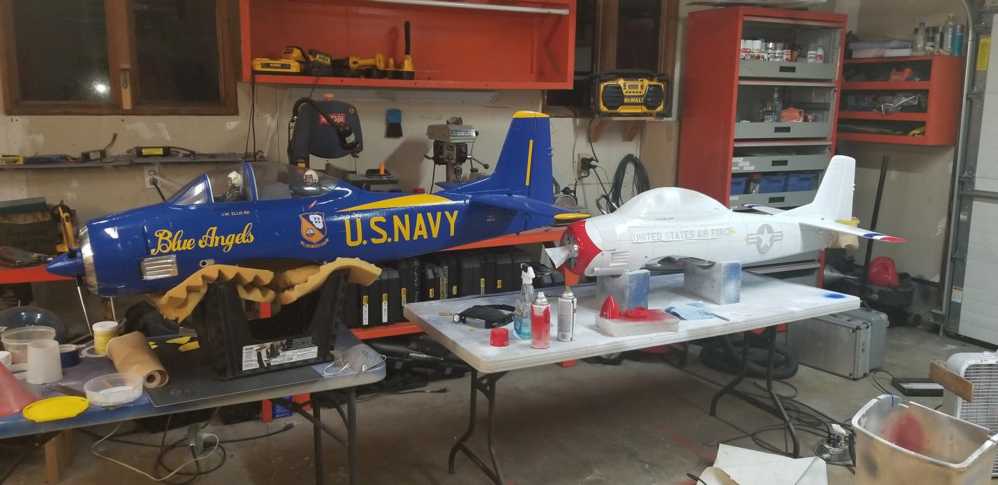

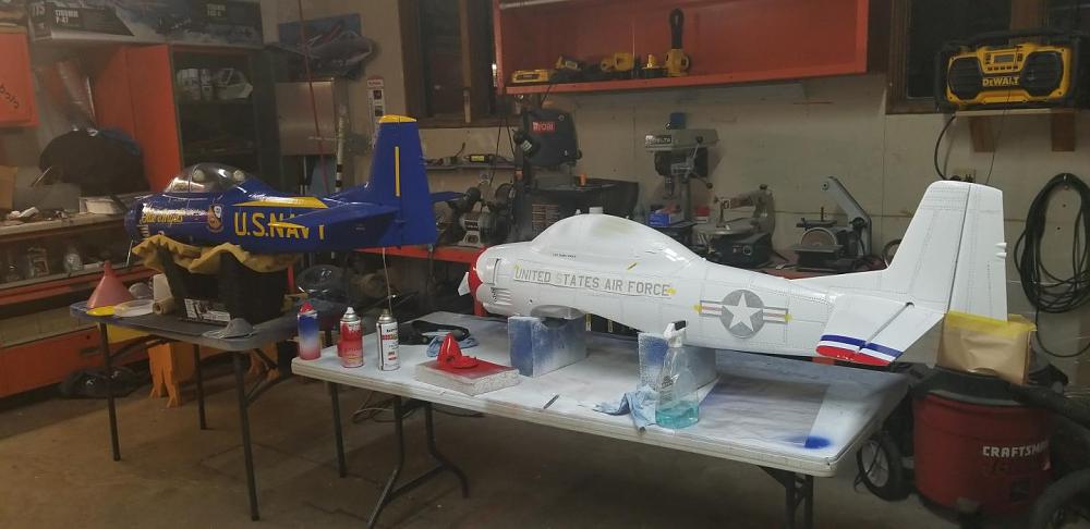

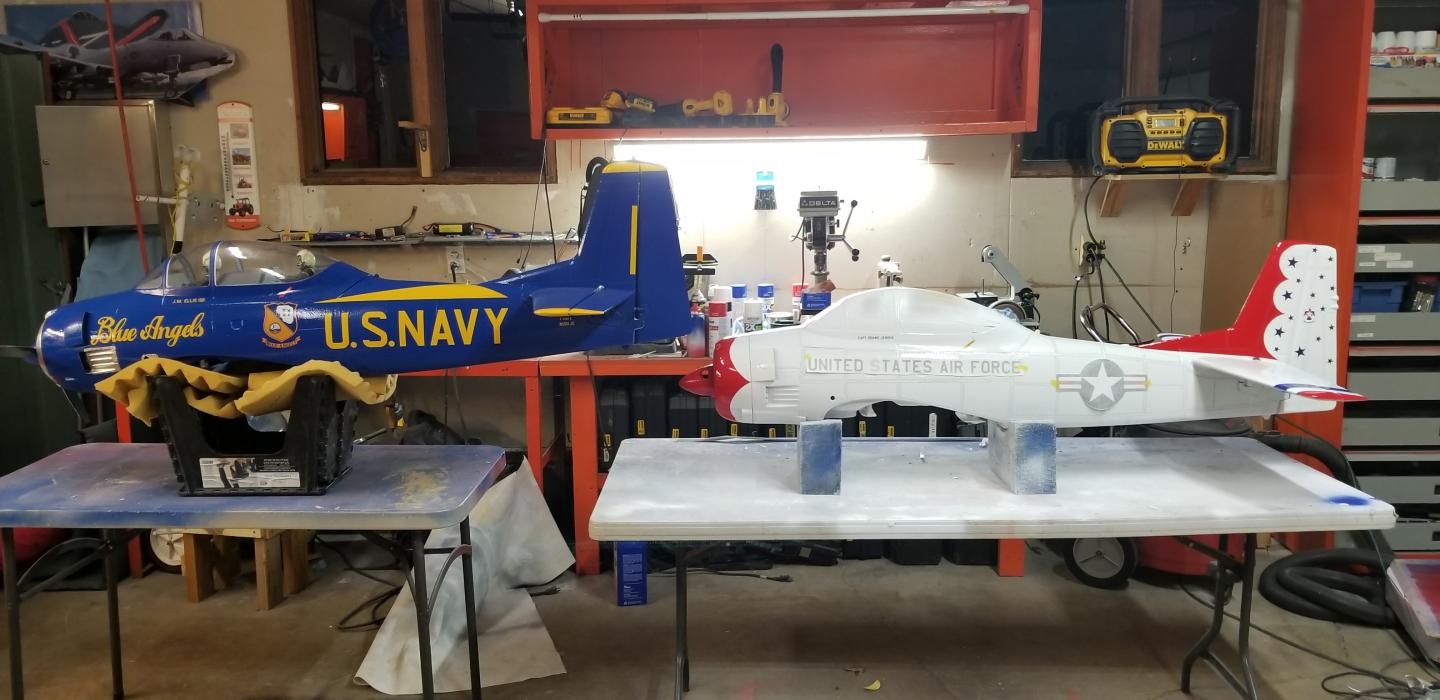

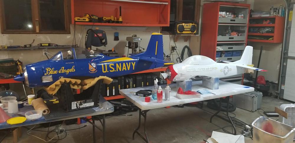

            Busy day in the shop
ID:	155320Click image for larger version  Name:	20181007_190208.jpg Views:	1 Size:	92.5 KB ID:	155318
            Click image for larger version  Name:	20181007_195444.jpg Views:	1 Size:	123.3 KB ID:	155317
            • BRGT350
              • Jun 2017
              • 211
              #66
              Those are going to make a great pair!

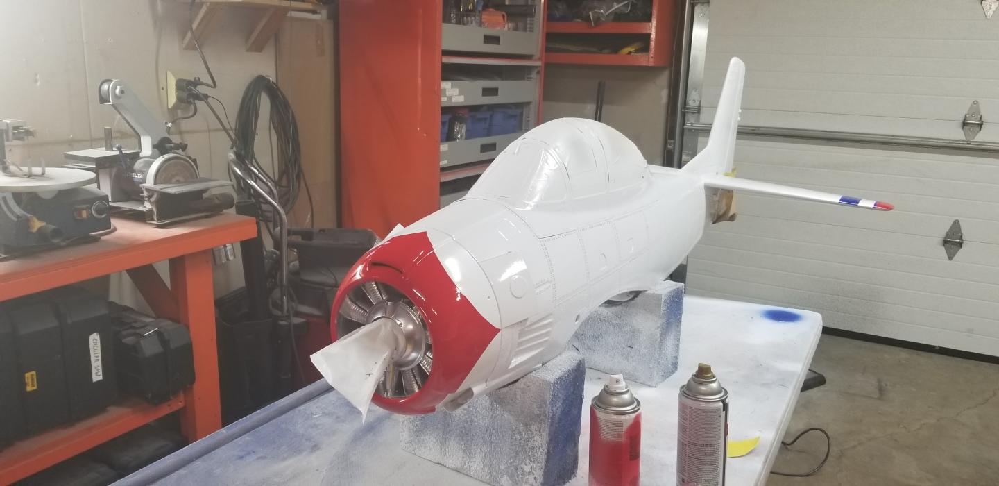

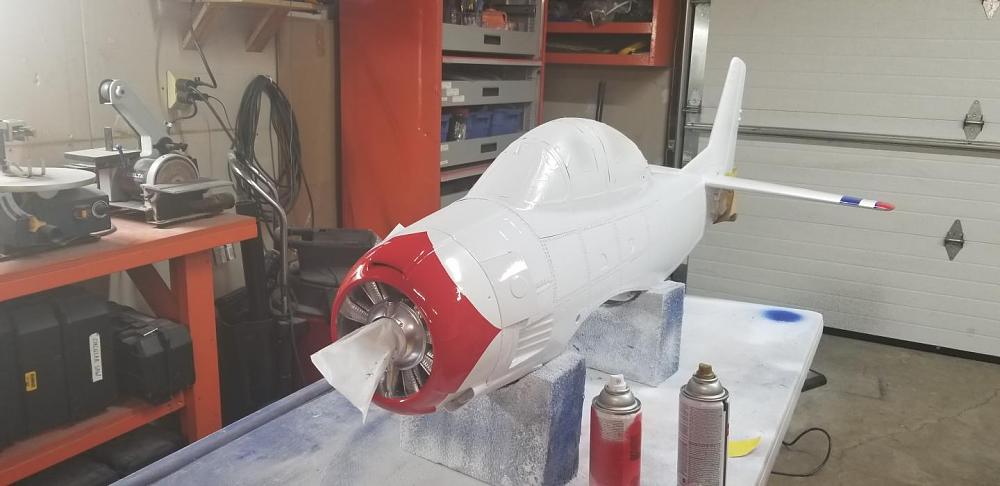

                My MOJO is working to night, so I wish I could call off sick to finish it. Click image for larger version

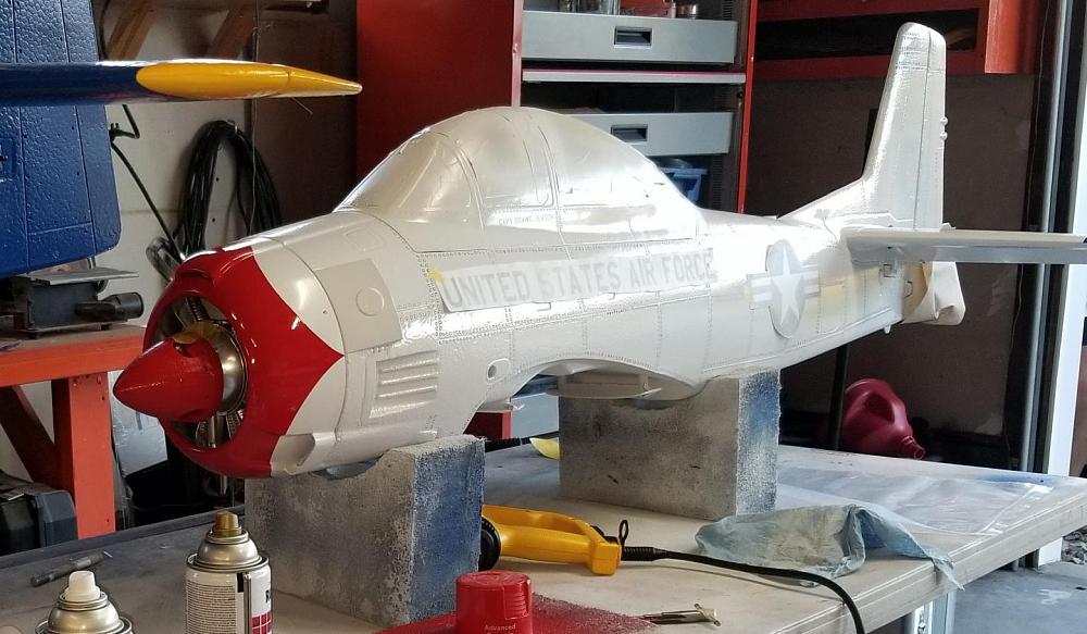

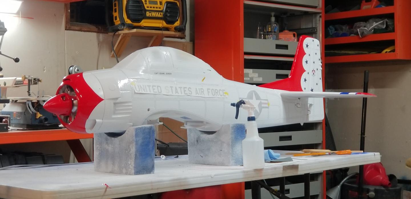

                    Time to go to bed, work is coming all to soon now. Click image for larger version

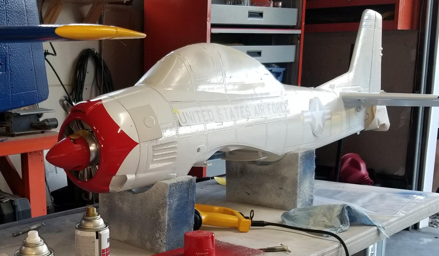

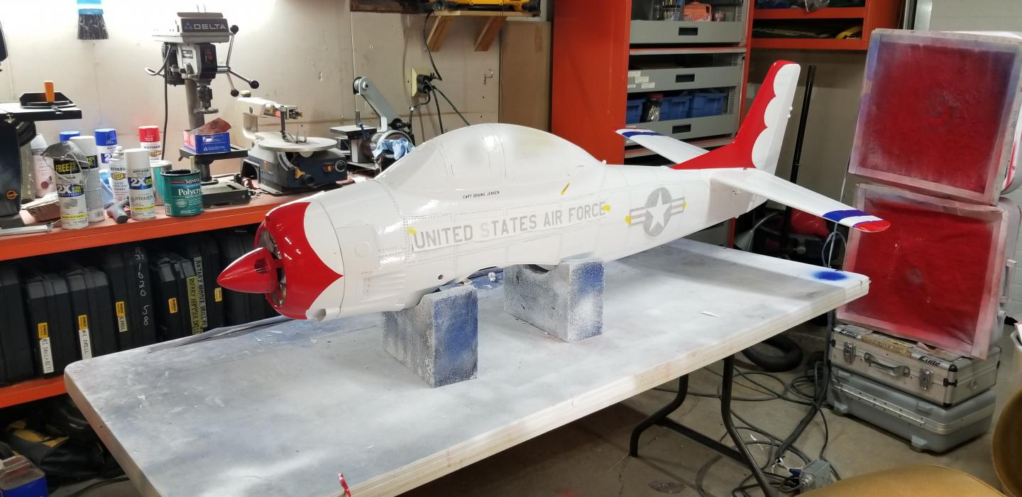

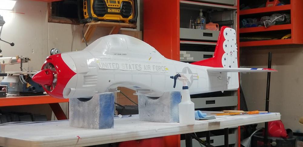

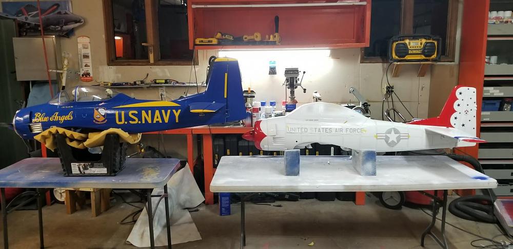

                        I really like where this white one is going! Curious if you weighed them before and after paint?
                        • t33jetman
                          • 515
                          #72
                          Sorry, no I did not weigh them before starting.
                          No primer coat this time.
                          Used the spray on Minwax and not the brush on Minwax.
                          Lots of wet sanding between coats.
                          Less paint sprayed on rear and bottom of the elevators, wings and the bottom of the plane ,lessons learned from the Blue Angels plane.
                          If you remember from my flight video of the Blue Angels, I didn't notice any performance difference in flight after painting, just the CG moved from my normal spot. Had to move the battery forward.

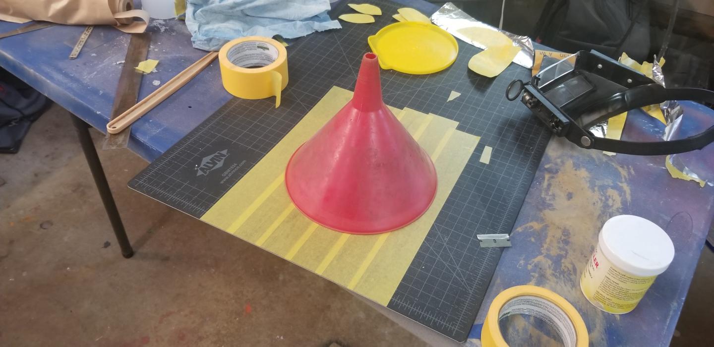

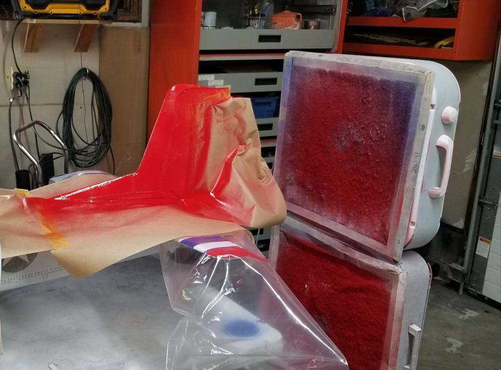

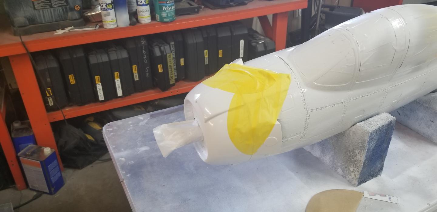

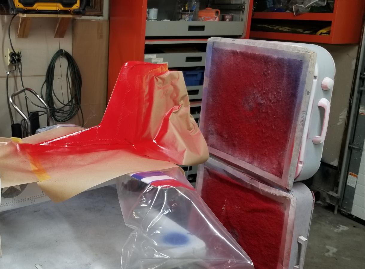

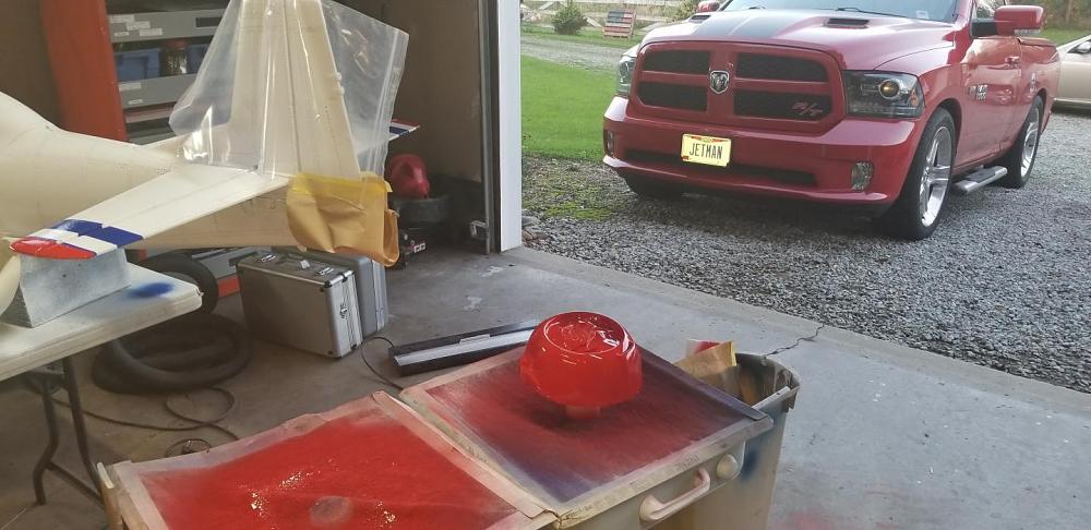

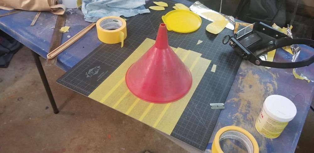

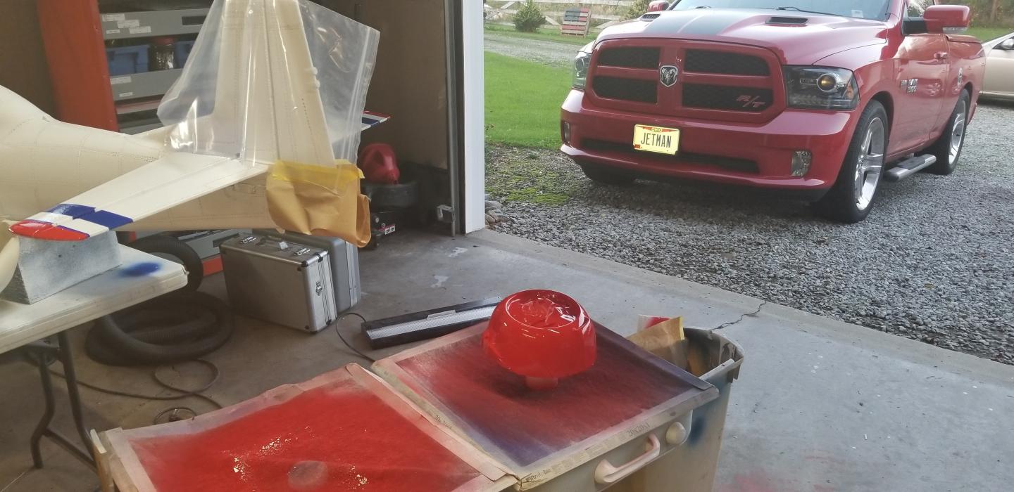

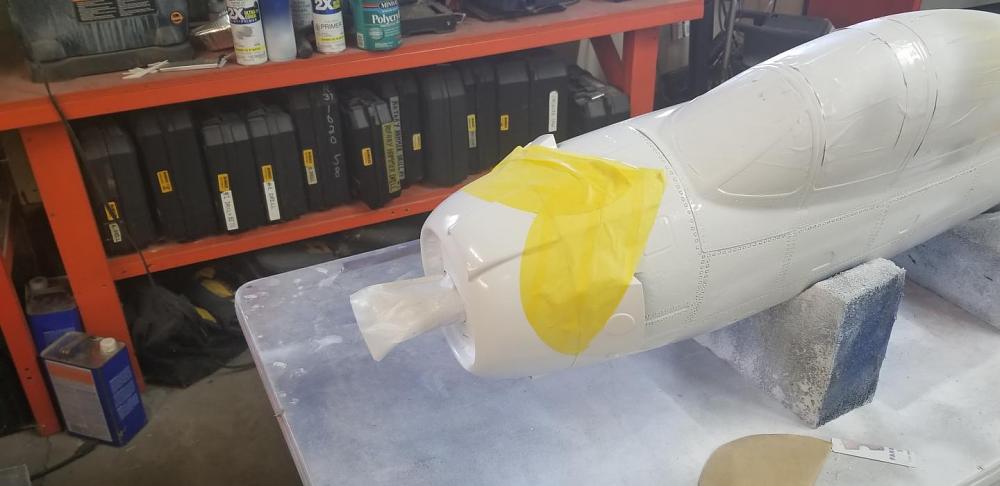

                            Made my own paint mask for the nose and rudder. Forgot to take pictures of rudder before the paint went on.
                            I really liked the down draft from the fan when paint the nose and elevators. That was so cool , that I'm gonna have to make a table with the fans pointing down in it.
                            Click image for larger version  Name:	20181007_125837.jpg Views:	1 Size:	112.1 KB ID:	155539Click image for larger version  Name:	20181007_125848.jpg Views:	1 Size:	84.9 KB ID:	155540Click image for larger version  Name:	20181007_184759.jpg Views:	1 Size:	134.0 KB ID:	155541

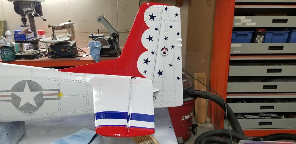

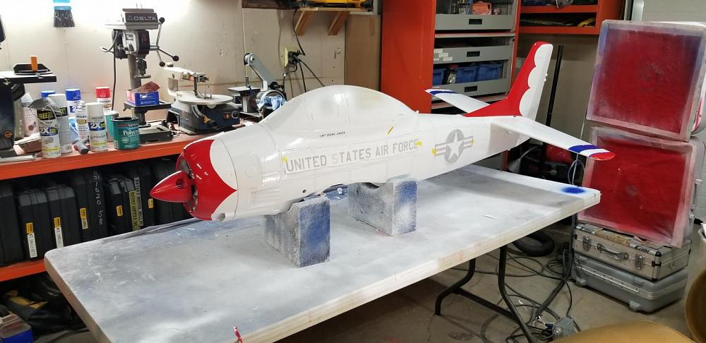

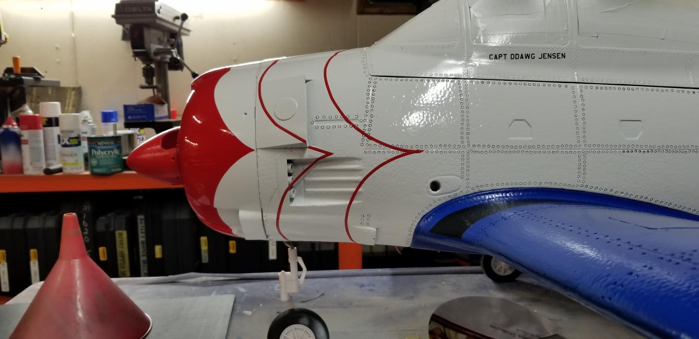

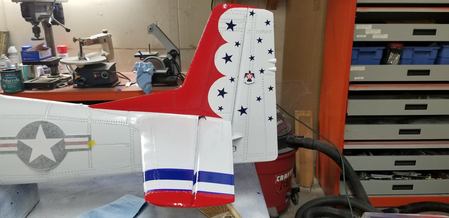

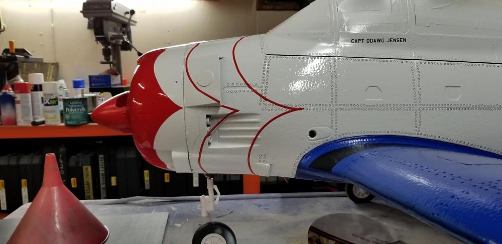

                                  This is the part I hate, and will take some masking skill not to bleed over. Click image for larger version

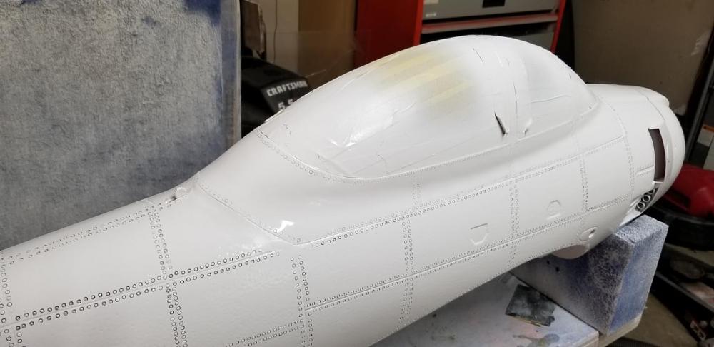

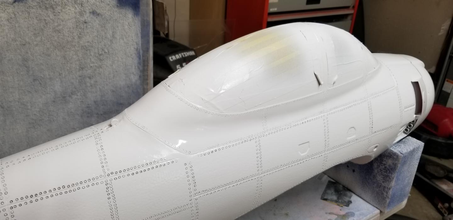

                                    How are you doing your rivets?
                                    • t33jetman
                                      • 515
                                      #78
                                      A brass tube clamped into my dremel tool.

                                        Try Clear low tack self paper ( I get it at Wally World ). That's how I masked my A-10
                                        Mike
                                        • t33jetman
                                          • 515
                                          #80
                                          Mike
                                          Thanks Mike , I will give that a try today.
                                          Hope this works , because it has slow down everything I'm doing .
                                          I just want to get to the detailing part soon, so I can see it all come together before the weather gets bad.
