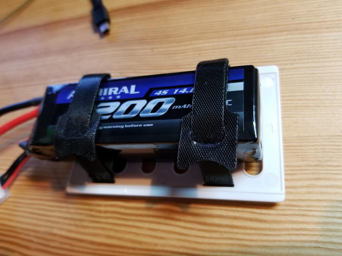

                                  #57
                                  Originally posted by CaptAmerica
                                  Ive heard on several YouTube videos on the set up saying CG should be between 70 and the 86mm. Most seem to favor the closer to the 70mm. I set my battery slightly forward on the tray but have never actually measured the CG.
                                  Down to painting the last bit on my and will get it reassembled. Want to get it back in the air before the snow flies.
                                  I flew mine twice this past Sunday and used the 70mm CG measurement and it was rock solid with an Admiral 22oo 4s. With the 70mm as the CG, your CG points line up with the 2 plastic nubs that attach the top wing to the cabane struts. There are slits in the battery tray and CG for me was the front of the battery lined up to just past the first slit (see attached picture). I had a lot of fun in the sky with this and 4s has crazy power. I found it best landing on the grass next to my paved runway though. I got bouncies on the pavement as you have to be perfect coming in. You have to land it like a delta where you want your nose up because she can be a handful on the ground.

                                    #58
                                    Looks pretty close to the 4s sweet spot I like for sure ! . The landing gear on this pitt is super rigid ... I'm sure that's what contributes to the landing bounce as well. I'm at 30 plus flights and I'm getting pretty smooth Landings now .
