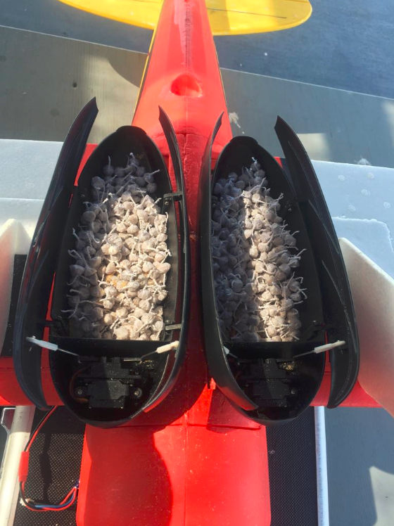

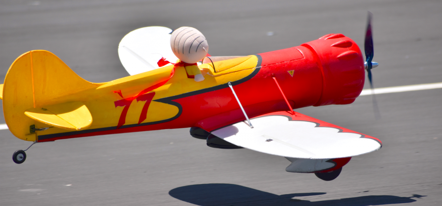

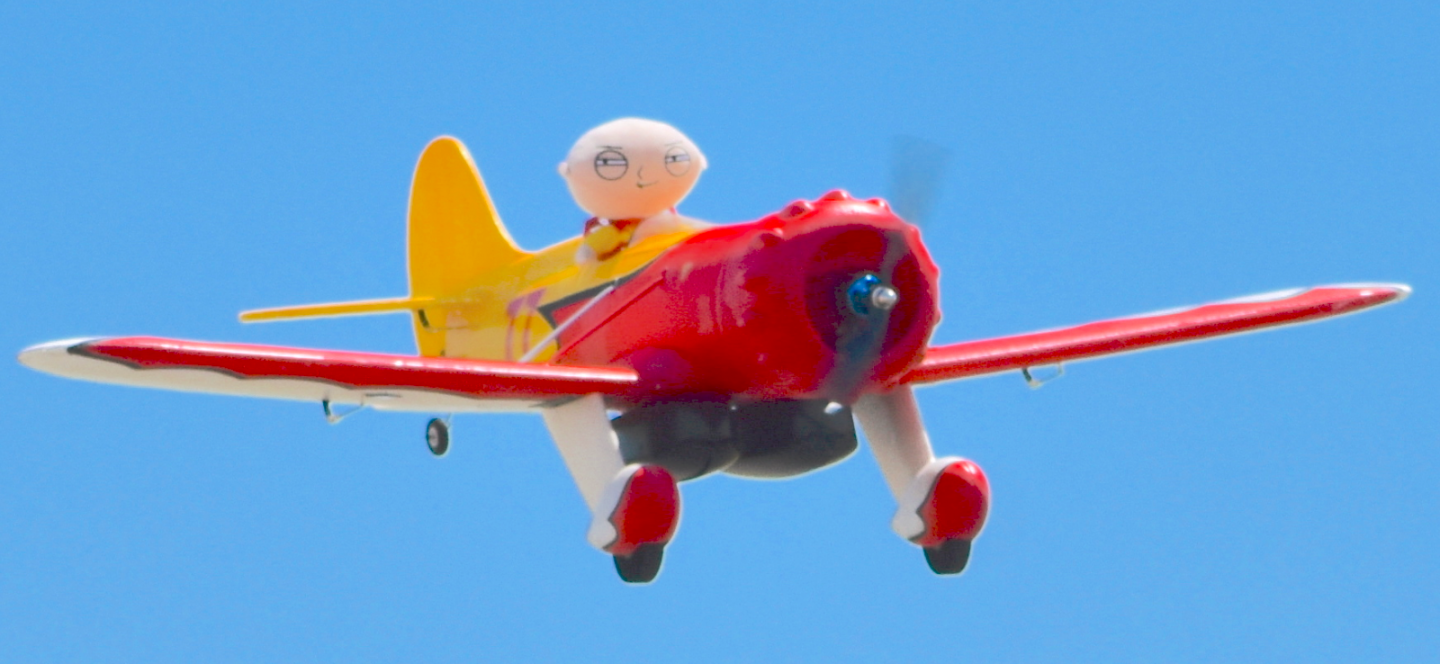

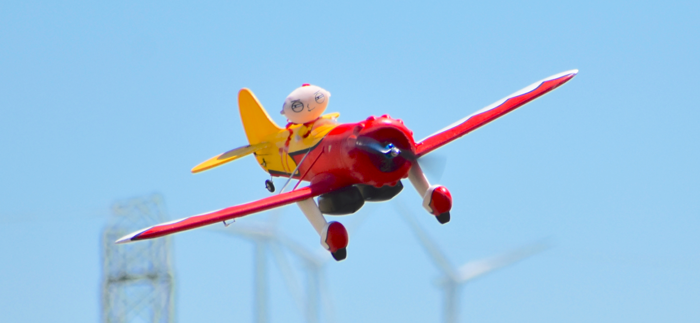

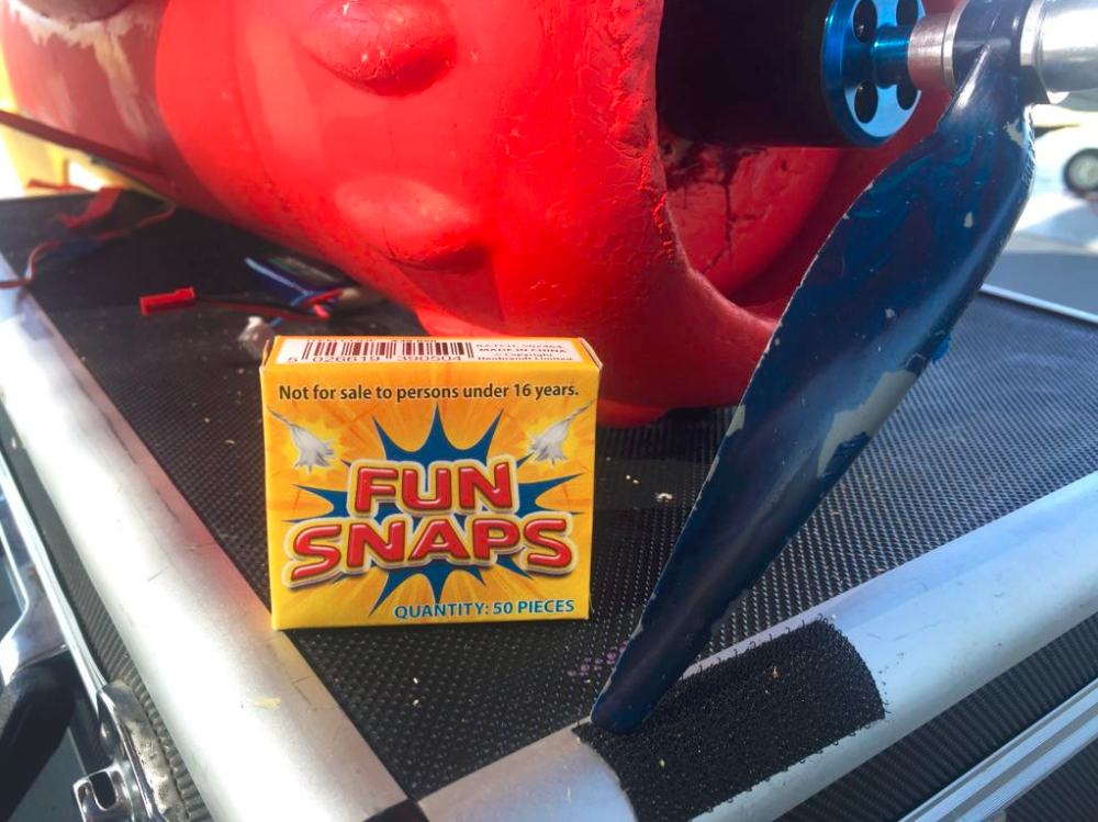

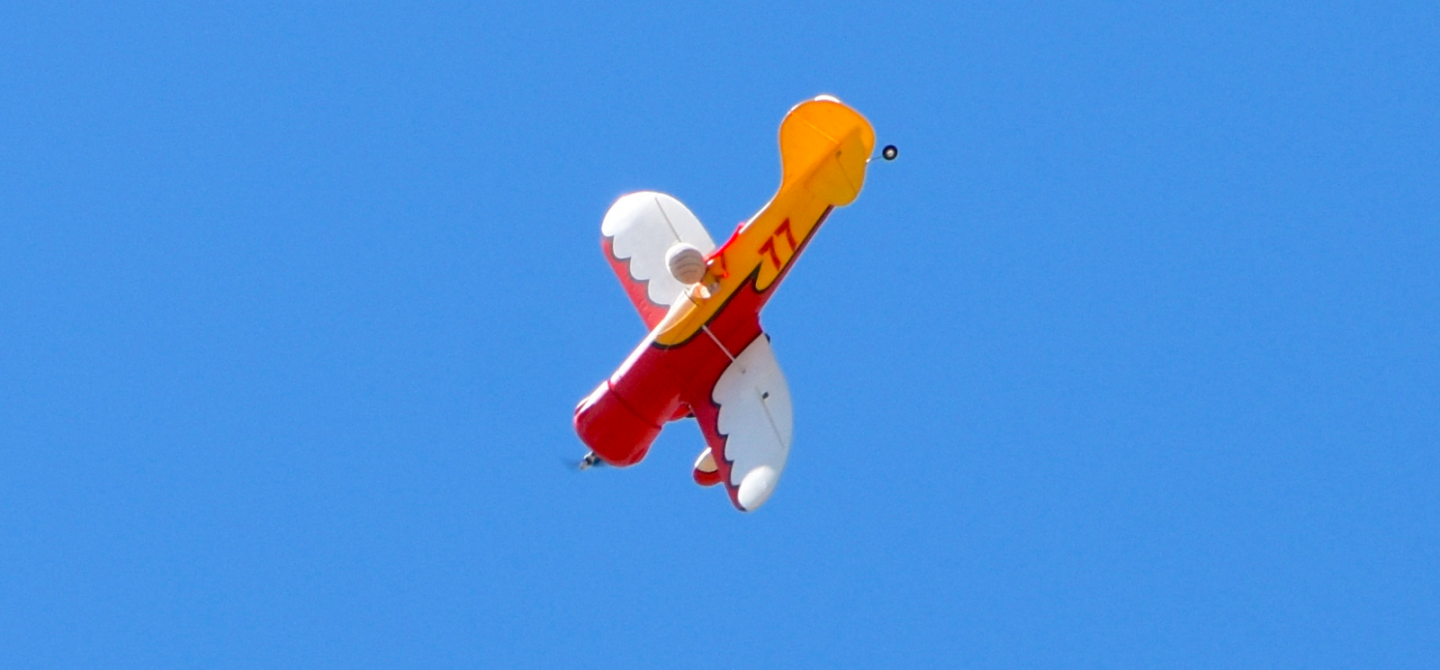

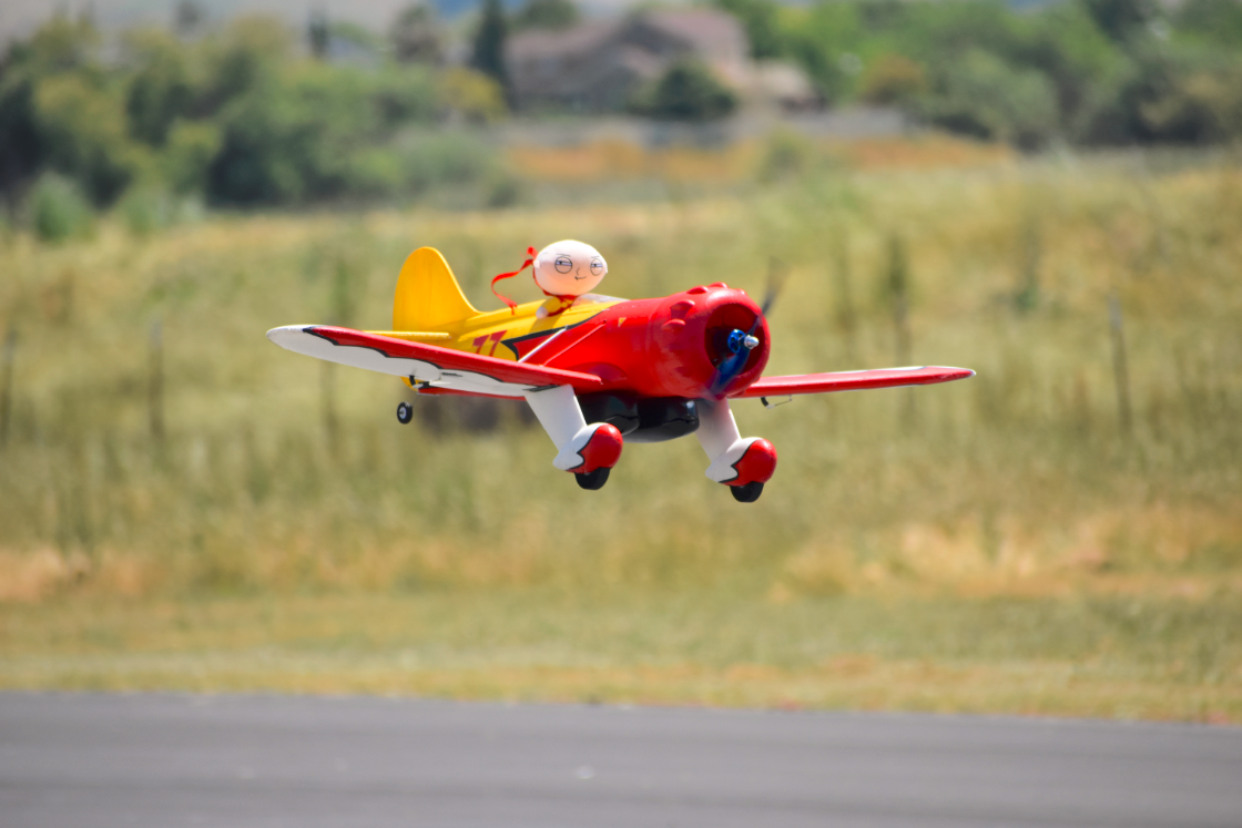

Dynam Gee Bee Dropping Bombs
Future modifications. Hook up each bomb bay compartment to its own Auxilliary port such that two bomb run passes can be made and also assign a switch to both auxiliary ports to mix the function for dual bomb drop release at the same time. 10 Channel Lemon RX, is currently out of stock at Motion RC. But the receiver and satellite combo can be purchased at Amazon.
Note the 10 channel Lemon RX will not be equipped with a stabilizer like the lemon 6 channel counterparts. I also recommend adding the dsmx satellite receiver in any case.

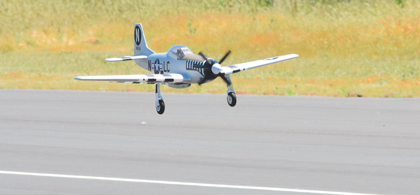

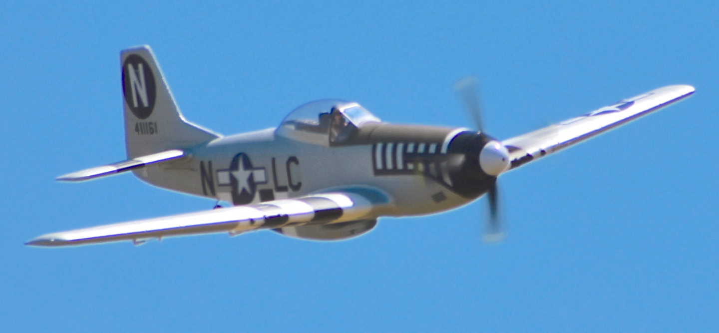

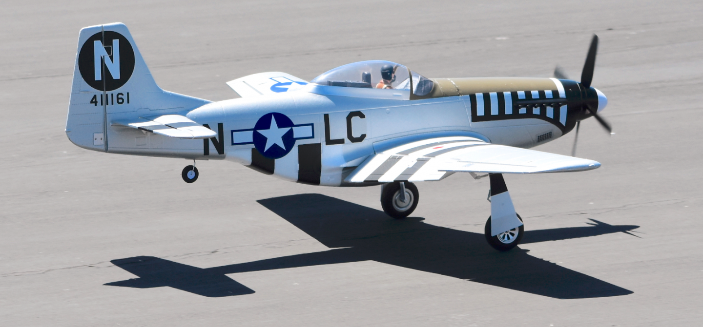

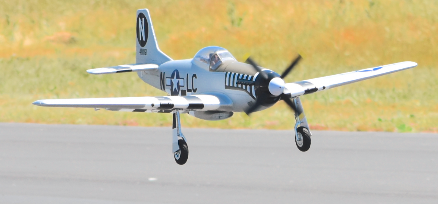

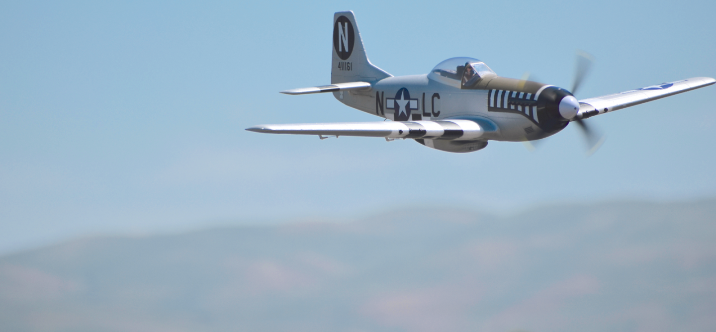

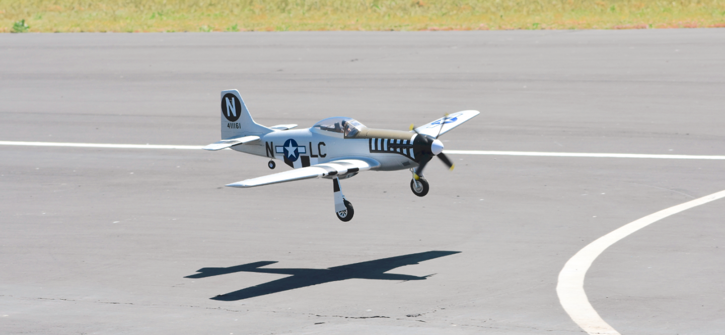

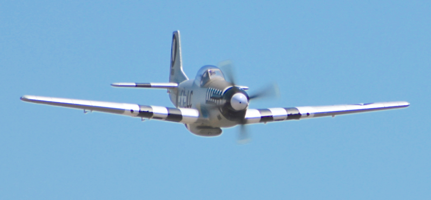

Modified EFL8950 E-flite P-51D 1200mm // 1050KV BL15 Eflite Outrunner // FMS/Eflite/RocHobby 10.5x8x4 prop
