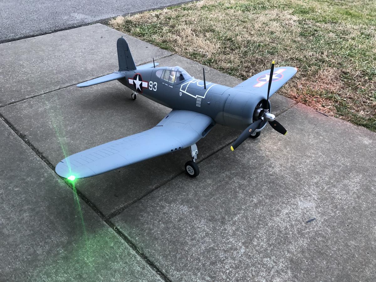

ID:	290222 Got 2 flights in before dark. Love this plane!!

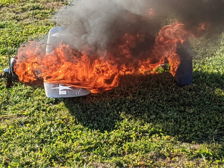

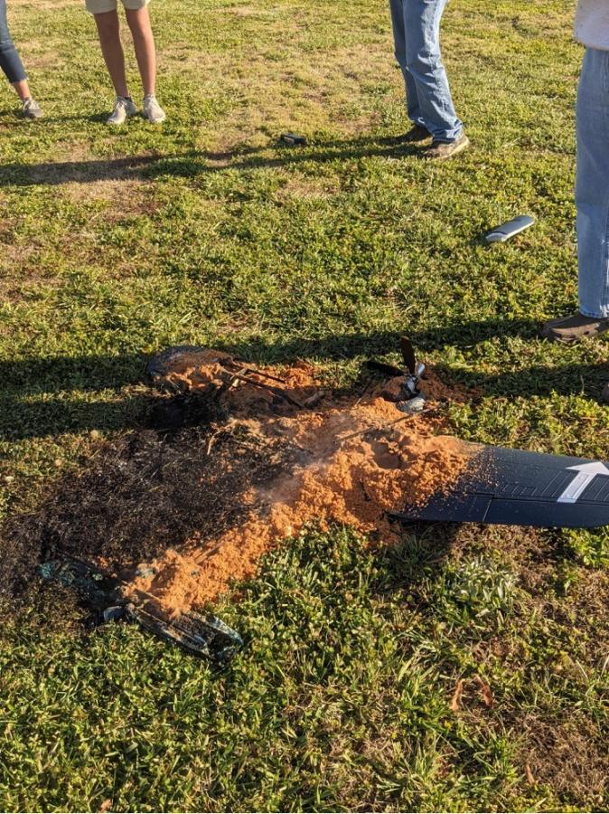

              • Death of a Corsair. Flight number 3 on my sons Corsair didn’t end so well. It took off, motor started making noises, a little smoke, and lost all power. It flopped in at the end of the runway and started to smoke. In a matter of a couple of seconds it was fully involved.
                I've been involved in the hobby for over forty years. I’ve never had an airplane catch fire let alone burn completely down.
                • Originally posted by John Bergsmith View Post
                  OMG, now that's a "scale" mishap! Looks like it got caught by a Zero while patrolling in "The Slot".
                  Seriously though, sorry to see that. The fire was most likely caused by a short or other breakdown in the ESC. I had a Castle ESC burst into flames in my 60" Beast Bi-Plane once, but it was cause by the idiot mechanic (wait a minute, that's me) that was prepping it for flight and plugged in the Sound card with the JST connector reversed so it was - to +. Got the fire put out quickly and only "fried' the ESC before the balsa or monocote caught fire. No other damage but it still smells a little "smoky" when I remove the battery hatch to put in a new battery. Kinda gives it the "smell" of realism.
                    Sounds familiar. Had a V1 Taft ViperJet. Taxied out to the runway and while doing my control checks, smoke started to emanate from the canopy seam. Ran over and yanked off the canopy, grabbed the battery connector and pulled it apart. It was the ESC smoking. Had I not been that fast, I'm sure it would have caught fire and looked just like that Corsair. Scorched the interior a fair bit but put in a bigger, better ESC and I continued to fly it for another season.
                      LOL, it looked very authentic for sure. Nothing left but carbon rods.

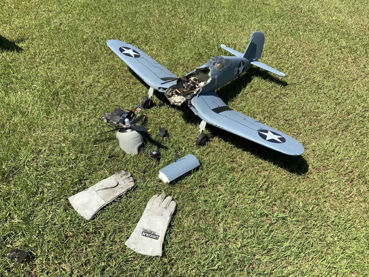

                      • Back in May my Corsair burned up after I compromised the battery casing. I guess I was a little ham fisted strapping the battery in and the metal buckle on the strap was at the corner edge of the battery. Within seconds of strapping in the battery battery it lit off and by the time it took me to run to my truck and back to get my welding gloves to yank everything out this is the damage.
                        last year on of our Pattern flyers was beginning his routine when his plane started smoking. By the time he got down and stopped his nice Pattern plane was pretty much toast. He had used a new method of securing his LiPos which had compromised the outer casing on both batteries and let the magic out.
