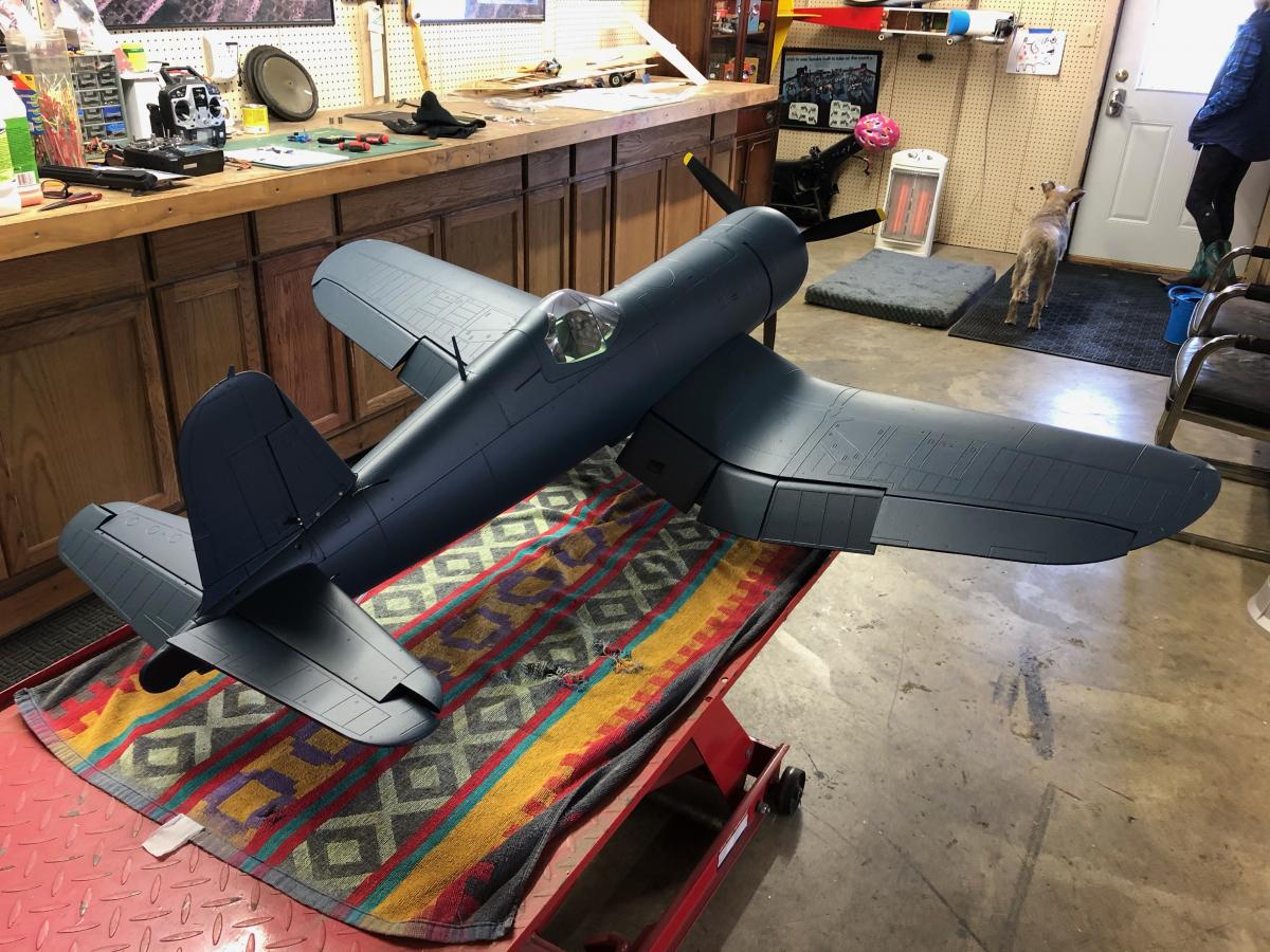

                                    Christmas was good to me this year! Bolted this together quickly, just to see how it looks. Can’t wait to fly it. I’ve been reading all of your posts in this thread, absorbing all of the wisdom!
                                      awesome!! Welcome to the Corsair family:)
