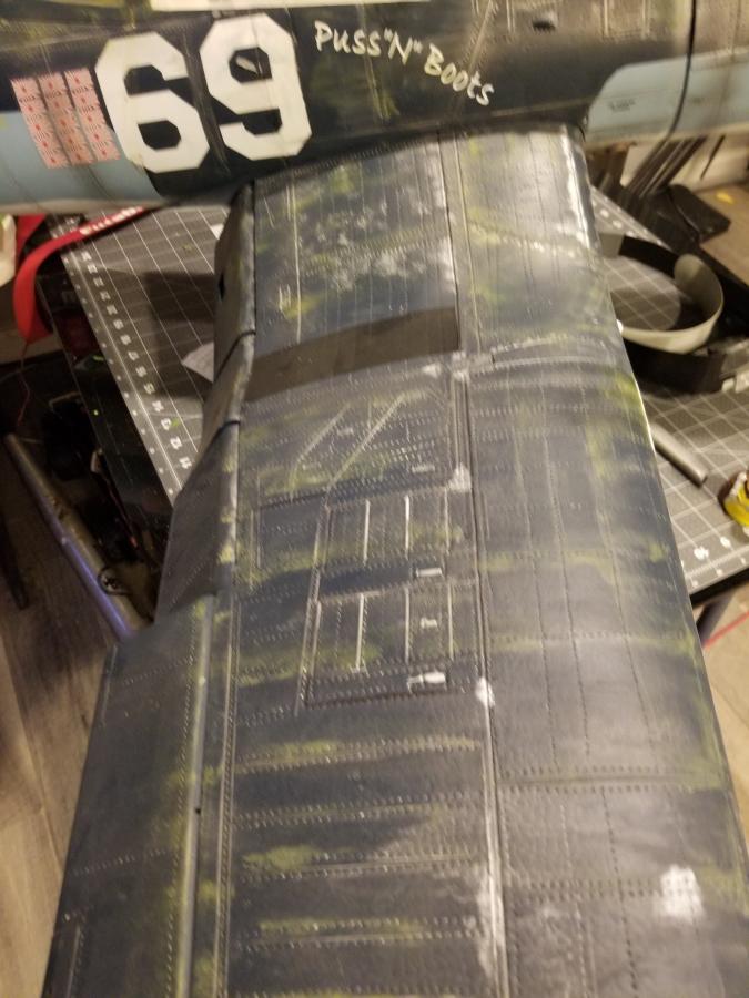

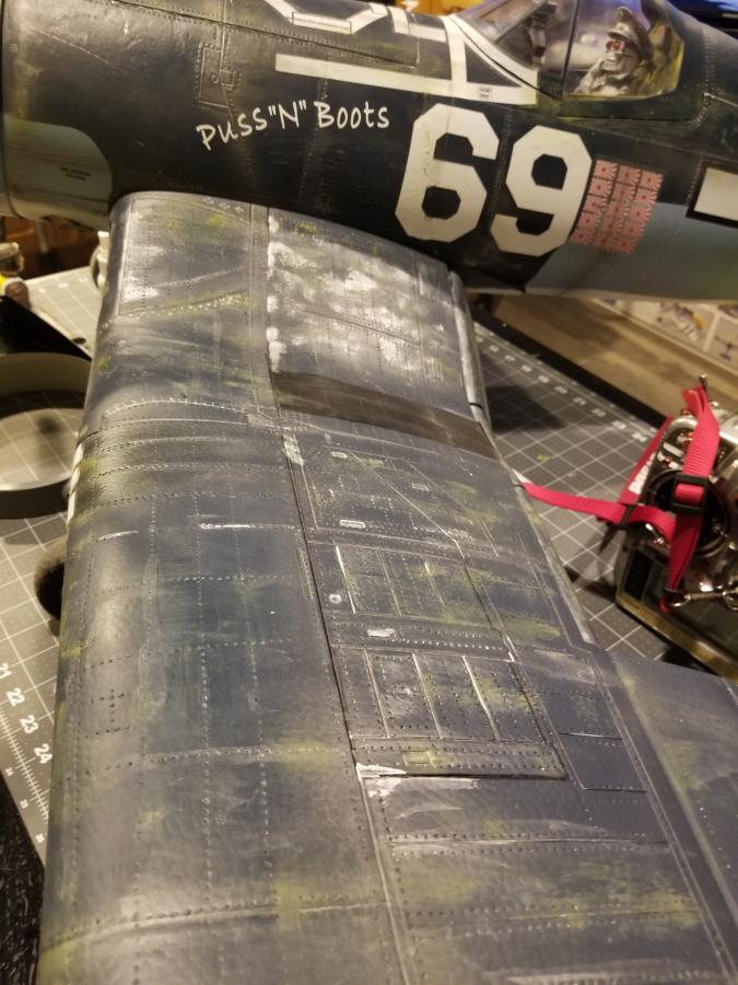

      • Getting my bird closer to what I want, don't think my birds are ever done just done enough for a while lol
        • Originally posted by Shark102 View Post
          S1, Lookin' good, Sir. Love the livery and the realtime weathering you've done. Bravo Zulu. Best, LB

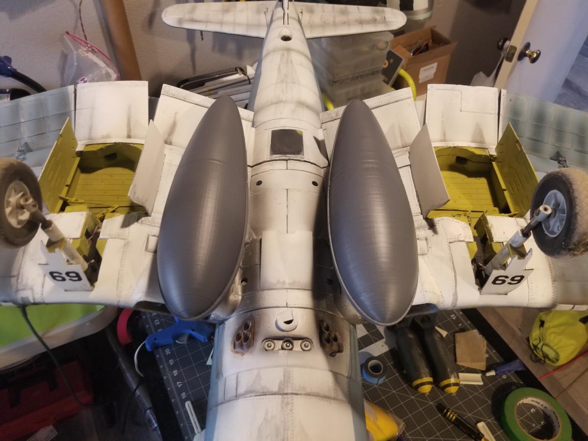

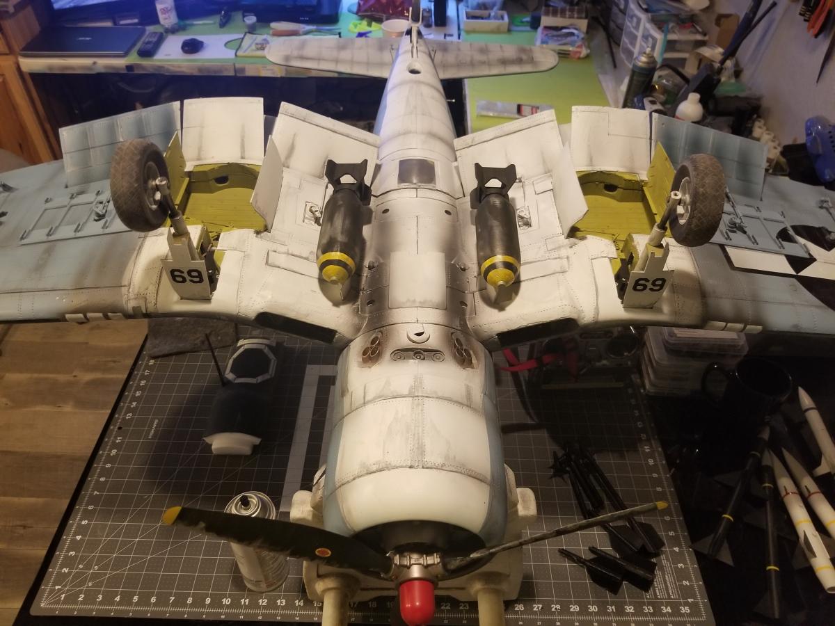

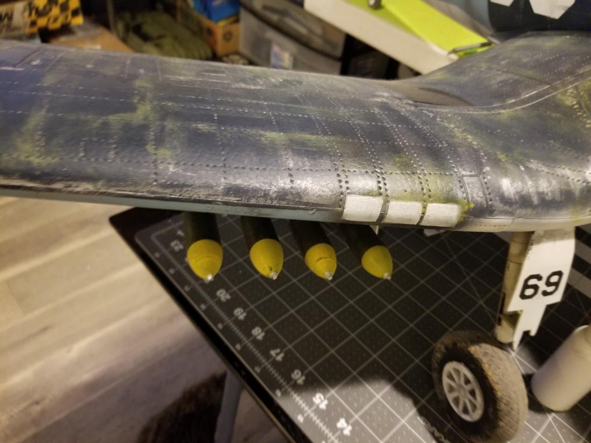

          • Big boy externals fitted and primed, final sand and paint and this birds got a full compliment of weapons and fuel options :)
            • Lookin' goooood! Love the heavy weathering...She's been busy in the Pacific!

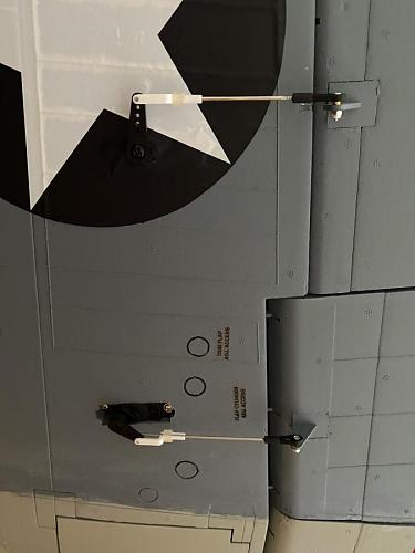

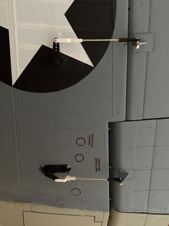

              • Hey, guys. Putting my Corsair together and I have multiple wing servo rods popping out of the servo arns when deflection is applied. Anyone running into this?
                • Flaps, ailerons or both?
                  • Originally posted by Arycon View Post
                    How are they popping out ? are you sure you installed the rod keepers correctly??

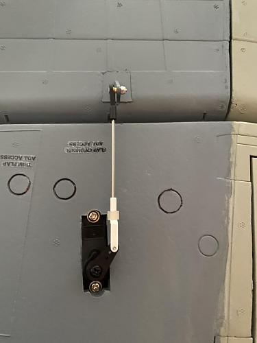

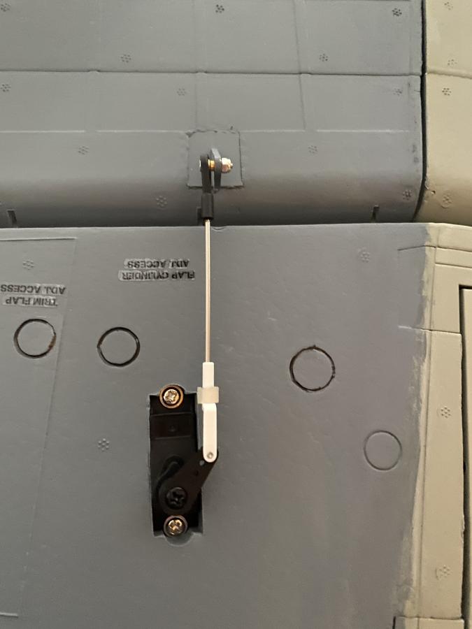

                          Hi
                          i am not sure if you sorted out you’re trouble yet,
                          these pushrods should be pretty straight forward. I use silicone tubing to secure the clips. Please see the photos
                          hope that helps
