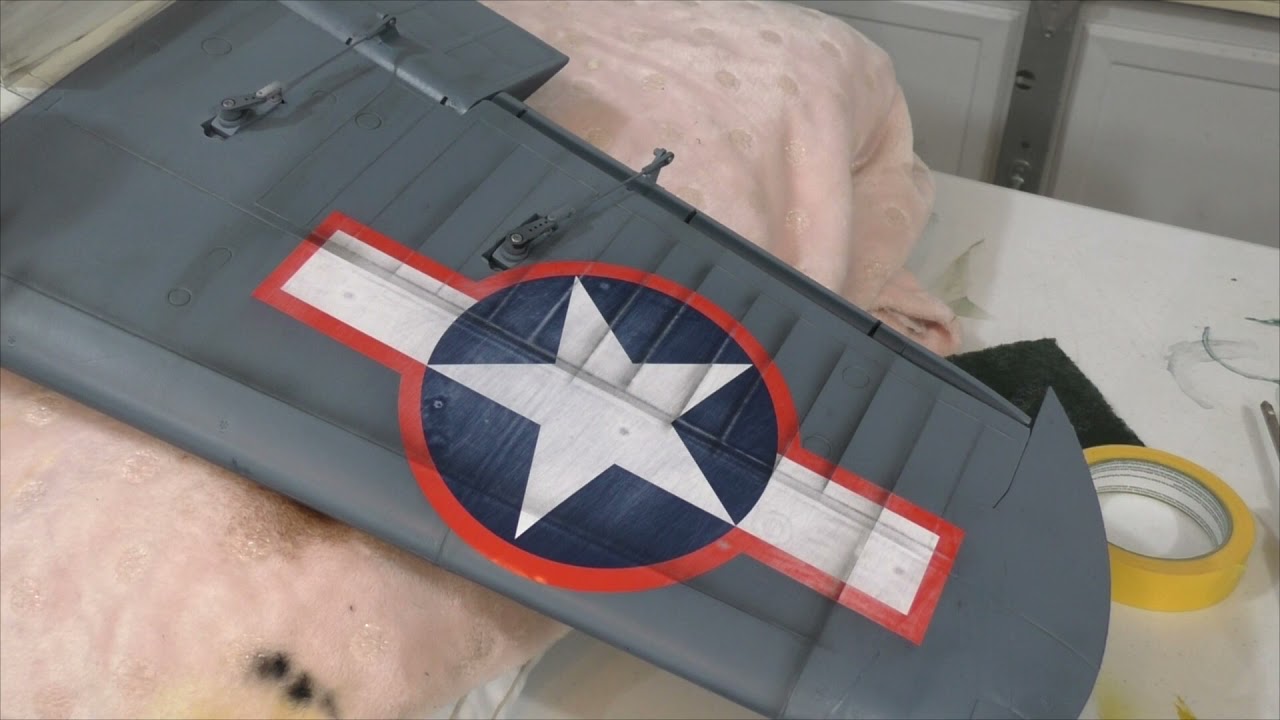

                    Here's my last video on my Corsair. Came out pretty nice and got the look that I envisioned. Thanks for all the help along the way. You guys don't know it but you all helped a little cuz I was following what everyone did to theirs. Hope you got some ideas and like it. Some real good builders on this forum.

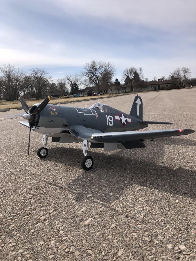

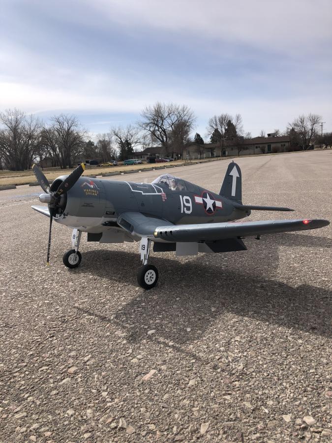

                            This is like any other War bird, it has to be flown all the way the to touch down even after touch down you have to stay busy with all surfaces. Use of right rudder on take off and landing is also very important especially when flying off paved runways. Any plane lands on grass easier, landing a war bird on a paved surface is not easy. Full flaps on the Corsair cause tremendous drag thus having to keep a lot of power on to land it. I have backed of the recommended throws for the flaps. I never use flaps when windy. With full flaps I use at least 1/3 throttle then reduce after touch down. As Viper said start with the flaps up fly it with power until just after touch down then slowly reduce the power. Landing a tail dragging War Bird is a Challenge, and when down correctly is very gratifying good luck, practice practice practice photo taken right after the test flight . the plane was way out of trim on this first flight which made it very interesting right away, and there was a slight cross wind too https://www.youtube.com/watch?v=qzucmjSlliQ
