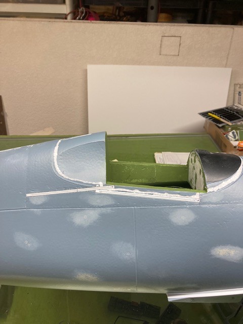

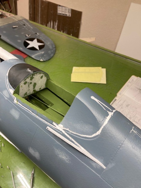

      I AM SLOWLY DOING MORE SURGERY TO MY NEW PLANE. I cut the canopy rail troughs and glued the plastic guide rails in. Then I cut out the pilot seat foam and will be adding my more scale seat that my Secert Santa sent. It will allow me to get a pilot to fit correctly. Added the glare shield in front of the instrument panel. Next up I need to cut the canopy apart. Will need a guide line and sharp knife plus steady hands. Believe I will sleep on it tonight and try tomorrow. Until Next Time, Rex

        Wow! That is coming along! I guess you're committed now! I assume the canopy will be operable in some way. Will it be powered like LB's or will you manually open it? I was just wondering what you have worked out to keep the canopy in place when you are flying it. Looking forward to updates. Good luck!!👍👍👍

          Davegee,
          Only manually open or close. Rails are 1/8" square plasti-strut with the slit made with a small saw and steady hand. Using a dress pin as the slider pin. Will be able to remove sliding canopy.
          Cockpit aera was fairly simple, just removed the OEM seat base and new seat will be glued to the backrest before installing. Thinking this mod. will be the last major thing I do before sanding and painting on clear paint.
          There is enough friction in the rails to hold the canopy any where . If not I will install a small screw in canopy to tighten down .
          After the first cut my nerves settled down and I could cut into a new plane.
          Best Regards, Rex
          P.S. Installed the sound system and started up. Loud, Loud P&W purring in the basement. This is really making the plane magical.

            JF, Looking good; however, I have a concern with regard to davegee's thought.
            You are going to want to make certain the canopy has a 'positive closed condition'.
            A screw would do it, but a latch of some fashion seems more aesthetic.
            I thought long and hard about this very thing. Airspeeds in excess of 70 mph will find any opening and will play havoc on any loose thing.
            Just my $00.02 USD worth. I would recommend a latch and possibly find a clever use for rare earth magnets. Best, LB

              Elbee,
              Your.02 are probably worth many $20. I can use magnets in the fuselage and a metal strip on inside of sliding canopy. A latch would be good too
              I fly my Wildcat with the canopy in the open position and no problems encountered. It is glued on though.
              Getting ready to cut the canopy. Been thinking about this for weeks for the best way to do.

                  Thanks guys. I understand your concerns and re-thinking if I really want to cut the canopy. May just finish the cockpit and glue the canopy back on.
                  Thanks for your thoughts and concerns. Rex

                    Elbe
                    I agree with your technique. After thinking it over I think I will just reglue the canopy as is. My sliding pins probably wouldn't hold up in 70 mph. If it flies as good as I think this is something I can go back and do later.

                      I think that is a good way to go for now, Rex. You can Always revisit the opening canopy idea, and in the meantime, really flesh out in your mind exactly how you want the sliding canopy to go together, and how to reinforce it for the winds in flight.

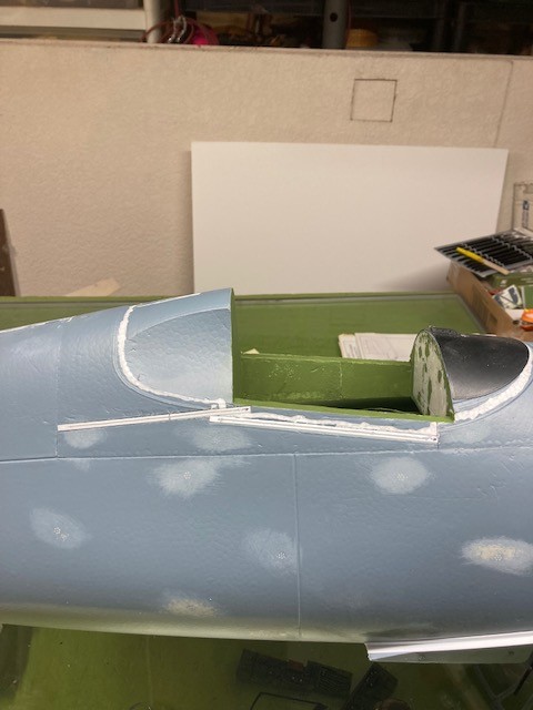

                                      Today it is cold and dreary outside so I made some small items to add after painting. I made the light Lense mold from wood glued to a stick to shape/sand and handle to make the imprint in clay. I used this to make the lense and also the radio insulator that goes on the right side of the fuselage behind the canopy. I made the antenna mounting wire holder from an old typewriter spring and alum flashing and Critical Mass nuts. I used clear epoxy resin from the craft store. I will need to polish the lense to brighten , not bad but the clay mold left a slight hue in the lense. Anyone suggest the best way to polish these?
                                      Getting ready to spray some Min-Wax Poly clear satin on plane. How much do you all thin for a consistent coverage.. What air pressure do you recommend? Planning on 3-4 lite coats before color paint. Encluded a couple of photos
