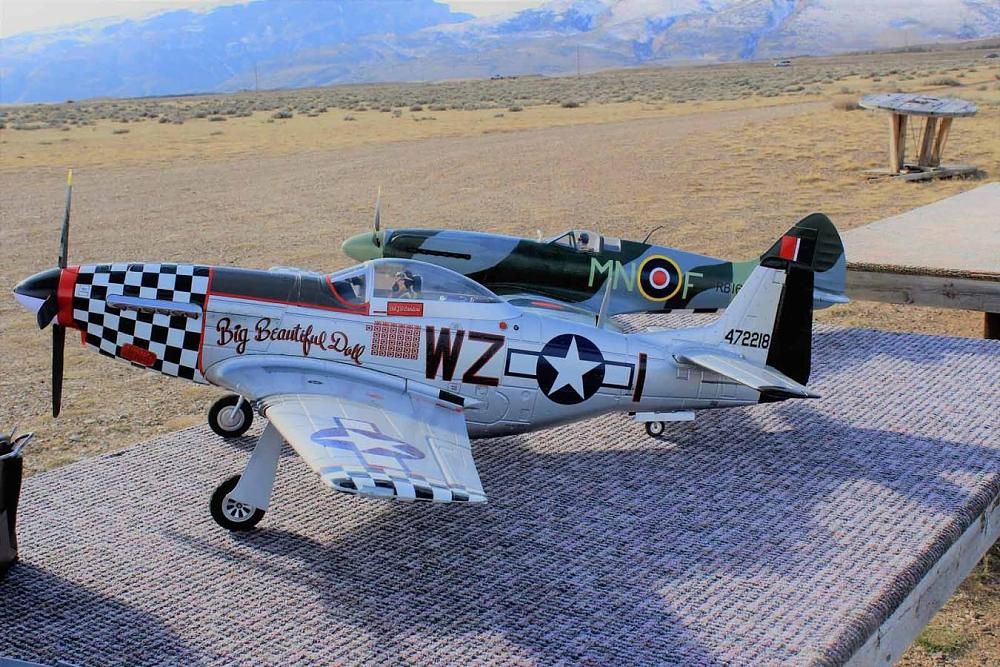

                                  As I've said before, Minwax Spar Varathane (water based) has been my go to for a number of years. When I first started using Varathane, that was way back on my Pandoras. I found that when I applied it, it would bunch up because of the oil based mold release. This is typical of all airplanes that were not factory painted but are just bare foam and decals. What I started doing was applying Minwax, letting it bunch up, basically gathering the oil residue, then wiping it off with a clean rag. I'd repeat the process until it lay smoothly on the surface, then let it dry. If I was going to paint the airplane, this is when I'd apply my paint, then apply the Varathane over the paint, using as many coats as required to get a glossy coat (if that's what I was going for). The Spar Varathane has a UV protectant in it as well and many of my planes are still smooth even though , as in the case of my FMS P51D:
                                  Click image for larger version  Name:	IMG_8996.jpg Views:	0 Size:	244.0 KB ID:	369505
                                  who is 10 years old (hard to believe!) and still looks great!
                                  My rule of thumb is to use a brush ( I use some worn out oil painting brushes from my artist days) for the glossiest result and my spray gun for a duller finish. I also use the Varathane matte finish for planes like the Spitfire for that dull look. When applying gloss, I usually have 5 or 6 coats, some, like the Avanti and the P 40 have many more than that. It can also be used as a filler and helped rebuild the Avanti leading edges and eliminating the gatoring on the wings of the P 40. My F7F was flawless in regards to gatoring although there was some minor flight damage, but all you had to do was look and the inside of the cockpit to see whether the Minwax mad a difference, she was gatored pretty good in there! When they finally get some fuselages in and I rebuild her, that's one area that will get covered in Minwax as well.
                                  BTW, after decals, Dave. It helps to seal them on. In the case of flat finishes, I'll use the gloss to seal everything then apply the matte finish over that.

                                    Grossman56 great technique, Sir. Thank you. Best, LB

                                      #5399
                                      Love that BBD!

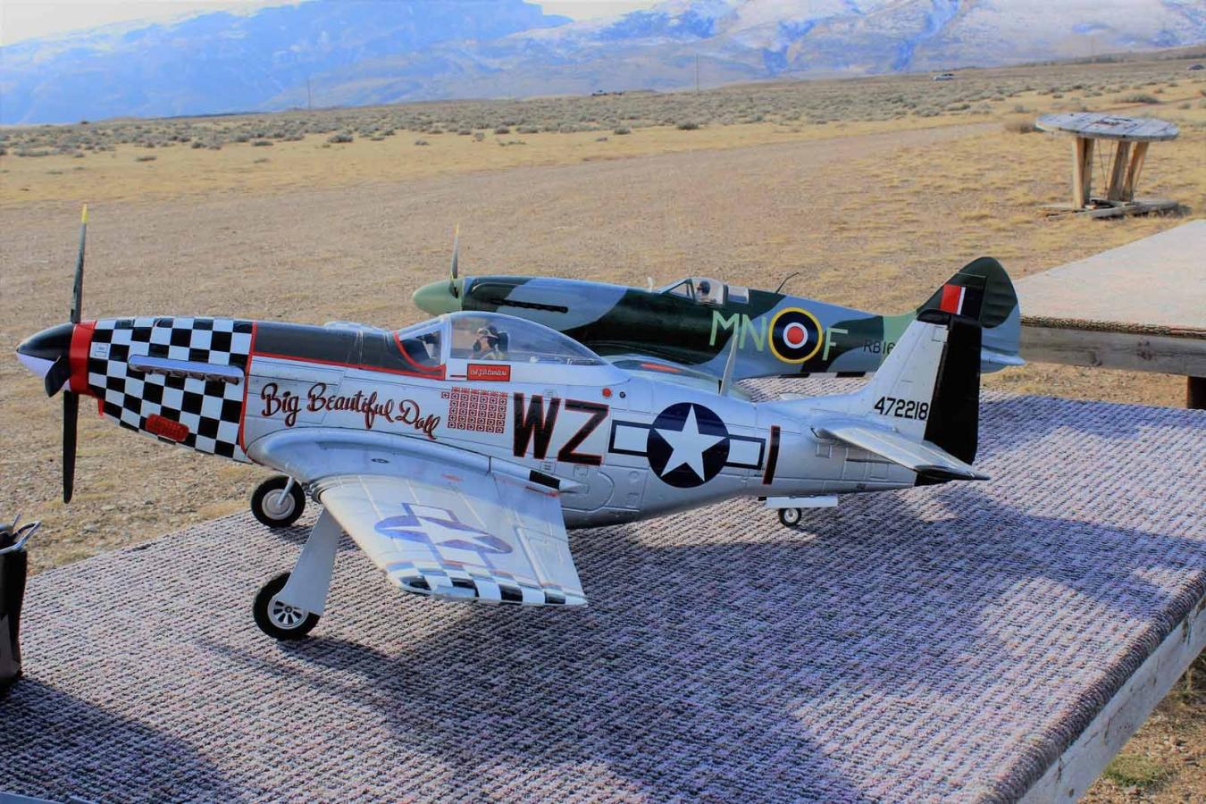

                                        Thanks, Dan. Great info!
