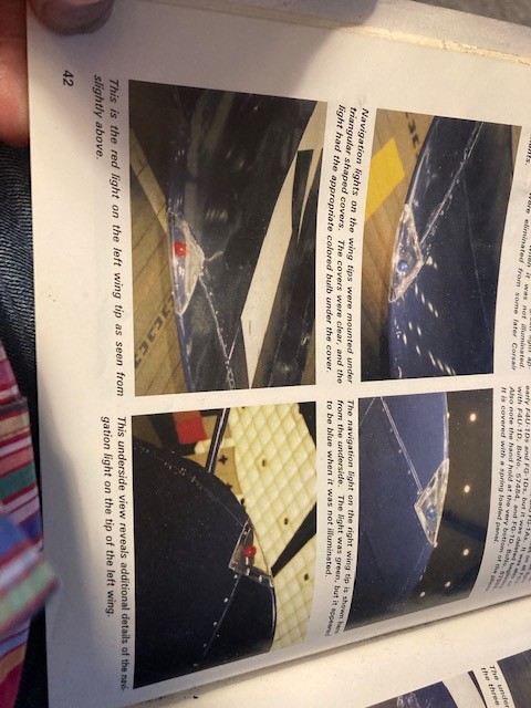

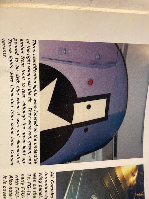

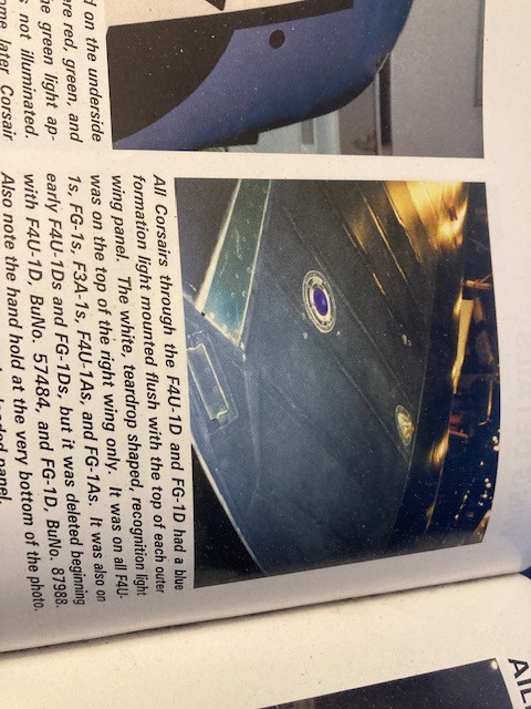

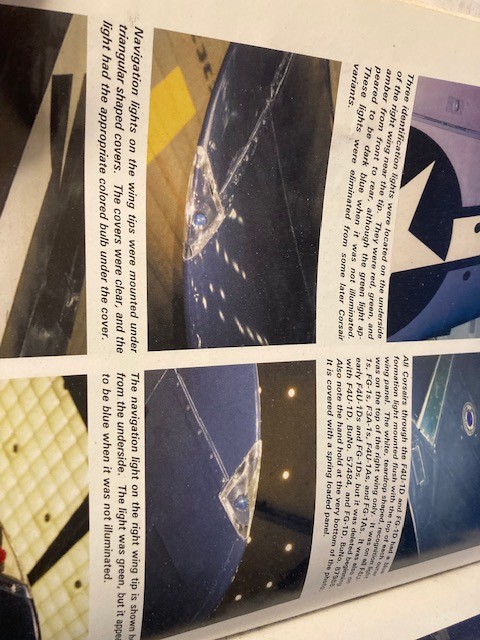

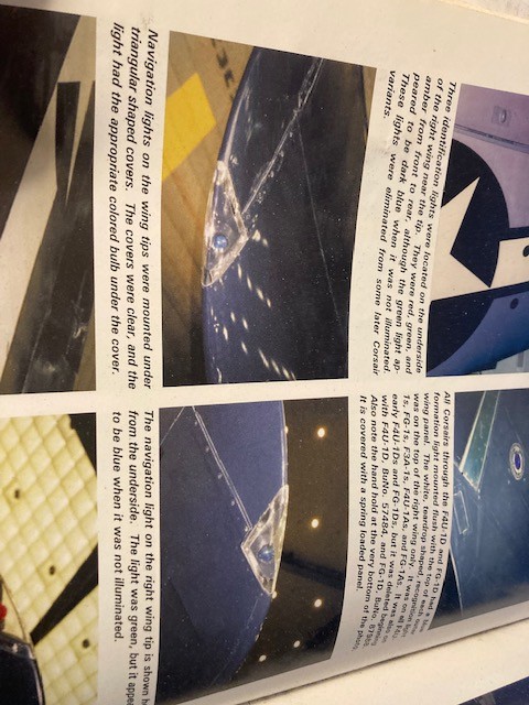

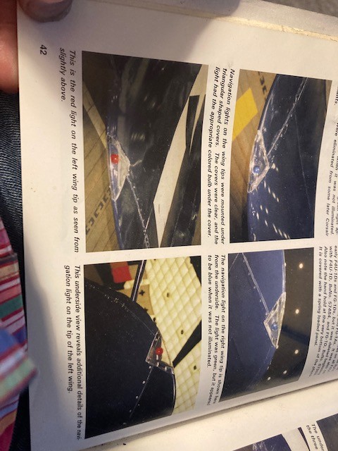

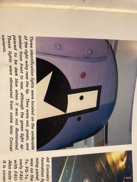

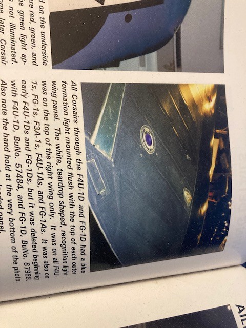

            • jetfool and davegee Gentlemen, I am adding the 'formation and comm' lights to the Corsair wings, so I need to tap into your collective knowledge base and ask, are these lights 'colored bulbs' or 'colored lenses'? I believe the NAV lights are 'colored bulbs', hence my question. Thanks in advance. Best, LB
              • Elbee,
                Hope this will answer some of your questions. Rex

                • Originally posted by jetfool View Post
                  Elbee,Hope this will answer some of your questions. Rex
                  Rex, thanks for the quick response. The pictures are great and show these as both colored lenses and colored bulbs. That is what I was thinking, though the pictures look like an actual restoration or a kit of some type. You know, if we don't know, who would? Best, LB
                    Hi Elbee: Certainly, from those pics and what I have seen on actual Corsairs in the past, the position lights for the left and right wingtips need to be colored red and blue, as they shine behind clear lenses. There should also be a clear tail light on the very back part of the fuselage.
                    Just to recap: For the three recognition lights on the bottom of the right wing should be from forward to aft, Red, Green, and Amber. I'm pretty sure those light bulbs were clear, but behind the colored lenses made it appear to be those colors when the lights were on. The middle green light when the light is off, the lens looks more blue color, than green. But when the light is turned on, it is a greenish color. I don't know if you can find a plastic to cut the lens that looks like that, that would be cool, but might be hard to find, or more trouble than you want to go through.
                    The two round, blue formation lights on the top of the outer wings the lenses were blue, of course, but I suspect that the light bulbs were clear underneath.
                    In front of the upper right wing's blue formation light lens there is a teardrop clear light that we have also talked about.
                    There is one more light on the fuselage that I don't know if we've accounted for, or not. It is another teardrop shaped lens, blue in color, that is a formation light on the dorsal spine of the fuselage, about half way between the back of the canopy and the start of the vertical fin on the tail. It is called a "section light" in the book, but I don't know what that means.
                    And of course, we have the retractable landing light on the bottom of the outer left wing panels.
                    That's all I can think of, for now. You may have already accounted for all of these lights, just wanted to chime in in case you hadn't thought of one that you would like to add to your model.
                    I would think the designers would have tried to have clear lights, of the same type as much as possible, and have colored lenses to emit the color that they desired. That is with the exception of the left and right wing position lights which HAD to be red and green since they were under clear lenses. At the far end of the supply line om the Pacific, I doubt they would want to have to search for a whole bunch of different colored lights when a simple colored lens would give the desired effect. Just my two cents' worth!
                    I think either Rex or I can produce any photo documentation from our books if you need it for any of the lights you are going to be putting on your plane.
