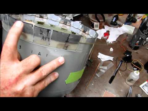

    Not sure if this is helpful or not but I was always transfixed by the late Don Rice's work on his giant scale Corsair. There's several videos on his cowl flap mod and here's one of them.
      • 4848
      #3542
      Aros, great find. I've watched all of his videos I could find on the Corsair project, too. I liked his building style, that is, he was not afraid to try anything and 'trial and error was the methodology. As my gran-pappy used to say, "Never time to do it right, but always time to do it again." Sadly, I understand he passed away before completing his Corsair. Best, LB

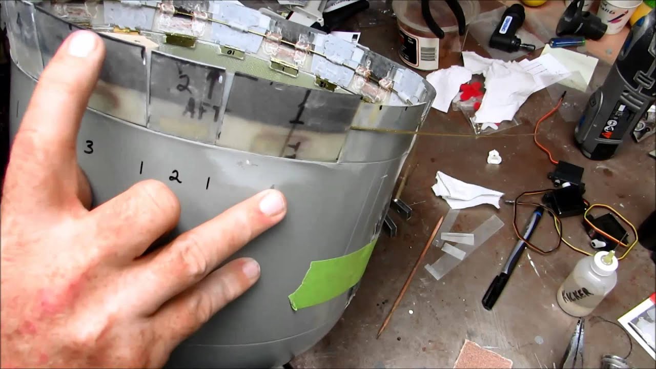

        #3543
        LB, yes, when the cable is expanded/retracted it will open close the flaps. The flaps will be attached to nylon hinges. Two servos will push/pull on the music wire. Placement of the servos will be a challenge.Tom
          Elbee commented
          Editing a comment
          Are you designing for Cowl Flaps 360 around the Cowl or the other version with the solid area at the top of the fuselage? I presume the 360 degree version is an early variant style, but have not researched that far.

        #3544
        Aros, yes I'm using Don's guidance. Tom

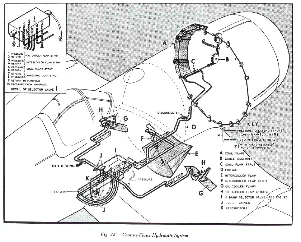

          #3545
          I've spent a little time thinking about the mechanics. Here's my idea for what it's worth.
          Instead of using an extra servo to open the flaps, maybe make the cowl flaps spring loaded to the open position just like the real full size Corsair and with one servo mounted behind the firewall you could route both cables (stainless cable, not wire. Or other fishing leader material) to the one servo to pull them closed. I thought about just anchoring one side and pulling on the other side but you may get asymmetric movement?
          My two cents....
          Here's a schematic of the system showing the cables that pull the flaps closed.

                #3548
                We are dealing with a molded foam model where the cowl isn't removable. This limits accessibility and structure for a lot of options. Great ideas guys.
                Tom

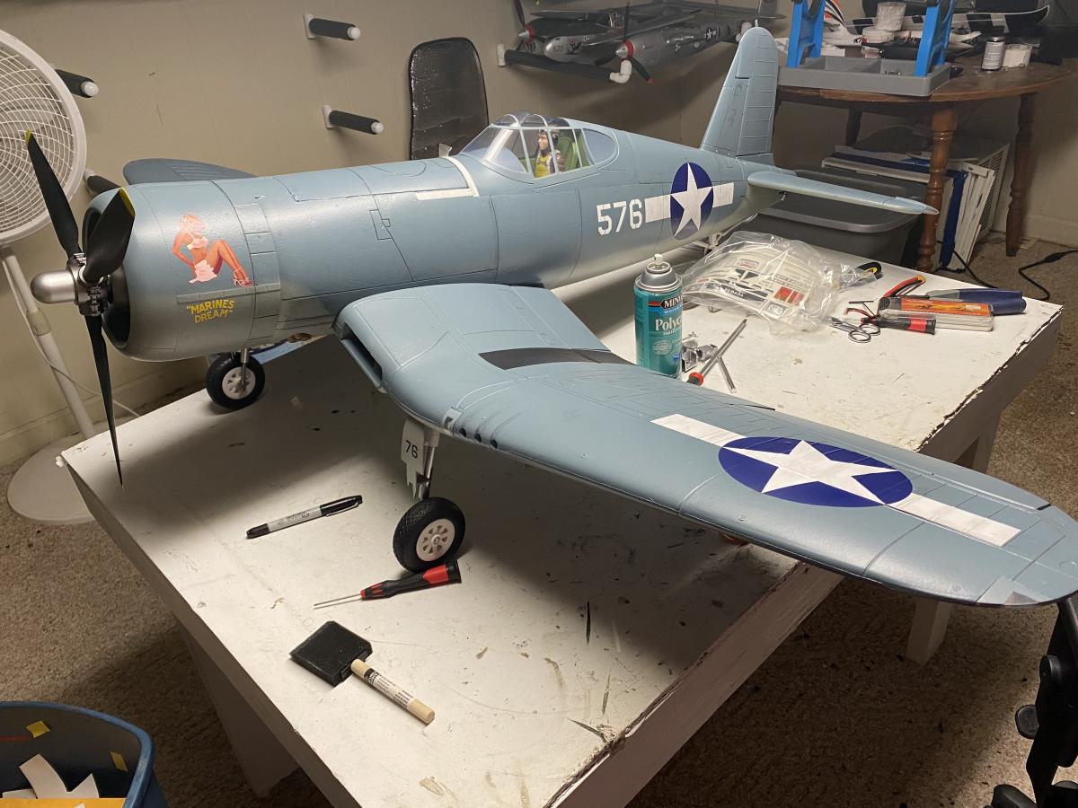

                                      #3560
                                      Originally posted by wldecker
                                      Wow! Sorry I waited so long, but had to get the Spitfire and Al-37 before I finally ordered my birdcage! It will be here in 2 days (it's in a snowstorm right now!)
                                      I ordered "Marine's Dream" Lt. Edwin L. Olander's livery from Callie Graphics! I grew up watching "Baa Baa" and always liked the other pilots that made Pappy look so good! Thanks to all who posted before, on this thread. Lots of great ideas...Where did the 3D printed cockpit go?
                                      I just did mine up in the same scheme! Looks awesome
