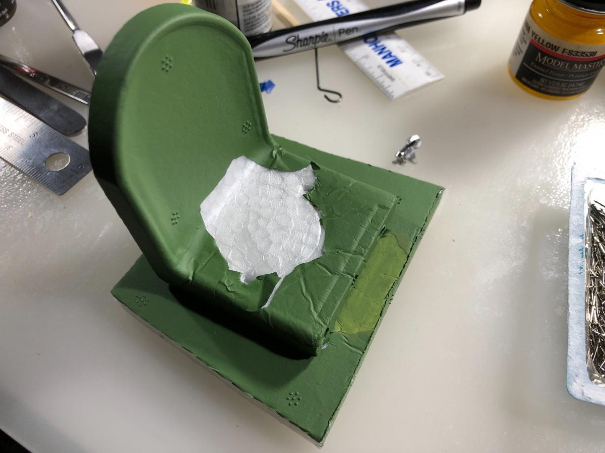

                    Hey LB,
                    I removed the original foam layer the factory seat sits on. This opens the cockpit up quite a bit and perhaps would allow a full pilot figure to fit in as the seat can be lowered an additional half inch or so.
                    I used a piece of .032 aluminum as a stand-off when I cut that out so the 3D parts would drop in like a glove. I used 7/32 foam board to substitute as switch panels. A variety of pins as switches and levers.
                    For a cockpit floor I cut a 5 x 5 inch piece of poster paper, painted to match, inserted that through the battery opening, and taped in place.
                    The reflector gunsite was your small Birdcage with lenses cut from old flashlight clear lens with a light brite green peg as a level. I also added canopy rails made from old windshield wiper stainless steel leaf springs.
                    Just all smoke n mirrors that will suffice for a stand off scale that most guys will just look through the canopy and be reasonably fooled. A big ole’ collection of recycled junk!

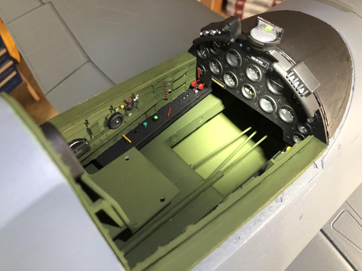

                            Originally posted by Ole-Timer
                            Thanks LB for the generous assistance on the cockpit.
                            Removed that lower section of foam and added several other tidbits.
                            The cockpit kit is awesome!

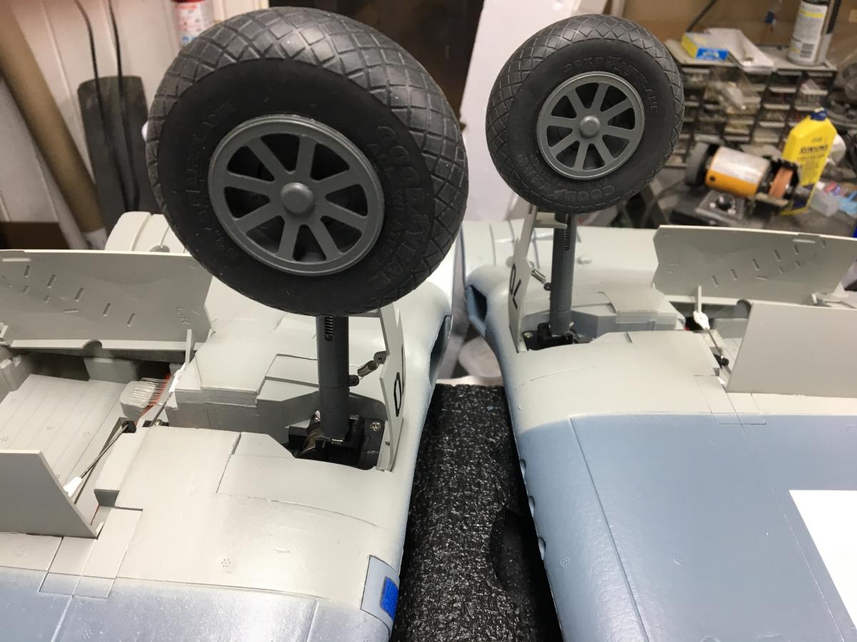

                                        Hey, in the RC Groups thread, there's suddenly a lot of hand-wringing over using the Robarts Diamond Tread Scale wheels and their effect on CG. They're not totally wrong (I haven't checked my CG yet). But I did some checking and (speaking in rough numbers), the 3.5" dia. Robarts wheel set weights about 3 oz/85 gm more than the stock wheel set -- 85 gms of extra weight swinging several inches aft of the CG when retracted.
                                        So there's a good chance I'll be adding the kit-furnished extra weight pellets (41 gm) to the cowl and maybe more -- OR -- I compared the weights of my HRB 5000 and 6000 lipos. The 6000 weighs about 85 gm more than the 6000. Of course, none of this takes into account the distance fore and aft of the CG, but it's a starting point.
                                        The Robarts look a lot better IMO, and the tires are much sturdier. I suspect the kit tires will wear out over time given the size of this model (if flying from runway). We shall see!
                                        In case any of you are wondering about my choice of dark gray for the wheel hubs and struts: birdcage gear was never white (like the kit tailwheel -- F4U-1D's did have white). The gear was most likely light gray from the factory on birdcage F4U-1's. But I did a lot of research and many if not most of the photos of land-based Corsairs show the gear painted (or re-painted) a darker color than the lower-surface gray. It's possible they used blue, but I opted for darker gray (as have some serious plastic modelers doing similar schemes).
                                        Hey, have any of you already flown yours with the 3.5" Robarts, and what did you find CG-wise?
