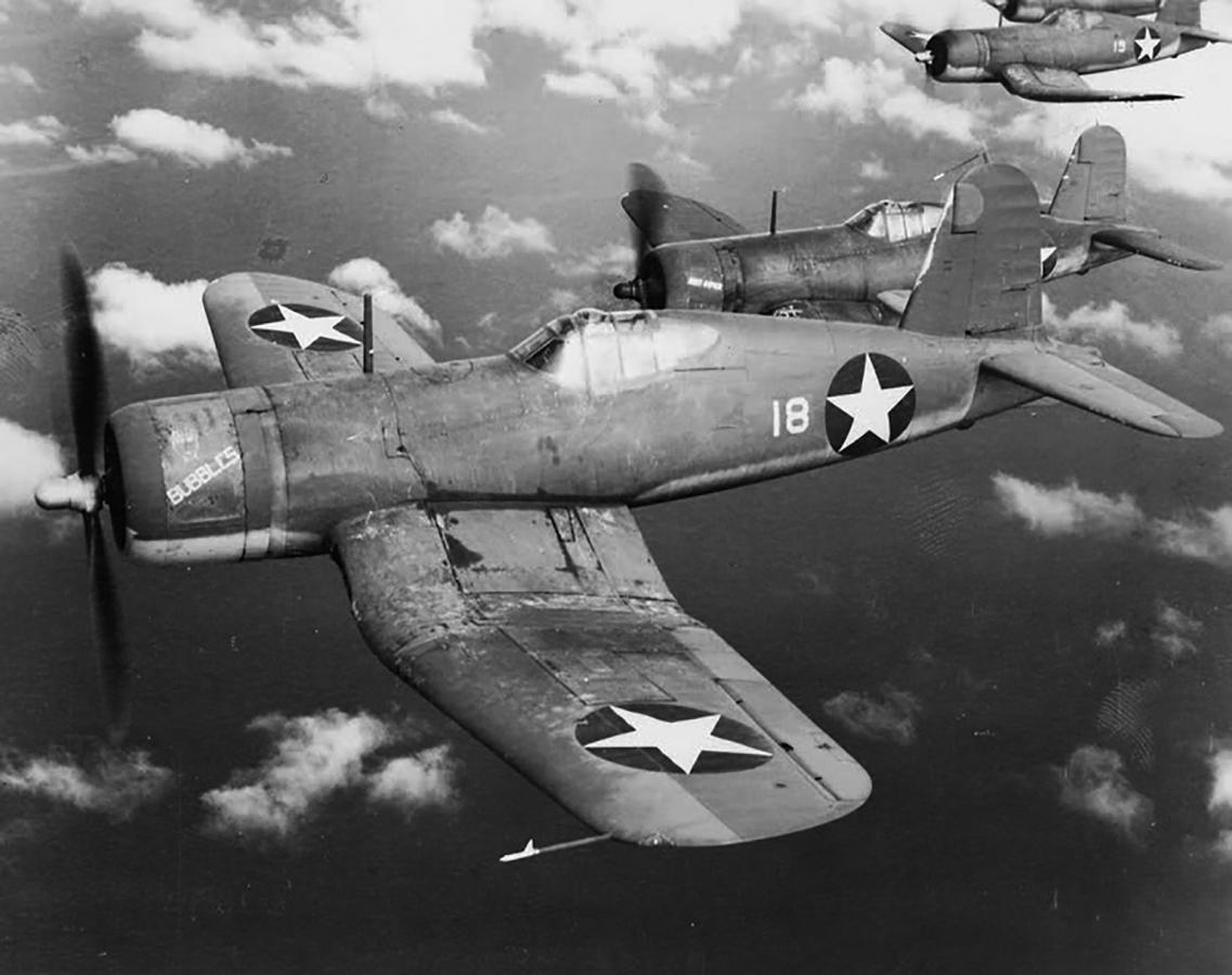

                F4U-1 Birdcage
                Factory fresh and in Theater touch up painting.
                Is it just me or exactly what am I seeing here...?
                We can all plainly see the lighter areas on wings where cloth was used on the Corsair. Visible before the aircraft even sees the light of day.

                Between color photo’s, colorized photo’s, and black n white photo’s there are many dark areas on worn Corsairs in theater.
                Is it just me or am I seeing wide spread use of dark blue paint being applied on Intermediate Blue upper surfaces being mistaken as dirt and grime by some...?
                I’m getting ready for the paint booth and do not plan to use too much in the way of dirt on my bird. Tropic thunderstorms and bleaching sun. I think it’s all about subtle fades and dark blue oversprayed areas depending on the particular choice of livery.
                But, this could just be my interpretation and it’s south of the equator :Confused:

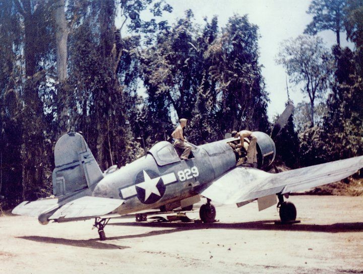

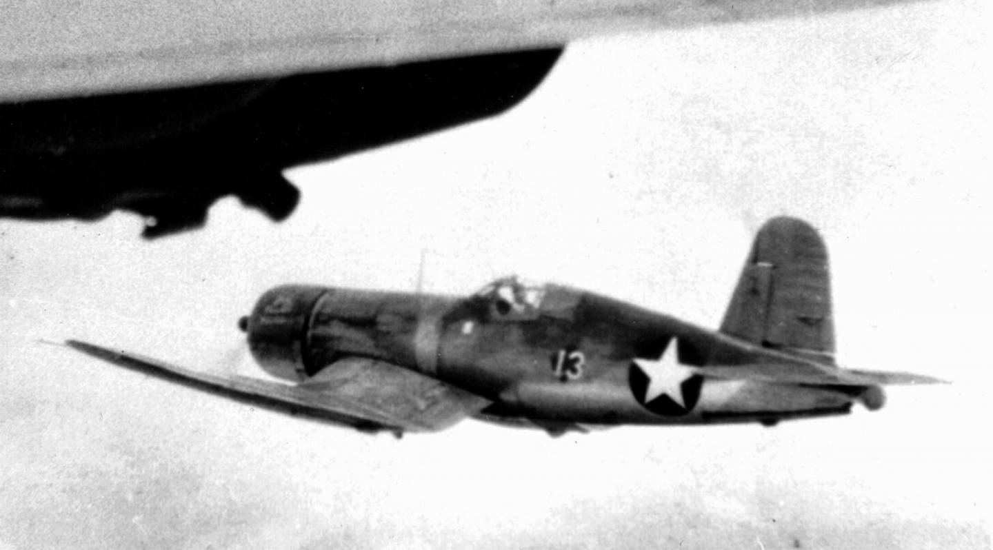

                      My theory is that the differences have to do with sun, so I am planning on doing aggressive pre-shading with navy blue, followed by a light dusting of blue-gray. Then follow that with lighter shades of almost white to give the 3-D effect. I'm also going to pre-shade with a heavily thinned navy, dripped down from the panel lines and on the wings to give the effect of fuel leaks. Those shades from fuel don't seem to have bleached the paint as much as stained it darker (for some reason). Later Corsairs have a bleached out color where the leaks were, but these earlier birdcage's not so much.
                      Also, for those real history buffs, I've been tracking down photos of Ken Walsh's Lucky 13. I noticed in the corner of the familiar photo we see, that they mentioned the vertical stab had been pained in the light gray (you can barely see the color difference in the edge of the photo). And, the photo clearly shows the light gray underside color coming up almost halfway on the fuse. I tracked down this rendering showing both, and as unusual as it is, That is what I think I'll do. After all, it's those unique one off's that make the plane so special! Rob

                        I thought I had my livery all worked out with several pictures available.
                        Right
                        Turns out since I’m scrutinizing them for details, what i’m really looking at were two different airframes with the same name.
                        Silly me.
                        The first Birdcage Gus’s Gopher with the Gopher nose art and mostly stock paint was shot down sometime in August over Bougainville, 1st Lt Thomas survived and was rescued.
                        That same Plane Captain from VMF-213 got busy on a replacement bird asap.
                        The second Birdcage Gus’s Gopher had the name only on each side of the cowl. It must have been built up from wrecked parts and sported a completely new three color paint scheme applied in theater.
                          I agree with the light fin and rudder, also from the photo’s I’d say the entire turtle back was repainted in dark blue, parts of the cowl, and several other spots. I’m seeing a lot of repaint in dark blue going on there. The sun will cause widespread bleaching on upper surfaces but not the dramatic differences present in the pictures. That’s repair and repaint from battle damage and there have been quite a few repairs done to #13 for sure. I’d say she was regularly in the thick of it! The fuel spill on this port side did bleach the paint.
                          Click image for larger version  Name:	AAE86B05-6731-476D-96E9-0DF34E37B6B1.jpeg Views:	0 Size:	123.6 KB ID:	181071

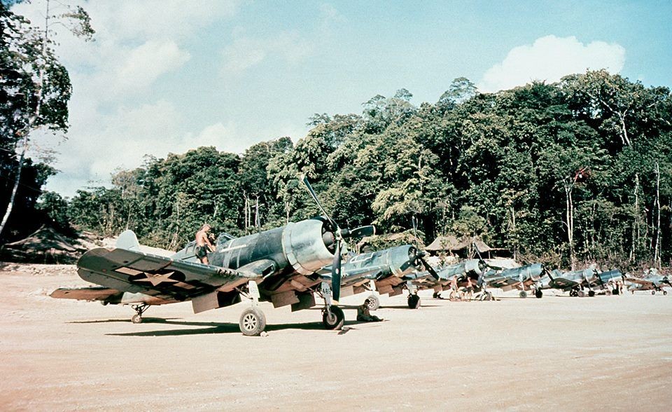

                                I have to agree with Smoothie on what Dana Bell says on Birdcage paint schemes. I saw this trying to research my livery. Repairs and overall repaint to these birds was being done with multi-blue scheme in mind. It was likely driven by orders from higher authority. The best advice I can give you is if your fortunate enough to have multiple photo’s of the livery you want to do, it should stand to reason that any upper surface color close to what the national insignia is, will likely be dark blue and anything lighter will be mid blue. The center aircraft in this photo likely shows this transition and it was happening before white bars were added to insignia.
                                Click image for larger version  Name:	78247ED0-C34D-4BD0-BD06-8E136D3392C8.jpeg Views:	1 Size:	99.0 KB ID:	181087
