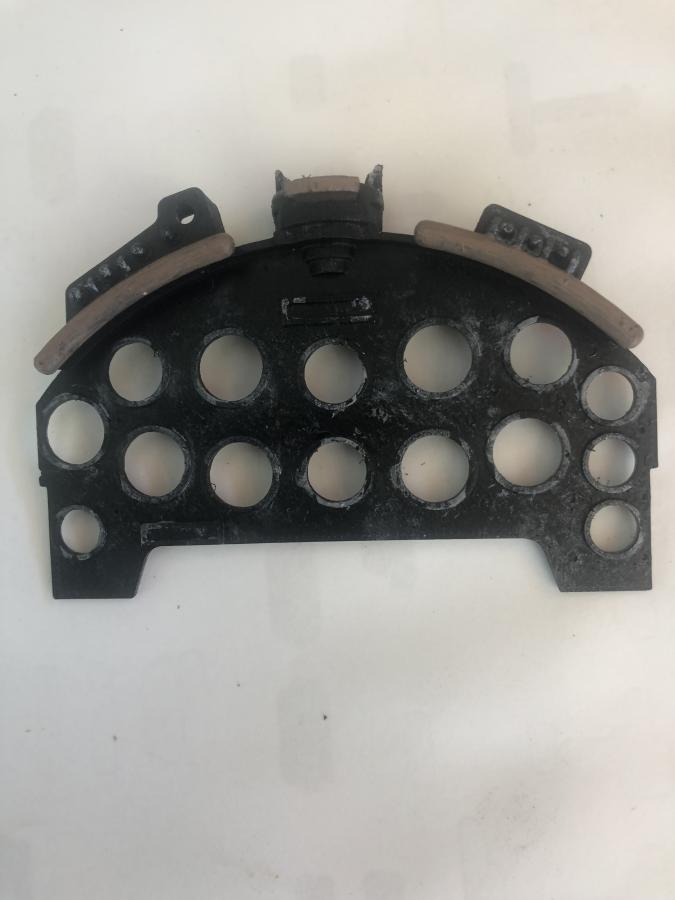

                  Yup, the CA (Krazy Glue) works GREAT on the instrument pgun sight :Cool:
                  ... now all I gotta do is wait for my thumb and index finger to “unglue”... :Confused:

                    Well that worked well...NOT :Angry:
