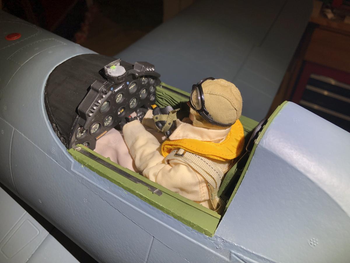

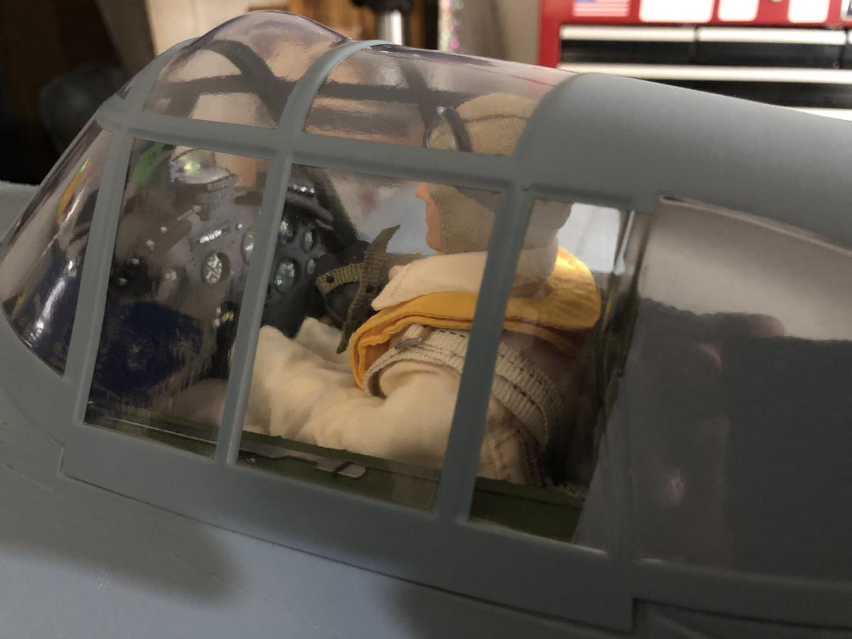

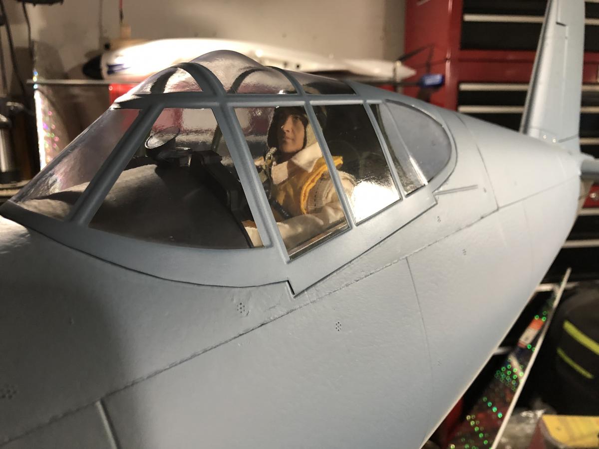

        The Warbirds Pilot will fit without cutting him in half, you will have to bend him further up than normal and remove the upper floor from the cockpit. He is on the large side and a bit poofy but I believe it beats that Rubber Chinese replica.
        Notice how skinny and light the canopy frames were stock, then after the repaint to make them as they should be.
        Makes quite a difference to the overall look!

        WOW, that really looks outstanding. Could you hook up another servo to his arm so he can put on and take off his mask? LOL
        Now that I see it, I'm definitely going with the "Clint Walker" size warbirds pilot. Putting it in the Bubble-Top version, so I couldn't make up my mind between the one with a brown leather jacket (USAAF version), or the Navy version you have, although my final livery will be a Marine version-so by rights should have the Navy pilot with cream jacket and pants, (is that correct, Marine and Navy should be similar), although the brown leather jacket does look good.
        Thanks for posting those photos. I was not looking forward to cutting him off at the waist, although my name will be on the plane as pilot and I will be flying it, so a pilot with nothing left below might be accurate, especially after I said "I Do". :Silly:Just kidding, couldn't help taking a cheap shot, even though it was at myself. She's not like that and even recommended I go with the more expensive pilot with a moveable head over even the Aces of Iron pilot, which still looks great, so who's going to argue with her.

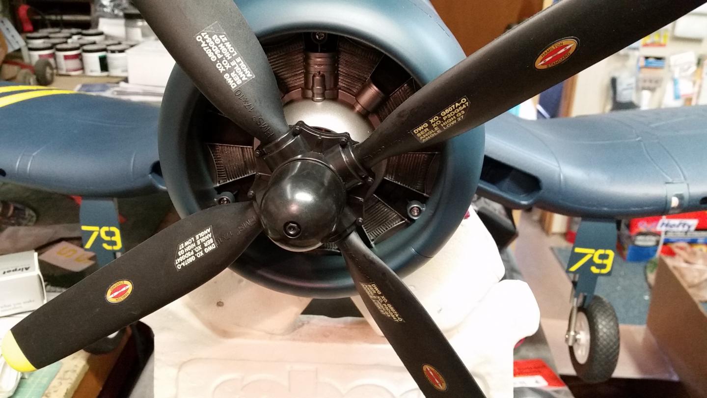

                              • Hey guys, a looooooong way back in this thread, George (Tired Iron) showed that he mounted a FMS 4-bladed prop on the Corsair. It looked sweet and he said that it flew pretty much about the same. The FMS prop is slightly smaller (17x10) but it has an extra blade.
                                Well I ordered the parts - you'll need the prop blades and also the plastic hub and spinner assembly. Motion has the props (part# FMMPROP002) but not the hub. The prop was originally for a big 1700mm FMS P47 which is discontinued and the hub isn't available from Motion any more. But I did find it on the FMS website and also on ebay.
                                I also purchased the FMS prop adapter and nut, motion has that (part# FMMDZ001). The FMS adapter uses a nut to secure the prop.
                                This project wasn't even close to being as simple as I thought it would be, but I did make it work so I thought Id' share my story.
                                So anyway, I assembled the FMS prop and when I put it onto the original OEM prop adapter, I found that there wasn't enough threads on the shaft to put the nut on. Well, it went on, but to be more precise, you need to have a little exposed thread on the end in order to screw on the spinner cap, which covers the end of the shaft. I took the prop off the plane and tried a test-fit using the FMS adapter through the FMS hub. Turns out the FMS prop adapter has the same shaft diameter but its about 1/2 inch longer. So the OEM adapter is too short! Or the new prop hub is too thick, whatever.
                                So I thought, OK I'll just mount the correct FMS adapter. Unfortunately, you can't do it!! The bolt holes on the OEM adapter are 1.5mm apart and the FMS adapter's bolts are 2mm apart.
                                There's not enough metal to bore out the holes, either.
                                So unfortunately you can't swap out the adapter.
                                And, there's no way to make the FMS hub "thinner".
                                By the way, the OEM adapter has Loctite on the screws, so they're really hard to remove (you need to heat the screws).
                                But don't do it. You have to use the original (short) OEM prop adapter that comes with the plane.
                                But - you will need the bolt from the FMS adapter!
                                Also - the hex on the OEM adapter that locks the 3-bladed prop hub in place is smaller than the FMS adapter, which means the FMS prop just spins, it won't lock into place on the OEM adapter. George told me don't worry, just tighten the nut down and it will be fine.
                                OK... so to make it work.... here's what I figured out.
                                First I used some masking tape (about three layers) around the hex, to "enlarge" it just a bit.
                                The FMS hub slid on nicely and stays in place. Good.
                                Then I had to not use the washer (under the nut). This left about 3 mm of threads sticking out.
                                Tighten the nut down, the prop is secure.
                                The last step is to screw on the spinner hub.
                                The FMS spinner hub has a metal nut molded into it, so when you screw it on it acts like a "safety nut" for the main nut on the shaft.
                                OK, well, there's not enough thread left to screw on the plastic spinner hub - actually what's happening is that the shorter shaft won't reach far enough into the spinner to engage the spinner nut.
                                The only way to do this is: I had to cut off about 3-4mm off the bottom of the spinner. (very carefully)
                                THEN it was able to screw on.
                                Turns out the slightly shorter spinner hub is just about exactly the same height as the OEM spinner hub, so it looks perfect.
                                Here's it is...... looking totally badass... I'm just sitting here, waiting for Spring.....
