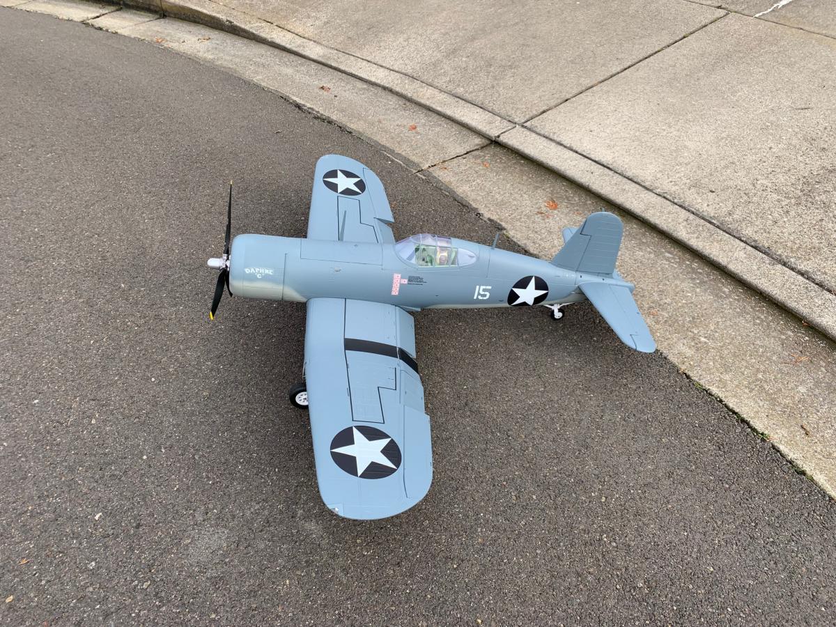

    It has right thrust. It helps counter the torque on take off and other situations.... You can see it is 1-2 degrees in your pic... I always built that into warbirds, along with down thrust, but on the aerobatics, it is all 0 0 0. Zero on the thrust, zero on the wing and zero on the horizontal stab....
    RichJ53, its definitely got some right thrust like Hardway said. No down thrust. The other day I noticed, if you look carefully at the replaceable cowl part, you can see that its not symmetrical in the center, the entire center part is angled to the right just a bit on order to accommodate the slight right-thrust angle of the motor. Its obviously very carefully designed.

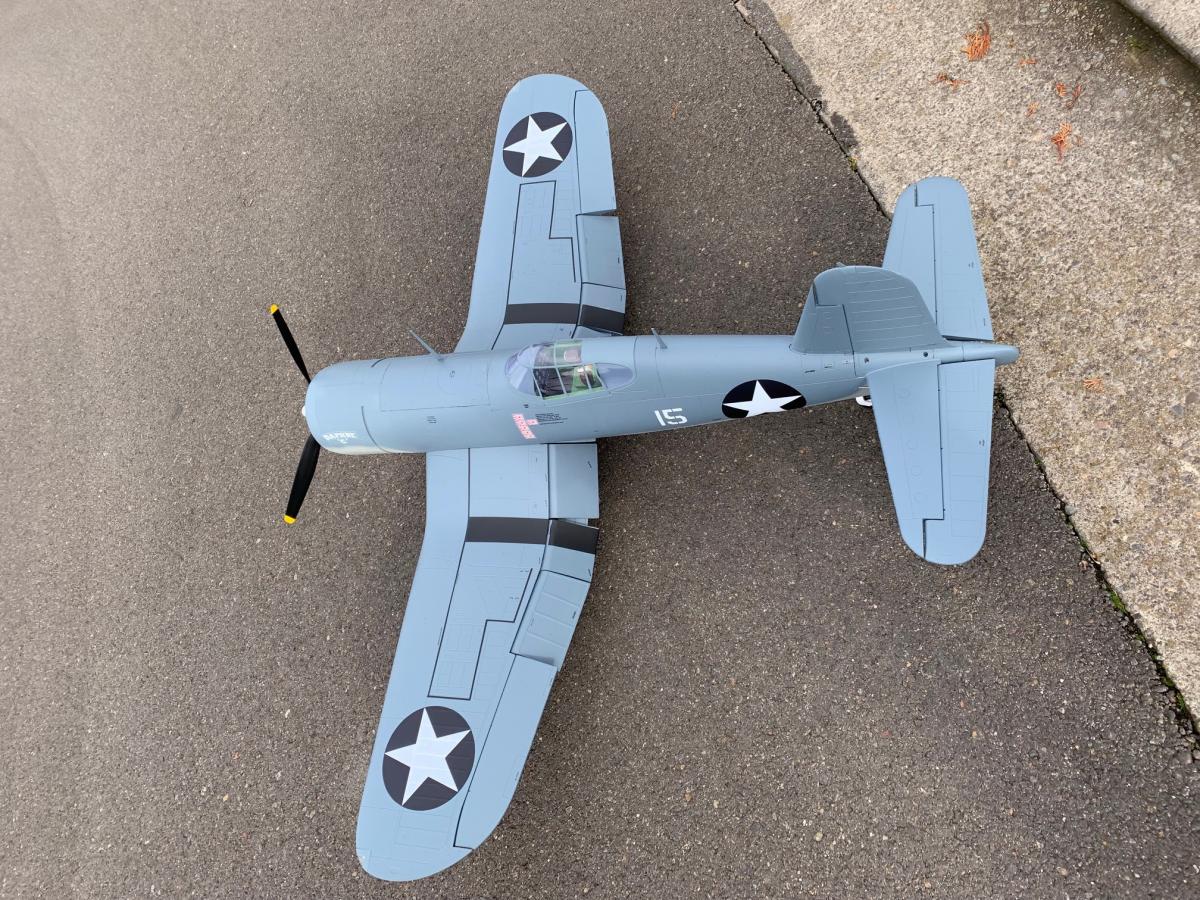

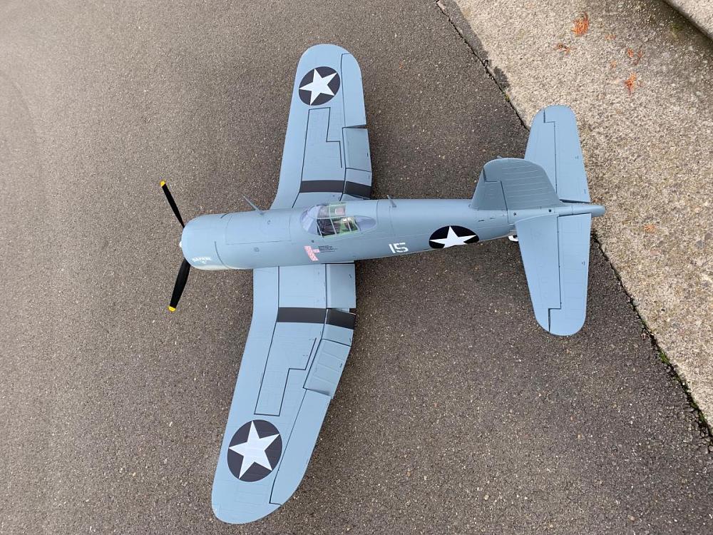

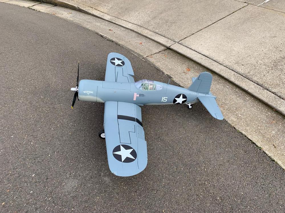

            Originally posted by RichJ53
            Hi Guys,
            Did you notice some right thrust angle on your FW Corsair ? I think my prop has about 3/8" angle. Thanks for any help from the diehards :)
            Took a couple of photos before the snowfall

            I would be concerned if it didn’t.
              #1606
              Right on..........There isn't a foam ARF warbird as well most others out there that I'm aware of that doesn't have thrust offset:Smug:
              As a matter of fact, full size warbirds have propeller thrust offset designed into them ;)

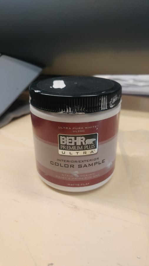

                                    I buy the latex house paint "Behr" in flat. Comes in a 7.5 oz jar for about $3.50. After painting you can spray MinWax to seal. This comes in matte, satin and glossy. It also comes in two versions - oil base and water based. I always get the water based. Easy clean-up, fast drying and no fumes.

                                        This is the one that I use Click image for larger version

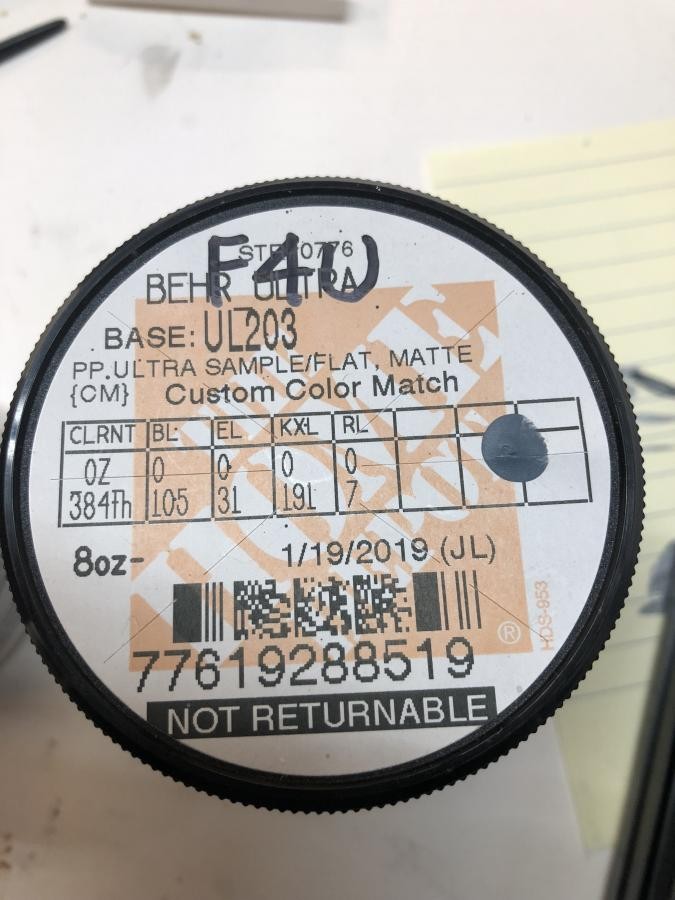

                                          HighFlyer posted these two colors and respective formulas for the BT and BC. I got them from Home Depot. They're small quantities for samples ($3) and will last forever. They only come in one sheen (flat / satin) which is perfect. The Dark Blue for the Bubble Top is spot on. I've touched up and feathered out a couple spots from assembly and gently blow dried it and you couldn't tell it was even touched up. Use a very fine brush or airbrush and thin the paint down about 50%. NOTE! Don't rush w/ the blow dryer or over overheat the area or you'll begin to see some minor gatoring. I was lucky it was on an area that wasn't noticeable and could repair it easily. Good Luck!
