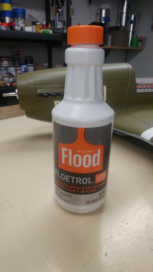

ID:	180704 this is a thinner that's carried by Home Depot that I use when I'm painting my planes, it slows the drying enough so the brush marks lay down.

                      Good tip! Thanks for sharing...I was going to HD this weekend for the paint match and might have to pick me up a bottle while I am there.

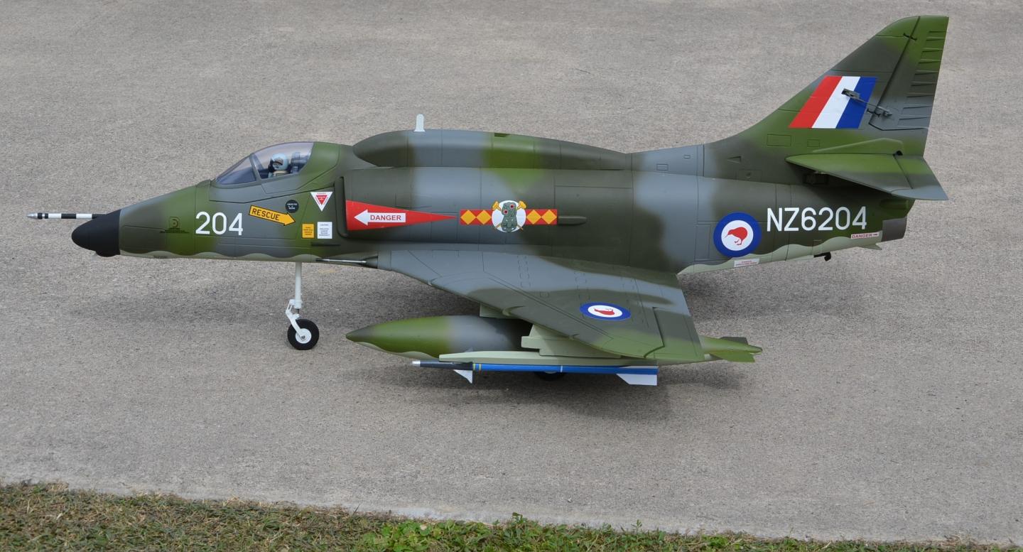

                              RC is right. If you are using an airbrush, large areas are harder to spray. I used HD Behr on my A-4, but sprayed it with a basic Badger 201 single action spray gun. 34.00... I used bottled distilled water and thinned it to the consistency of chocolate milk. Have to do light coats and if it runs, just blot it with tissue... patience is the key. The paint holds up great though! It is exterior house paint, after all!! :Cool:

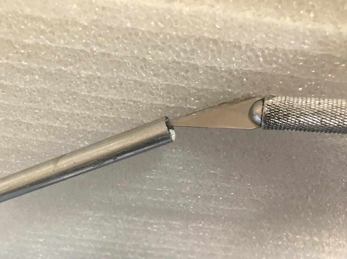

                                  As for cutting holes in foam, I think I have a better way than shown in an earlier post. Start with aluminum tubing of the desired diameter. Use a brand new No. 11 blade and sharpen the inside by "slicing" while rotating the tubing. Do NOT "test" the sharpness of the tube when you're done (ask me how I know). Brass tubing is harder to sharpen, but stays sharp longer obviously. Rotate the sharpened tube into the foam and you will get a perfect hole nearly every time.

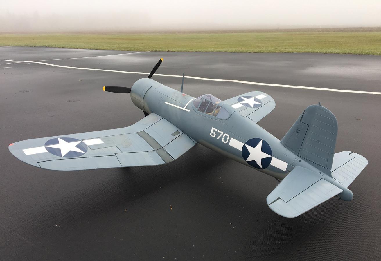

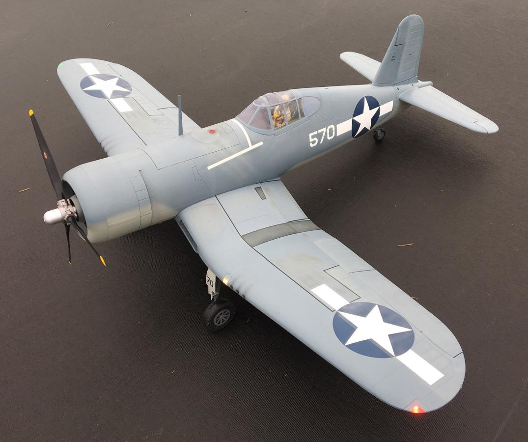

                                          Today I maidened two Corsairs! I flew Dad's first (I told him I could use the practice before trying mine). The fog took over two hours to lift this morning, so only one flight for each as the wind picked up and changed direction.
                                          I don't want to draw too many conclusions from just two flights -- but my impression is that the recommended CG is too far forward. We both found it necessary to add two weights (40gm) to achieve manual CG, but I'm thinking they can both weights can come out, as both planes required noticeable up trim.
                                          Mine has the 3.5" Robart wheels, which are 3 oz. heavier. I thought the two models would balance quite differently as a result, but inexplicably, they did not -- we both used HRB 5000s.
                                          I had more flap travel on mine -- I had repositioned the servo arms to allow for max travel, and notched the wing edge foam where the flap control horns made contact. I made about as perfect a landing right on the center line as I am capable of, and decided to stop while I was ahead (for today).
                                          I was super-pleased with how my F4U-1 flew -- very nice, and plenty of umph for vertical. Surprisingly there's not a whole lot of difference in level flight speed between half and full throttle -- or at least it seemed that way. I think the way to go is modest throttle until pulling vertical.
