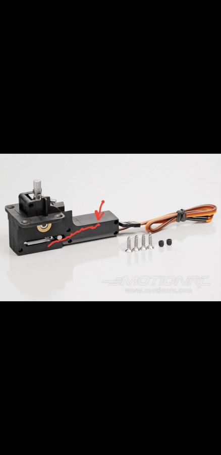

    I like the gear as well wheel and rod and strut are very stout but the controller is weak, I bought a set of spare controllers just in case I crack another I haven't even landed that hard or stalled the plane at all. That's why I was asking about the weight. Here is his video

                        I've had a couple of big retracts crack in that very same spot, back in the day when all my landings were quite hard on a rough field full of gopher holes. I rarely have hard landings now with my Corsair but it took a long time and a lot of practice to get it right. I'm not sure if this retract will work (hole spacing), but it may be the answer you are looking for:
                        https://www.motionrc.com/products/fm...-1700mm-planes
                        They are pricey. You'd need to make your own rotation pins. I bought one but have never needed it. I stopped landing hard after I bought it. I also recall a CNC side plates that was sold by a small machine shop catering to the RC hobby. I can't remember the name as it was some years ago.

                          It's SmallpartsCnc.com

                              Side plates. Can’t edit my post on my phone for some reason. But the whole plastic piece would be machine alumn.

                                  Aluminum units would be fantastic!!!

                                      Yes would love aluminum! That should have been what they were made of to begin with due to the amount of weight of the airplane. I may take 2 of the 4 ballast out as well.

                                          I have the aluminium side plates on both my 1400 FMS Cosair and my 1450 FMS P-51. They are great!
