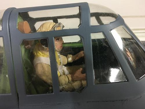

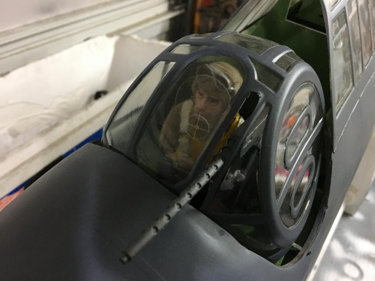

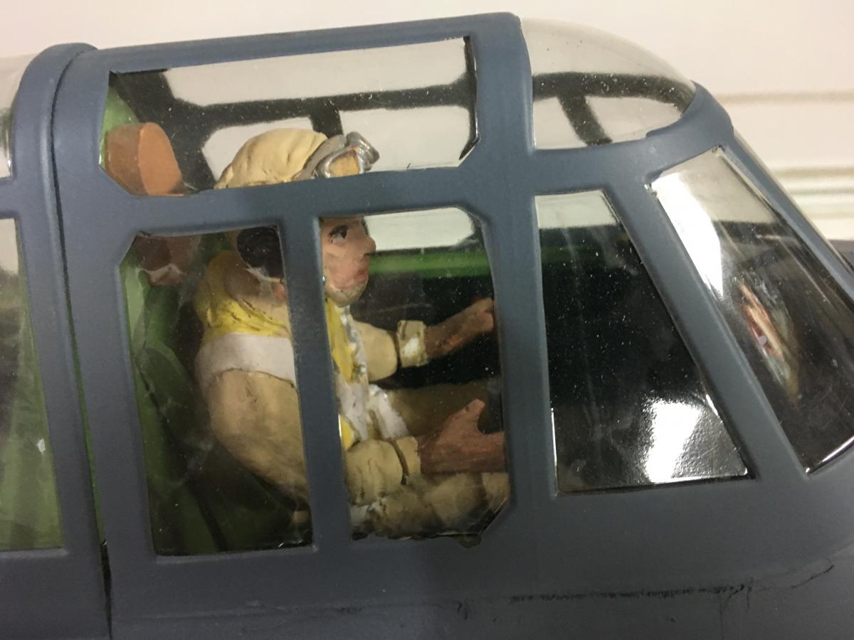

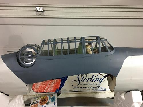

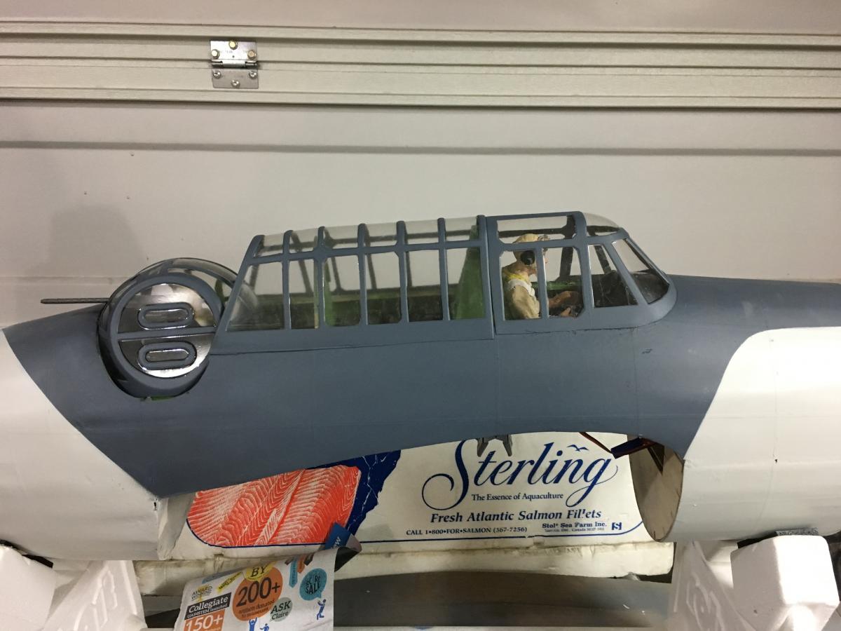

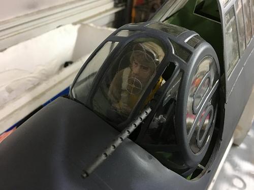

    Originally posted by theoldALFER
    Mike,
    i got my pilot from Mike Hicks. His company employs disabled veterans and as a Vietnam Vet, I appreciate that. Here’s his email: bmarkrc@gmail.com
    Check him out. My pilot came painted, so all I need to do is “personalize” him to my tastes.
    I've picked up several of his pilots. Pretty good to deal with.
