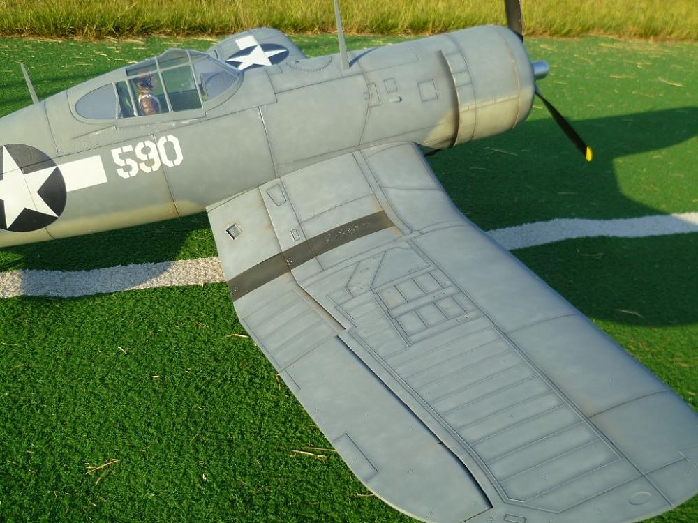

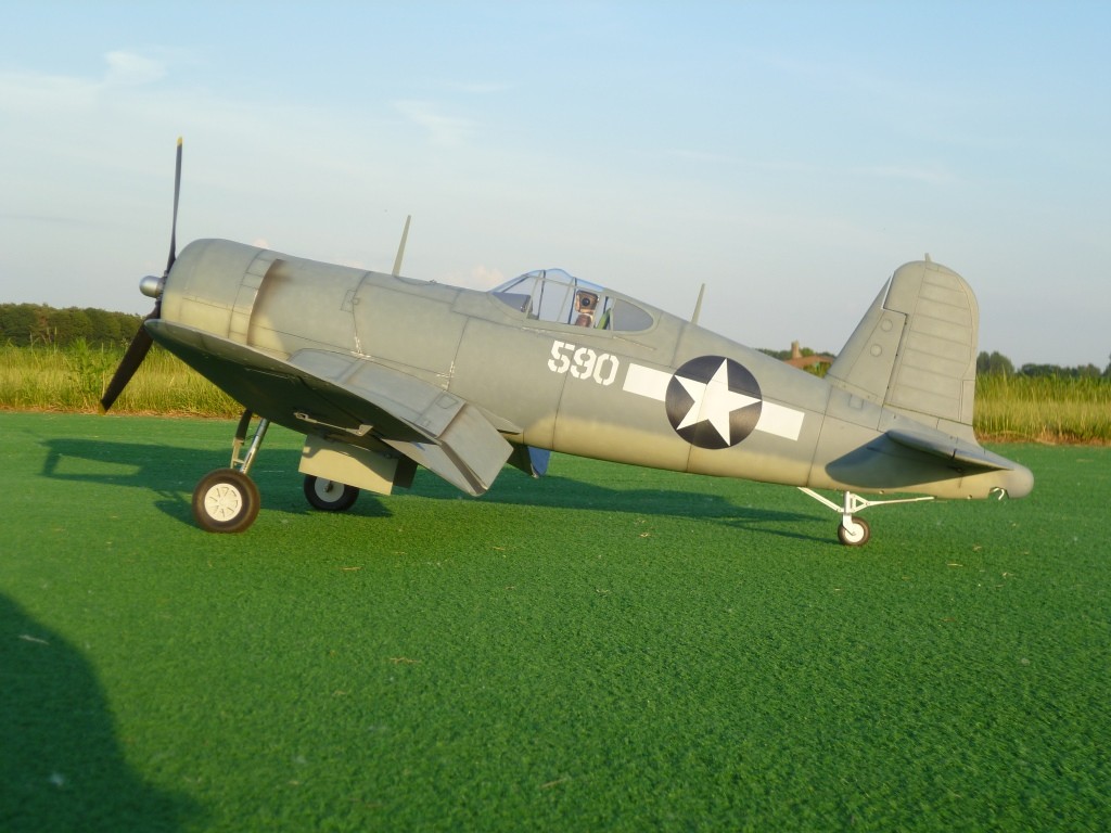

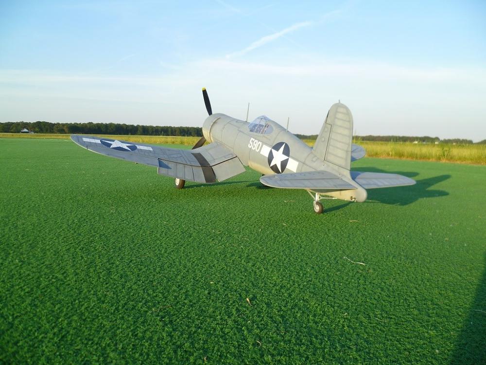

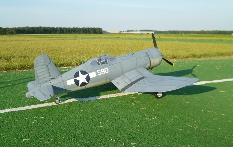

                                    #4577

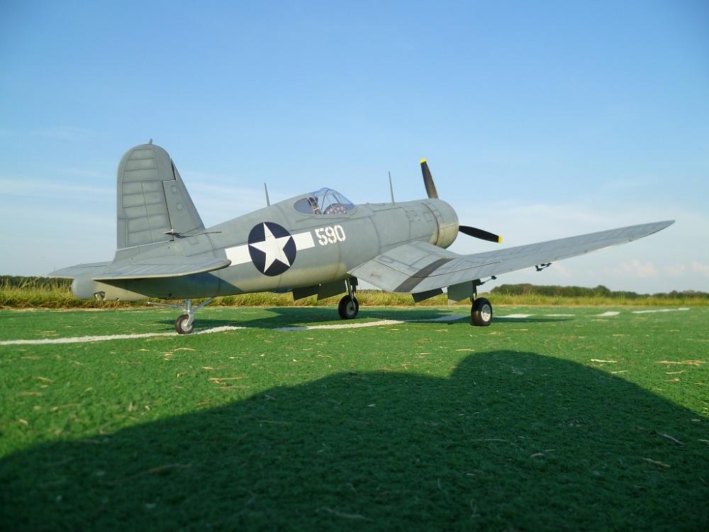

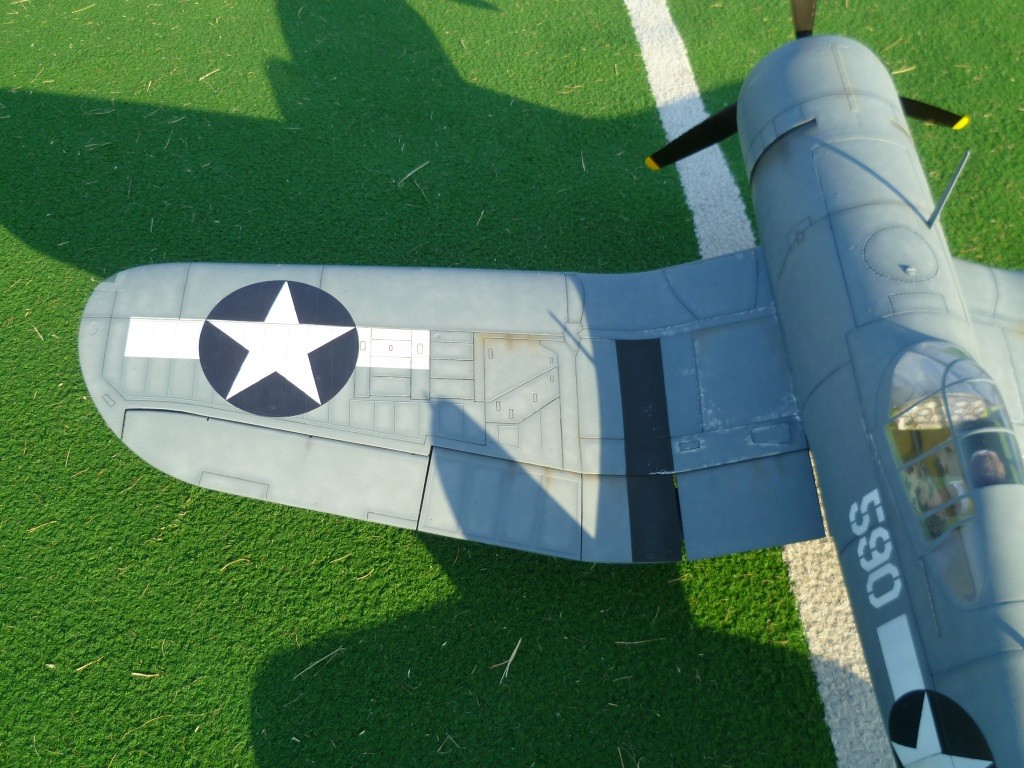

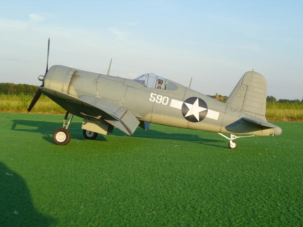

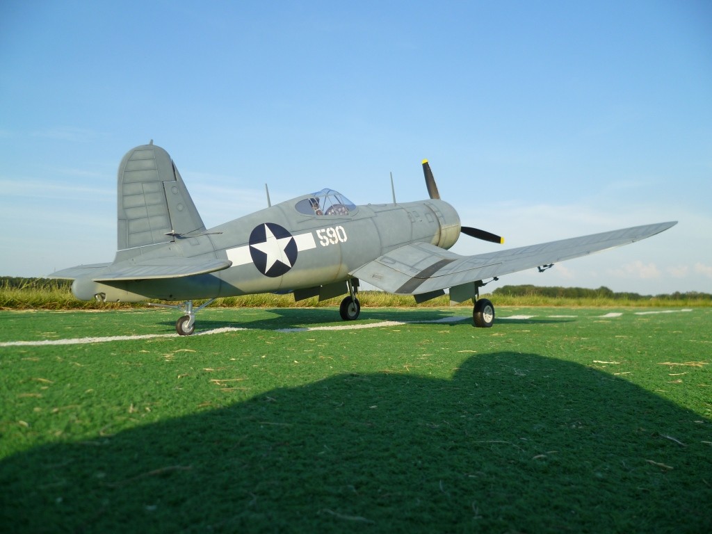

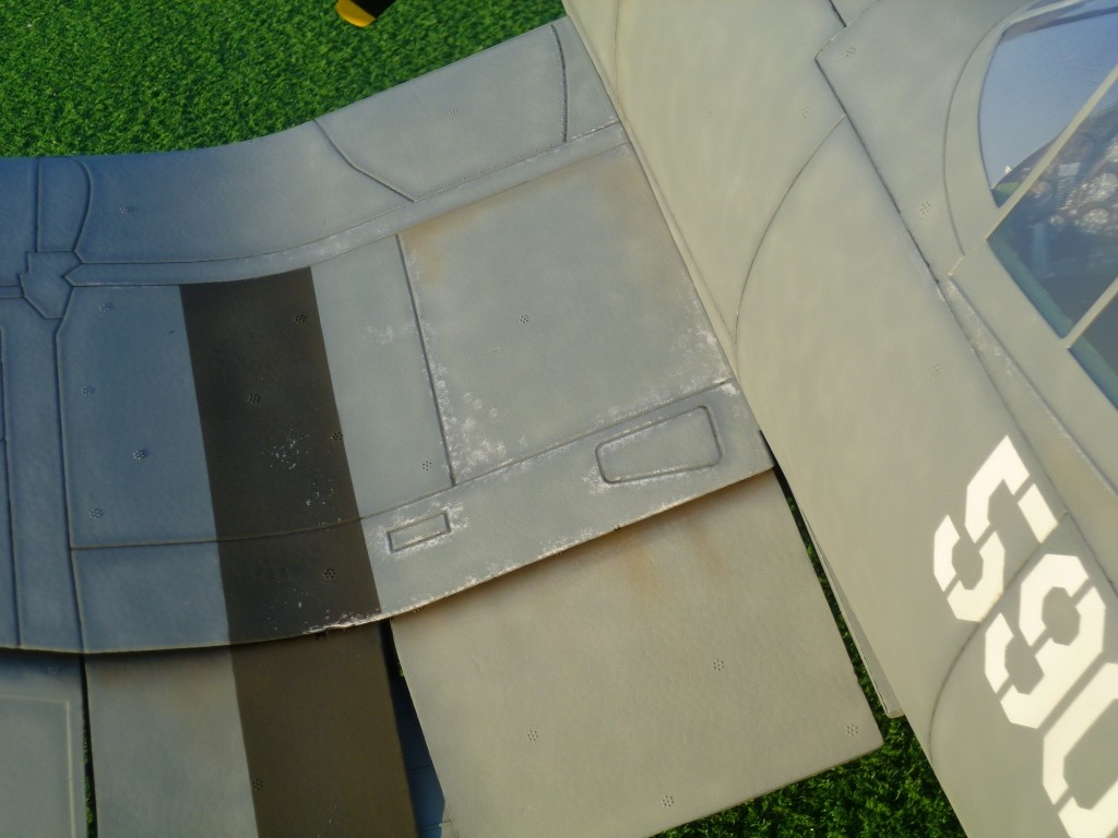

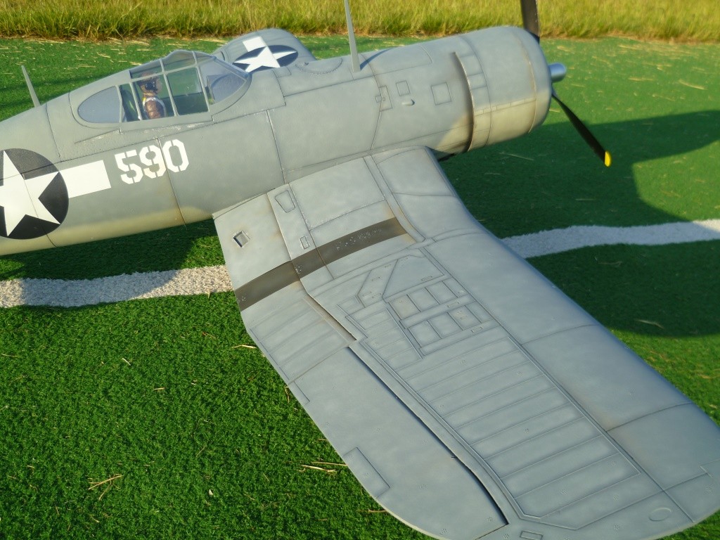

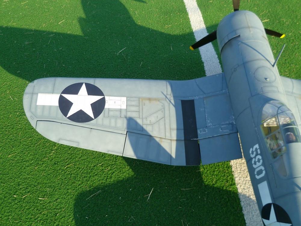

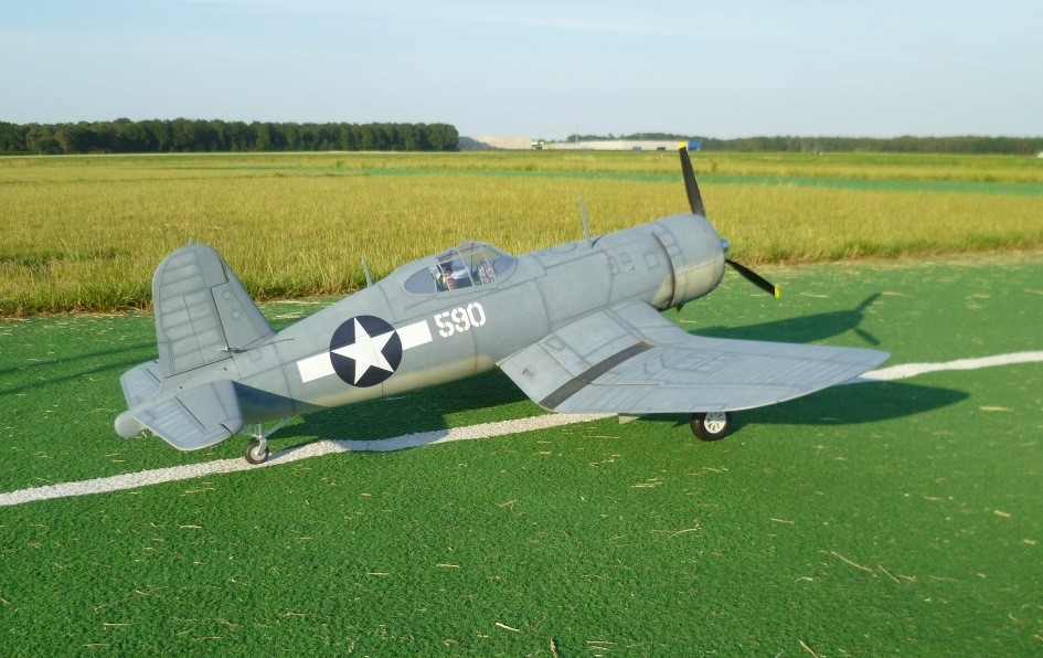

                                    Some of you might have seen it already on the motion rc community, here are some shots of my finished corsair
                                    When plastic modelling meets RC flying you get something like this. I've used many techniques from the plastic model guys, and it worked out great !
                                    All markings are painted as well
                                    Hope you like it..
                                    Regards,
                                    Didier

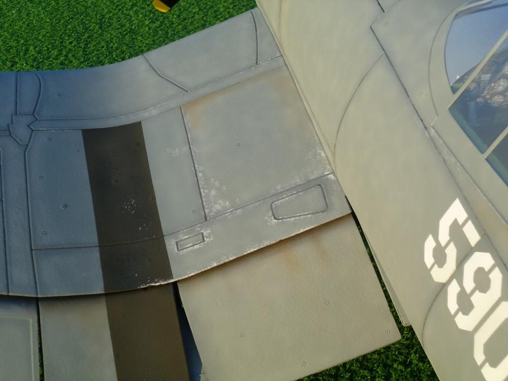

                                      #4578
                                      That looks fantastic didier n! What's your technique for the whitish wear areas around the trailing edge of the wing? Well done!
                                      • didier n
                                        • Oct 2019
                                        • 109
                                        • leopoldsburg Belgium
                                        #4579
                                        Thanks for the comments,
                                        That is actually chipped paint letting the aluminum shining trough. After painting the whole thing, i mixed aluminum paint and some black ( to make it less shiny), and carefully dabbed it on with a sponge... very simple, but needs some practice to get it right!
                                        Cheers!
