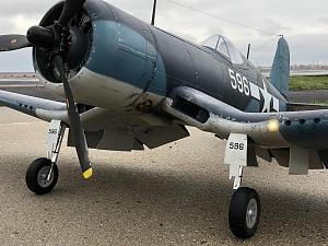

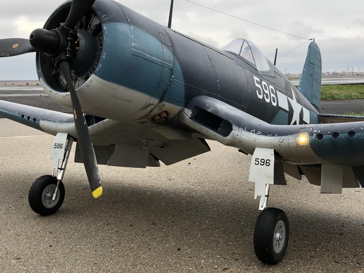

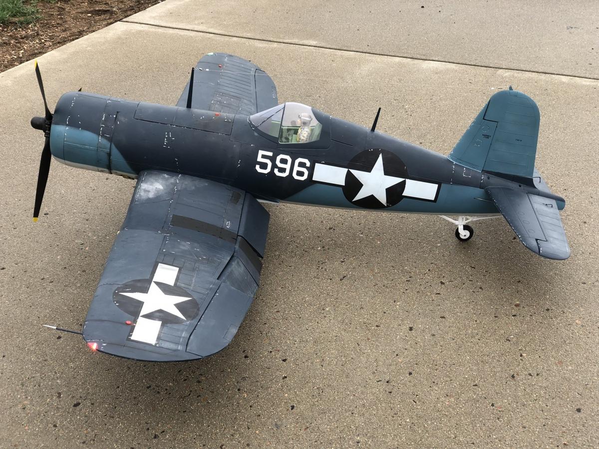

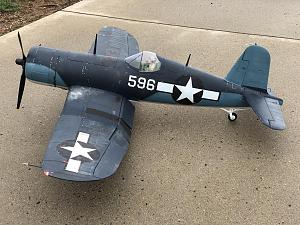

ID:	312499 I used to have one of these beauties, but unfortunately it went in a few years ago, not exactly sure why, now. But today, I decided to pull the trigger and buy one of the F4U-1A (bubbletop) Flightline Corsairs to fly again at my home field. I think I'll use the same paint scheme as I had last time, to honor Lt. Robert M. "Killer Bob" Hanson, USMC. He was the top ace in the Corsair aircraft with 25 kills. I'll attach a couple pics of my late plane, sigh!, but hopes for better times again with a new one!

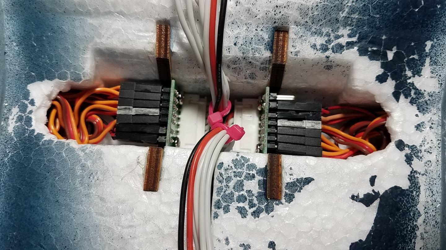

                                  OK, I was off by one spot. The gear servo wires plug in smack dab in the middle, surrounded with 3 plugs each fore and aft on the left wing. Same on the right, however, the furthest forward pin does not have anything plugged into it, so there's only 2 plugged in forward of it (but still 3 pins overall). You may want to remove a little foam behind where they plug in, as I did, so you can get at them and the wires a little easier. Also, you may have to pull some of the wire out a bit (without unplugging anything) as the extra length of the wires in jammed back in there and by pulling the "extra" wire out, you can straighten them a bit (and it will "unclog" the area some) and it will be easier to pull the old out and pull through the new servo/retract wire. Also, you will have to remove the gear door servos because the retract wire runs directly underneath it, through some small slots, and it will be much easier getting the old out and the new one in. I'd mark the plug again for future reference, as although I replaced retracts regularly when I first got this, since then I've got over 100 landings without a problem. However, noticed last time out they both were kind of wonky and jittery so decided to replace both as a "regular maintenance" item. All the landing pressure is solely on the retract worm screw and it wears down eventually, even with decent 2 wheel landings.
                                  In the photo, left is left and top is forward, bottom aft.
                                  After reading "Wildman"s post, I finally decided to tackle the issue of my left main gear which has been stuttering when deploying but smooth retracting. The design makes the job more difficult than it should be. Removing the retract and the gear door servos was easy enough, but disconnecting the gear servo wire plug and fishing the wire and plug back through the wing to the retract was a PIA. After removal, inspection of the retract revealed the case was cracked. I installed a new retract and again, fishing the wire/plug through the wing to the connector board was the most difficult part. In any event, the new retract works smoothly both deploying and retracting as it should. All's well that ends well. Thanks for the inspiration "Wildman".
                                    • 2716
                                    #4457
                                    I've found that if you tie a small, strong, string to the plug, then pull out the servo/retract that you are replacing, you can tie the new plug with that same wire and pull it back through. Kind of like electricians do with conduit so they can pull new electrical wire through it. It's a lot easier than running a wire with a loop on the end because the end always gets stuck or grabs other wires along the way. Took me no time at all to get the wire through and made it to replace the Corsair retracts, but then I've had a good bit of practice at it!
                                      I do that very thing when I have a servo or retract replacement.

                                        #4459
                                        I used thin fishing line but the plug kept getting stuck. Finally put tape on the edges of the plug narrowing down to the wire creating a beveled edge which didn't catch as much.

                                          Originally posted by davegee
                                          davegee Click image for larger version Name:	images.jpg Views:	0 Size:	11.5 KB ID:	312497Click image for larger version Name:	IMG_0360.JPEG Views:	0 Size:	237.2 KB ID:	312498
                                          I had to do double takes I thought that was full scale! Outstanding! Man I can feel your pain on losing her. So sorry to hear that.
