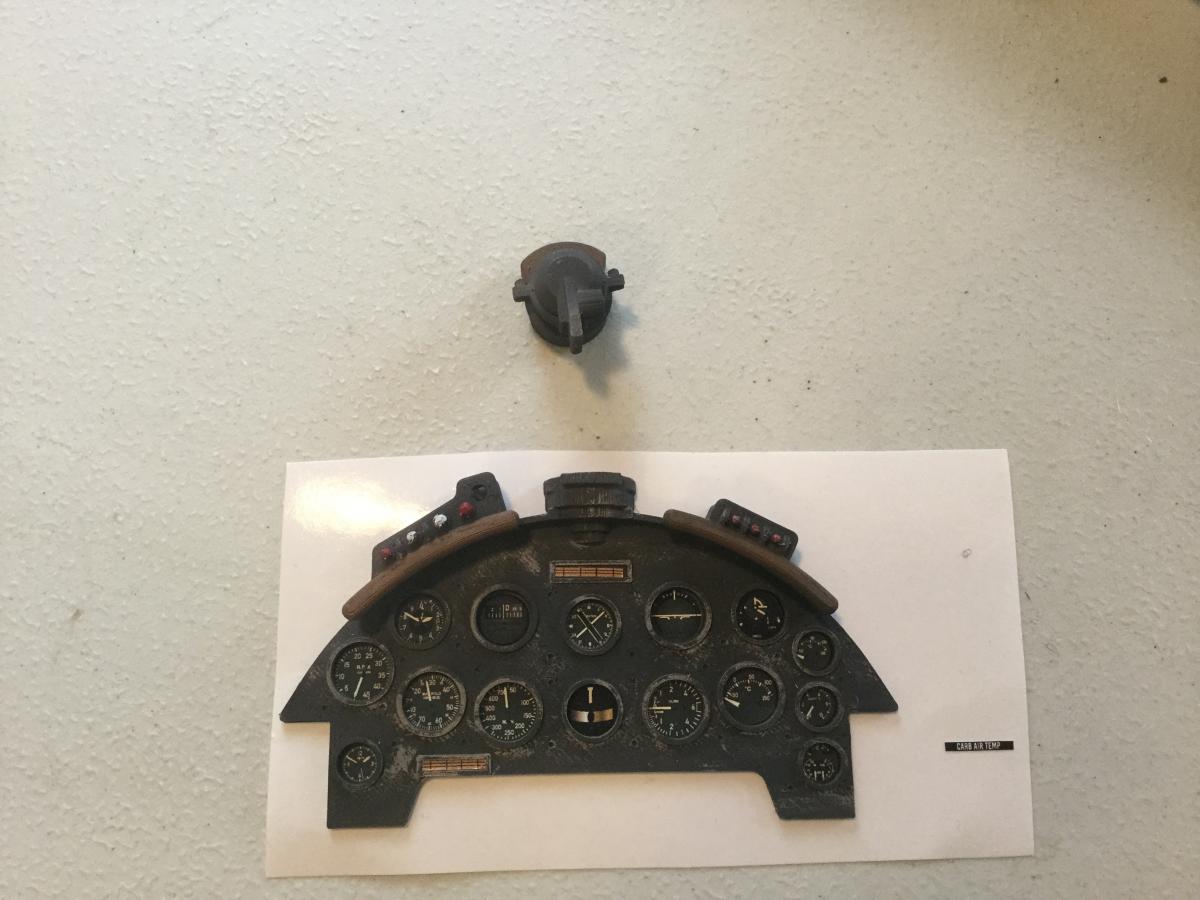

    • If you’ve installed the 3D cockpit, can you post a picture of your installation? I can’t figure out where the gunsite goes.
      • Answered on FB Dave.
        So the panel already contains a gunsight for one model of F4. The other one is for a different model. To use the separate one you have to cut out the one printed to the frame. After looking at some images on Google, I think the full panel is for the -1A, and the additional gunsight is for the -1D.
        • Thanks Pat, I found some pics in this thread and it looks like just what you said. I’m going to just use what’s already part of the panel and not use the extra gunsite that was printed.

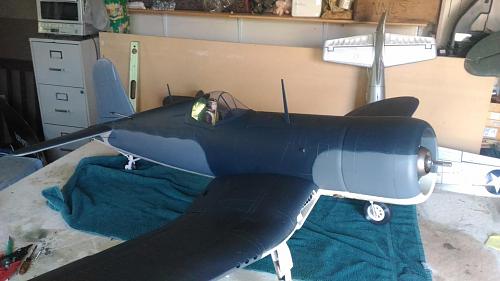

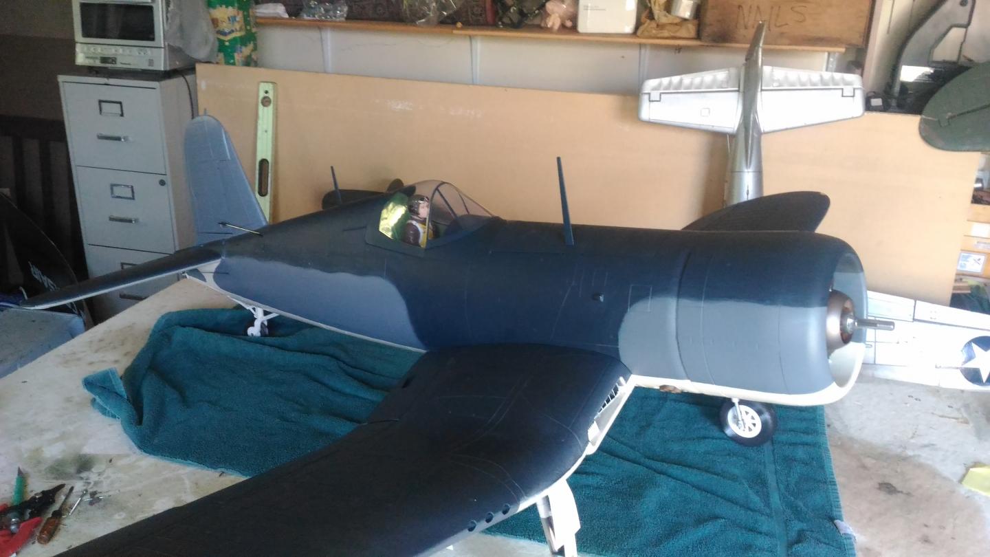

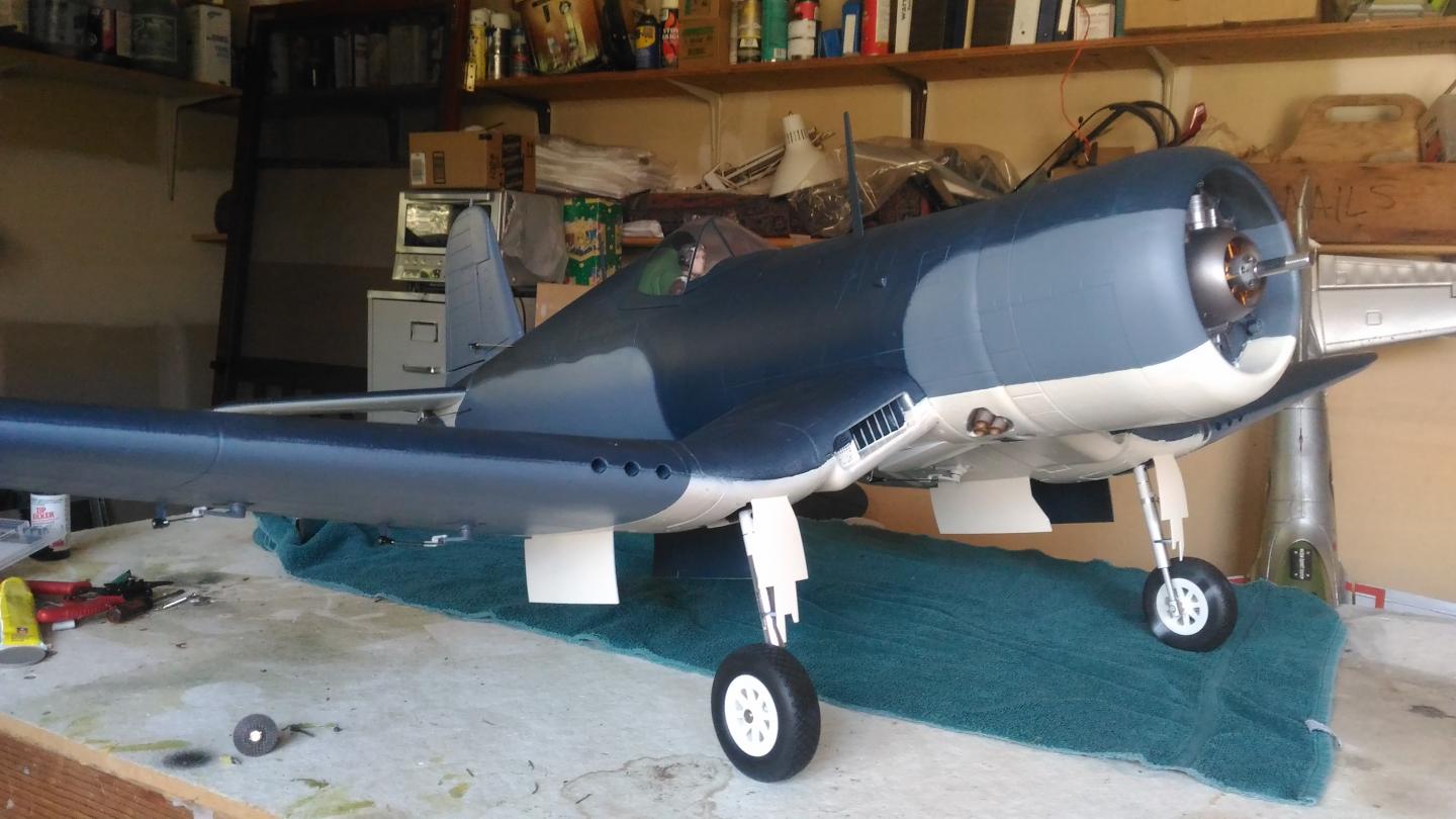

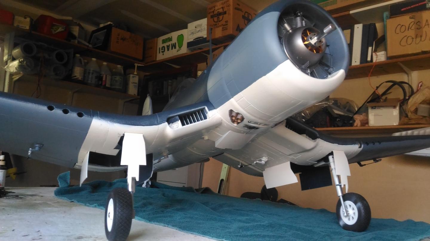

ID:	187652 Finally got the basic tricolor scheme done on the bubble top. Still some touchup to do but she's finally on her feet. Got paint on the tires through the gear doors but the Robart 3 1/2" new shoes are next. I used an antique white underneath as straight white just seemed to stark. Even this looks pretty stark in the pictures but oh well. It will probably calm down with some weathering.
                How did you paint this? spray? what did you use?
                • Originally posted by p51mustangman View Post
                  O.K. I sprayed the other two colors. I did the bottom part with an antique white from the hardware store first before the plane was assembled. I used the Model Masters Intermediate Blue using stencils held off an 1/8" to soften the edges and the rudder also before assembly. The dark blue was stock. For touchups, I just sprayed either the white or light blue into a paint cap and used a small artist's brush. I'm currently in the decal stage but progress is slow since I'm also working on the Raptor.:Cool:

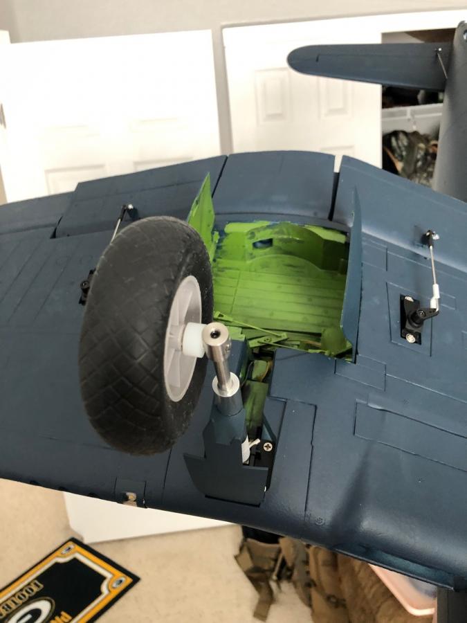

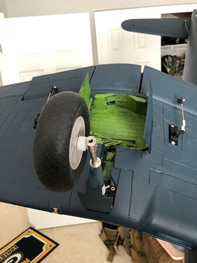

                  • I got my Robart 3.5" wheels...Can anyone either link to the post that talks about what all is needed for the mod or let me know? I tried searching but couldn't find the post(s) specifically...We need a more robust search engine, lol.
                      3.5 requires either cutting the axel a bit and creating a flat spot for the Allen screw to lay flat on OR I just went to a local hardware store and got a few nylon washers to shim it a bit. Diameter was a bit off but came out perfect. Click image for larger version

                      • they actually look like the prop adapters from the Pandora, which I have a bunch of and have used them for just that scenario
                        Grossmand56
                        • Thanks! I will likely go the washer route...What size did you get? Also it looks like a little dremel work is needed for it to fit in the wells?
                            no Dremel required. fits perfectly in mine. Sorry but I am not sure on the size, I just took the axel in with me to a ace hardware and tested them out
                            • Copy that...Thanks again.
                              • Interestingly, there was linkage on the real Corsair that compressed the oleo strut as it came up in the retraction cycle so it would fit into the wheel well. If you look closely in some pictures, you can see the vertical rod alongside the strut that pulled up the strut.

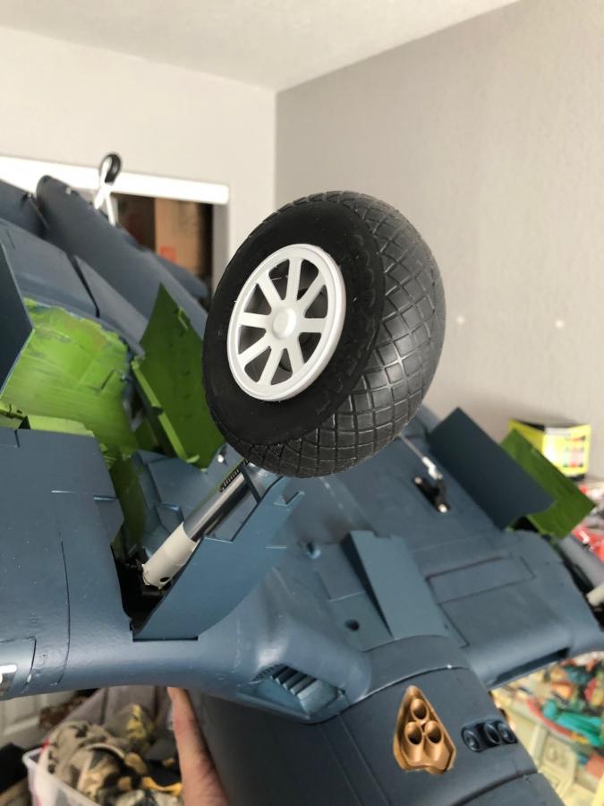

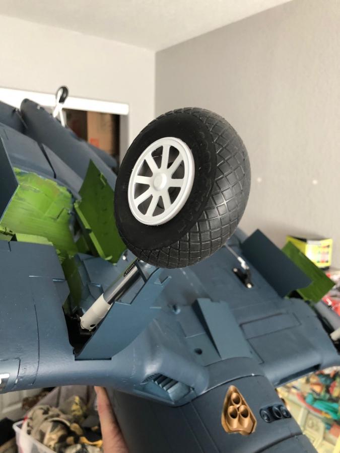

                                • Perfect! I was searching for this info last week and couldn’t find it. Here’s a photo of my WIP. I h Click image for larger version
ID:	189802 ave the wheel on hand but haven’t started the Mod yet because I was lacking this info.
