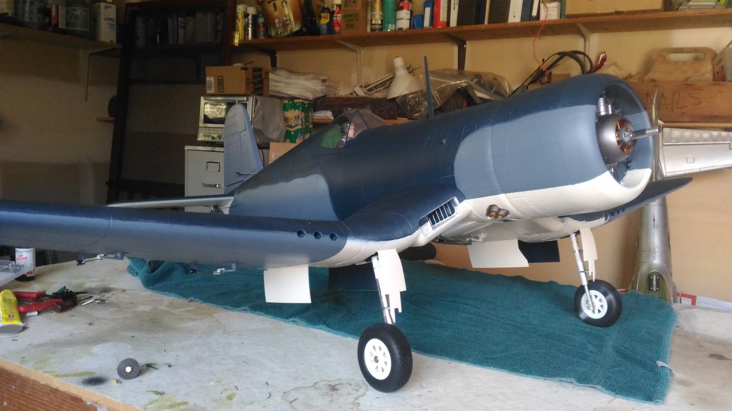

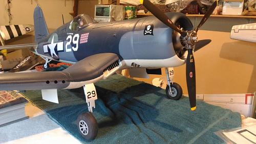

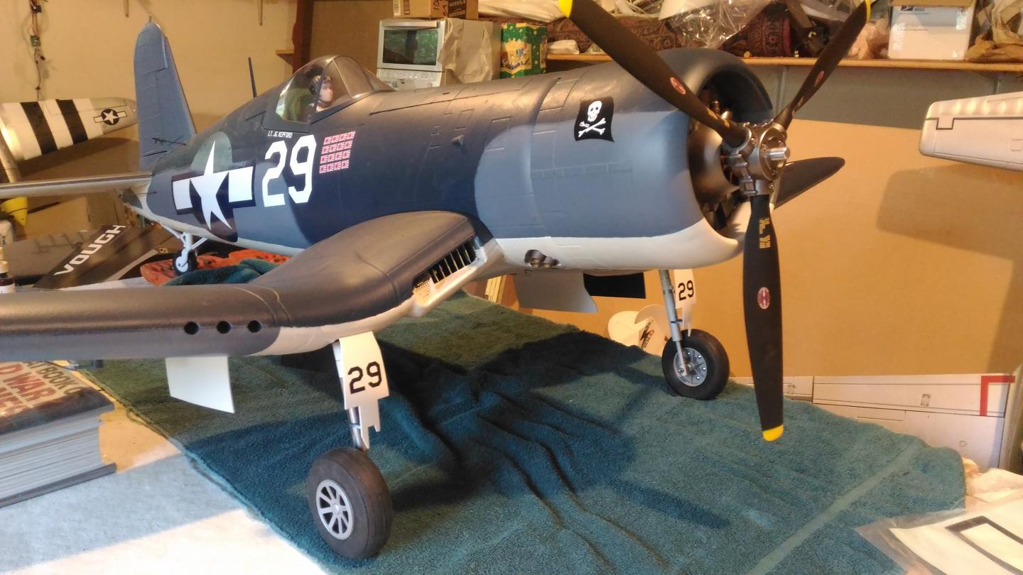

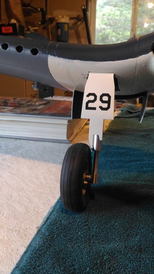

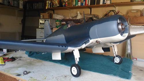

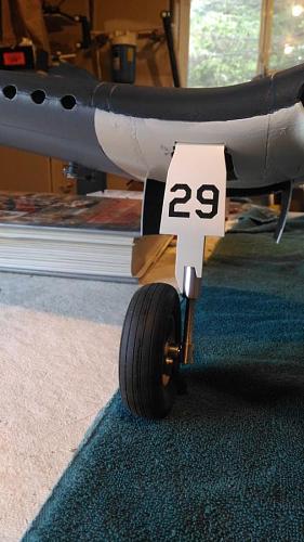

ID:	191184Click image for larger version  Name:	P_20190421_091737.jpg Views:	0 Size:	66.4 KB ID:	191186 O.K. here's a before and after of Corsair with some of the decals and the new Robart 3 1/2" wheels. I painted the wheel covers silver and put some flat black on the inner wheel for more contrast. Was going to use washers for spacers but wound up drilling out a couple of wheel collars and replacing the original spacers with them to make up the extra spacing needed...looked a little cleaner. I'm going to take the wheels off one more time to redo the wheel bushings. I drilled out the ones supplied with the wheels but they were to flimsy to drill out properly so the wheels don't spin as freely as I would like. I'm thinking of replacing them with brass tubing if I can get the right sizes. Next is the rest of the decals, a repainted prop hub, and some weathering. Gonna try something I learned from 70ragtop from the P-38 thread.

                                Ben you won't be disappointed. That much I know. Brad, the new wheels look great. I have mine in the que, still waiting to be brave enough to make the mod in case there are issues like you encountered. Looks great!

                                  Brad, those Robart wheels look awesome, but don't forget to re-check the CG as they're quite heavy.

                                    Good point. I actually haven't done the CG yet.

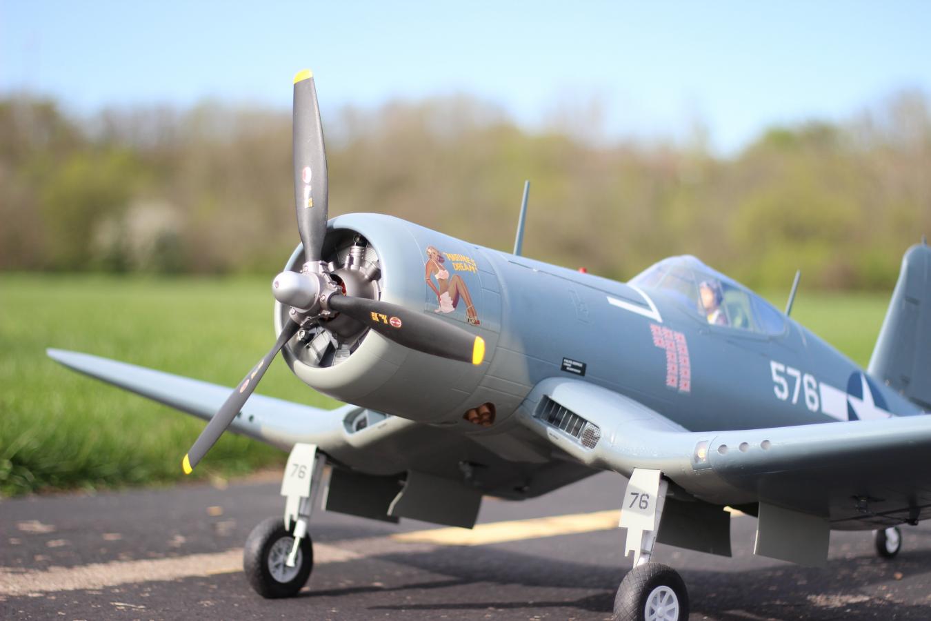

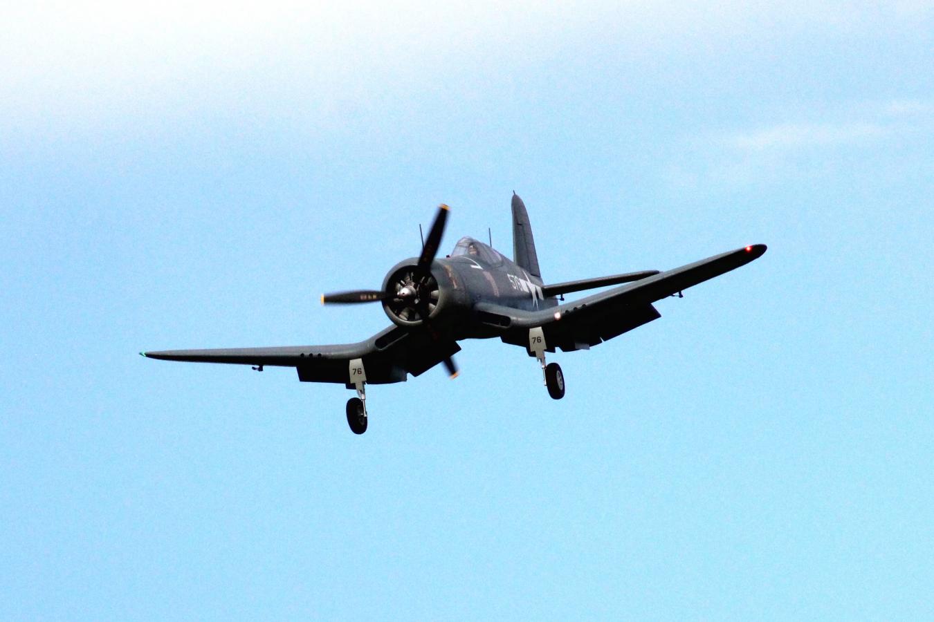

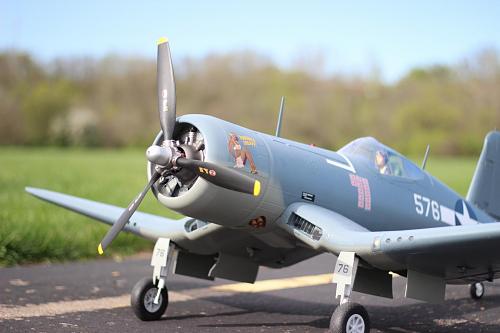

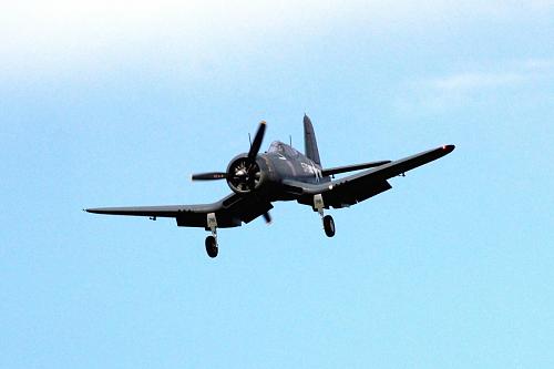

                                      I love Callie Graphics!
