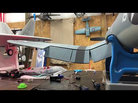

      Yea, I put together a small video showing my CG at 100mm/ 10cm with just a admrial (new battery) 5000 and it's very tail heavy. With gear up, added 1 weight, still tail heavy. I then added both again and it's very close to be level and nose heavy (where I want it) with the gear down.

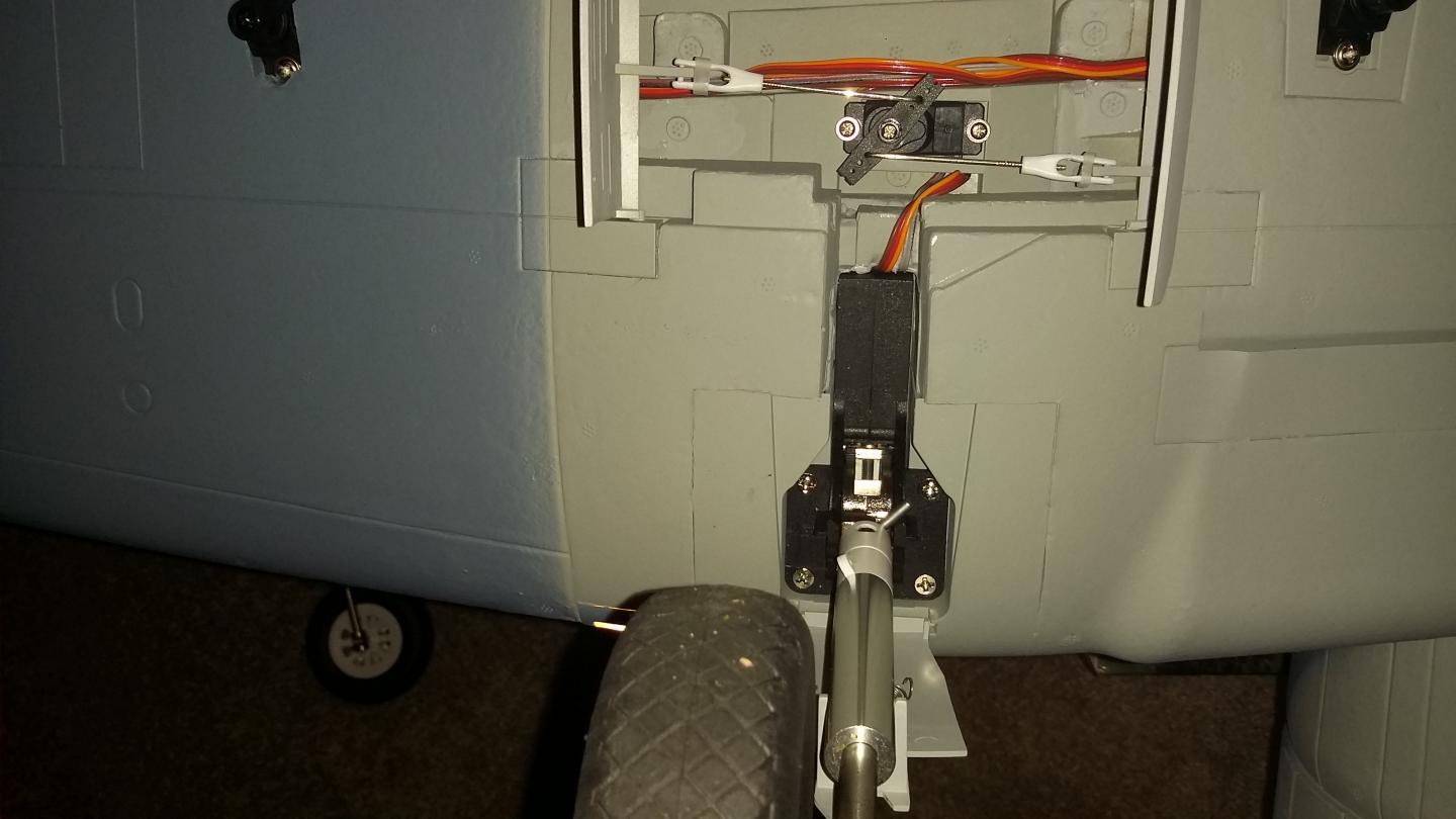

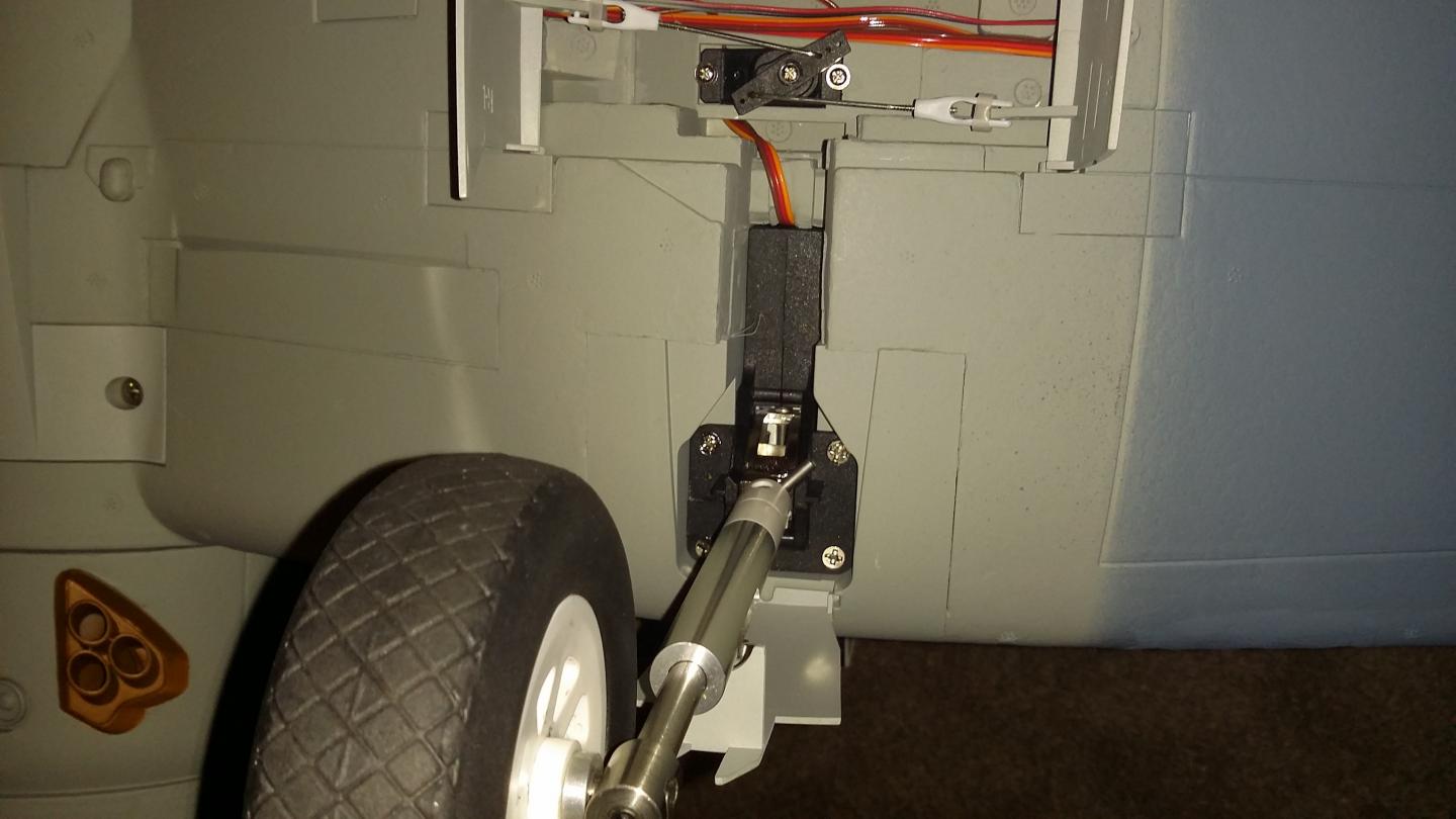

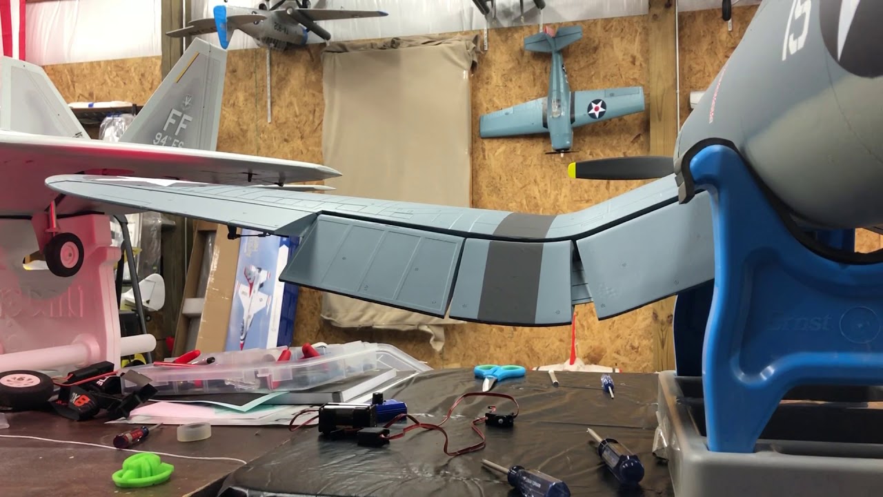

          I need some help i have got a very bad situation, i flew today after getting a new retract installed took off winds calm got up fine slight cross wind no problem there, look up at my retract wheels and i have either two right retracts or two left retracts i shook my head mid flight i just knew it was done for with the crazy cross wind and the wonky wheels but luckily i landed without breaking anything i did nose over and scuffed up my vertical stab but not bad at all. Can anyone take a picture of the retract while being retracted and lift the wheel shields with the spring up so i can see which way the pins are supposed to be while retracted to see which one is wrong.

            When deployed the wheels face the end of the wings
            left wheel roared clockwise and right rotates counter. This is when viewing from pilot seat

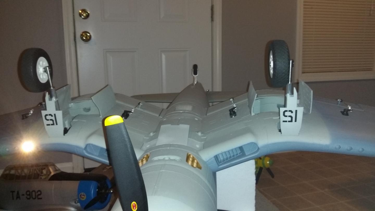

                  Some pictures

                    Originally posted by sethscorsair
                    Some pictures
                    The wheel cloesest to your blind is backwards.
                      I tried just flipping the wheel but the strut will bottom out on the gear door. The left retract is identical to your video however the right retract moves identical to the left.
                      • thisguy65
                        • 509
                        #2731
                        You'll noticeYea, you'll need to get the correct servo or the whole assembly. I just had to replace mine and why I made above.
                              I don't know if this will work for the FL Corsair, but with the FMS Corsair, it does. Have you tried "flipping" the whole strut and wheel assembly? You must be able to flip the part that has the rotation pin so that it contacts the rotation pin plate (on the retract housing) on the opposite side. These things have a LEFT and RIGHT main gear. Take a look at the following links. Notice the rotation pin is on opposite sides of the retract for each side. They must rotate opposite of one another as they deploy.

                                They sent me a right gear but the right gear is the one for the left wing. It was mis packaged i believe they are working on the mystery.

                                          hey seth, if you have your original (busted) retract, you can swap the assembly, which includes the pin that rotates at a 90 degree angle. I've had my junk retracts apart so many times i'm like a pro at it :P
