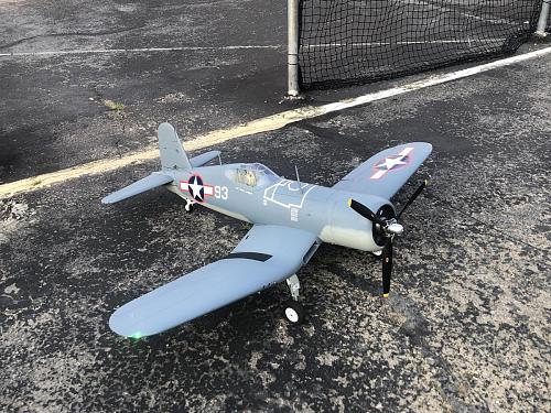

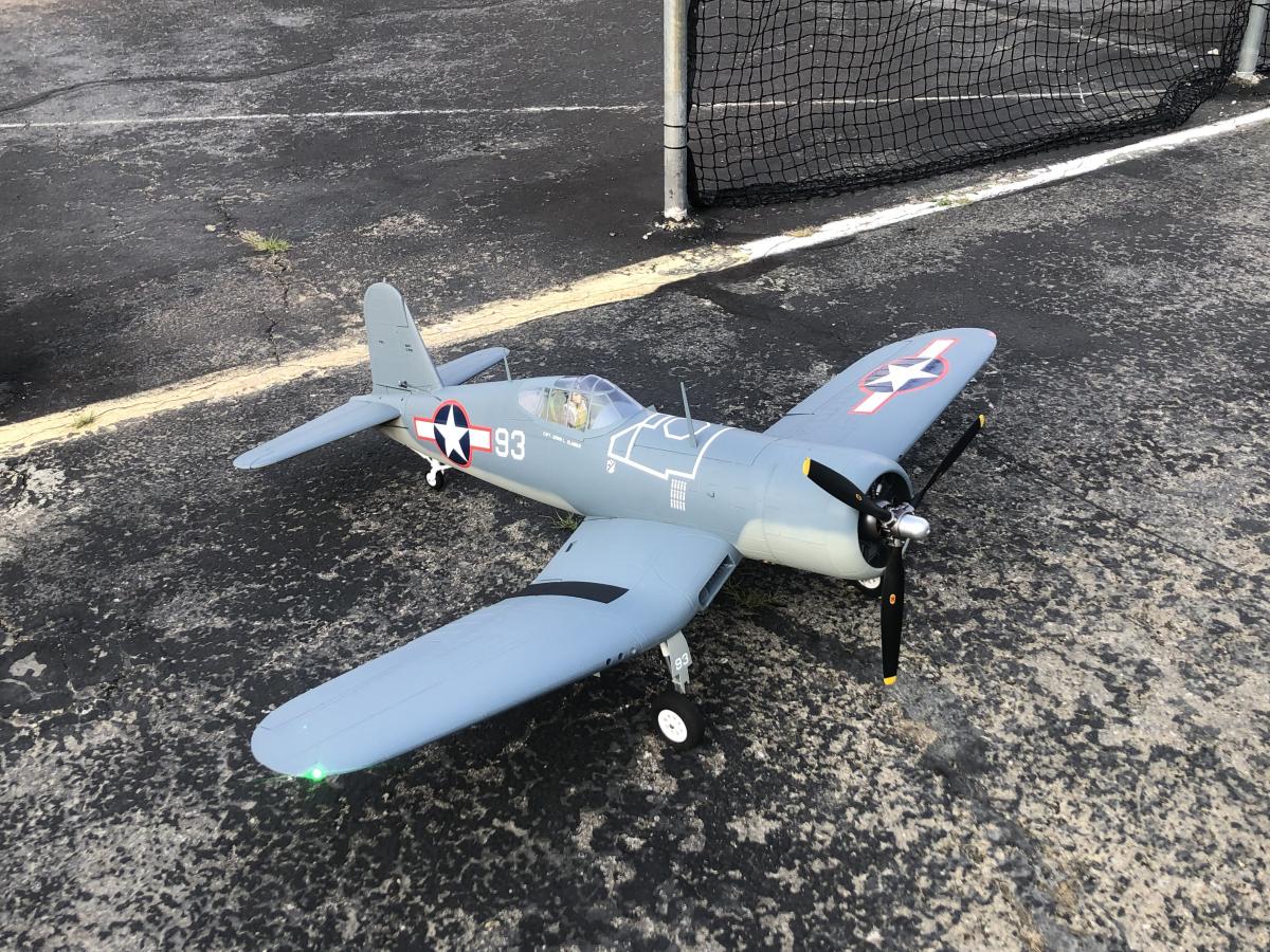

                                Hi guys, I finally got some flights in today on my Birdcage. I have a total of 42 flights so far. Today’s landings were good but I got one without a bounce! I’ll take that to the bank! Happy landings to all! Click image for larger version
                                  #2896
                                  Congrats! No bounce is always a great feeling!
