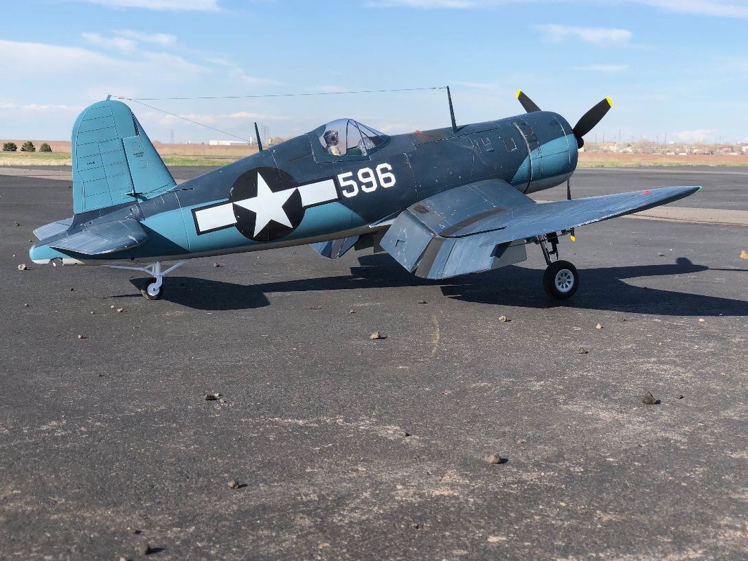

  • Had to do the tri-color...more weathering to be done but it's a start !
    • Looks great so far!
      • plus one on that!BTW the wing root intakes are usually white vs blue on the tricolor scheme for what it's worth.:Cool:Lets see how many want to disagreeLOL

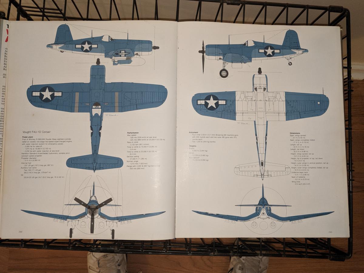

        • I guess it depends on who painted it. Most I have found, the top of the wing/intakes were dark,
          the bottom white.
          Some even showed the vertical fin dark blue as shown below but most were intermediate blue.
          The separation and coverage of the dark,intermediate and white varied as well.
          Tamiya models varied as did the real planes of the time.
          Tom

            Correct your documentation supersedes anything else in a contest. First rule of scale modeling.

            • I'm enjoying my Flightline Corsair very much, except for the landings. I have found for me and this particular airplane that I have a high number of "bounced" landings if I don't land absolutely perfectly. I don't have this issue with most other taildraggers, especially when they were heavier like the FMS P-51, P-47, and Corsair, all of which landed great.
              I'm wondering if the mod several folks have done with the Robart 3.5" wheels might help some?
              Another question I have is: how do you remove the axle of the main gear of the Corsair to then put the Robart wheel on? I have removed the set screw underneath of the strut that should release the axle to be pulled out, but it looks like it is flattened on the other end too so I can seem to be able to pull it out. Any help? Thanks, Guys!

              • DG, Don't have an answer, but wanted to say your Corsair looks awesome, Sir. Bravo Zulu. Best, LB

                  Just unscrew the set screw and pull on the axle.

                  • Actually I have found this Corsair to be quite easy to land (assuming you don't stall her a foot off the ground, ask me how I know, lol)...I use full flaps and keep the power around 25-30% depending on head wind and let her settle on her own...
                    PS...Your bird looks fantastic!

                      Hey dg, nice looking plane. You will have to apple some heat to get those axels out. Allot of them got a little too much loctite at the factory. I just used my plumbibg torch but a soldering iron would work as well. Hey Tom, I see you have the "bible"out. I would defer to that for sure. I was baseing my comment on a couple of Corsairs I took pictures of at Reno.
                      • Davegee.: Excellent job weathering and I love the tricolor scheme.
                        As far as the axle, I had to pry one side off by putting a screw driver between the strut and spacer on one side. The other side I grabbed the axle on the wheel side and rotated as I twisted it with a small pair of vice grips.

                            • Soldering iron heat makes removal of the axle easy. With the robart wheels, they seem to absorb landing shock well. I haven't flown mine with the stock wheels but even on not so perfect landings, mine doesn't bounce, or if it does it is minimal. Be ready to add nose weight if you use the robarts since there is a considerable weight difference.

                                        Thanks, Tom. It took a lot of "convincing" the axle to come out, but I finally got it!
