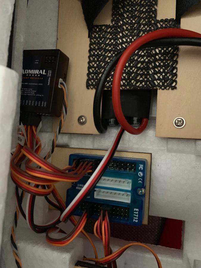

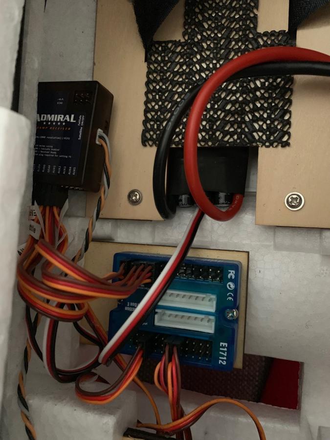

                Firstly, I am sorry about your crash. based on your video, I could not see the underneath side of your plane. It did not appear that your gear was all the way down before loosing the elevator control? That is definitely a bummer. I cycled my landing gear higher up before doing my approach for the first time on my maiden. I noticed the gear deploys with about 6 second delay. I cannot explain why you lost control of your elevator.
                As you will remember, the elevator servo plugs directly into your receiver and not the blue box. there no reason for this to fail other than a possible ESC brown out type of situation? The elevator servo is not connected through the blue box...
                What do you think?
                this is a photo of my receiver connections to the blue box for reference.
                All the best
                Rich
