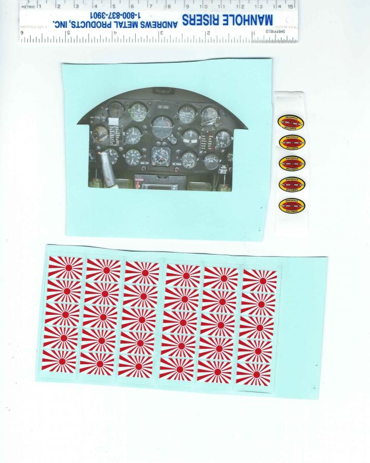

                                This was scanned as an 8 x 10... Instrument panel with additional decals to ensure scale is correct.

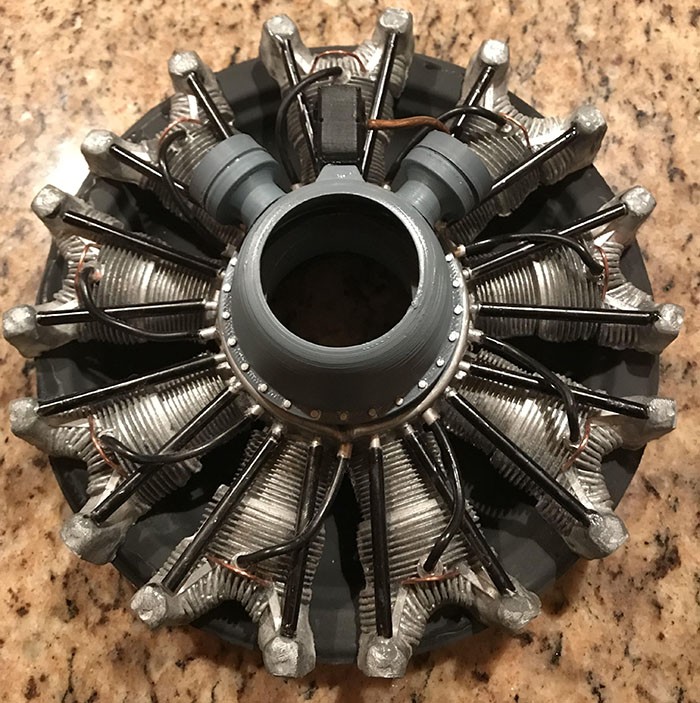

                                    I used 3/16 aluminum tube filled with sand n bent, 14 gauge copper wire for the ignition wire harness. 44 1/16 holes had to be drilled to accommodate all the wires.
                                    Everything fit so snug it probably didn’t need the epoxy on the backside...
                                    Not perfect but at 70mph it’ll do.
                                    Sorry, no 3D files here. :)

                                        I used 3/16 aluminum tube filled with sand n bent, 14 gauge copper wire for the ignition wire harness. 44 1/16 holes had to be drilled to accommodate all the wires. Everything fit so snug it probably didn’t need the epoxy on the backside...Not perfect but at 70mph it’ll do. Sorry, no 3D files here. :)

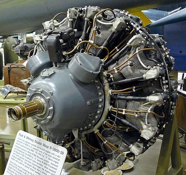

                                        Nicely done!! Ah man, I did something similar for my ESM Corsair but now you have me thinking I will be doing the same to this one! Nowhere near technically accurate but like you say, at 70mph it will do! LOL
                                        Click image for larger version  Name:	radial20.jpg Views:	1 Size:	166.1 KB ID:	174550
