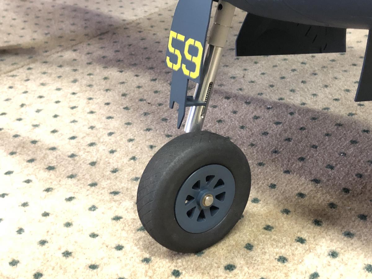

            I've had several questions about what wheels will fit on the F4U so I put this together...
            I usually keep a set of 2.75" through 4" Robart Diamond thread on hand I like them so much :o
            To recap, the Flightline Corsair and Tigercat have 5.1mm axles and the only difference between their wheels is the color (blue and white).
            The FMS Tigercat Wheels are actually a little smaller that the Flightline wheels and the FMS axle is only 4.95mm.
            Stock Flightline wheel is 3.375"
            Stock FMS TC wheel is 3.25"
            The Robart 3.5" wheel will fit but the axle will need to be shortened and new flat cut in it.
            The Robart 3.75"wheel will also need the axle mod and may require some reworking of the gear door servo linkage.
            The Flightline wheels weigh 28g
            The FMS TC wheels weigh 30g
            The Robart wheels weigh 74g
            I think the 3.5" Robart is the sweet spot for this plane and even though it is much heavier it still has good cushion. The added weight doesn't bother be as I like the feel of it with the heavier Admiral Carbon 5100 much better.

            Great detail TI, Thanks! That Robart 3.5" wheel looks so much nicer too! This may be a dumb question but I assume if we go with your recommendation for the Robart 3.5" wheel it will fit nicely in the wheel well or is some mod required?

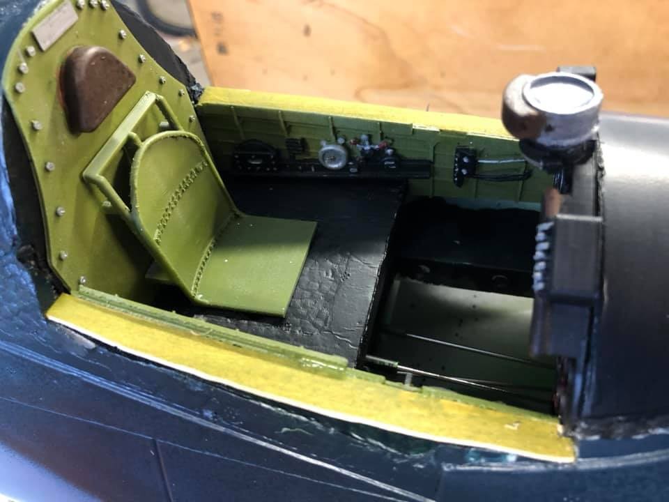

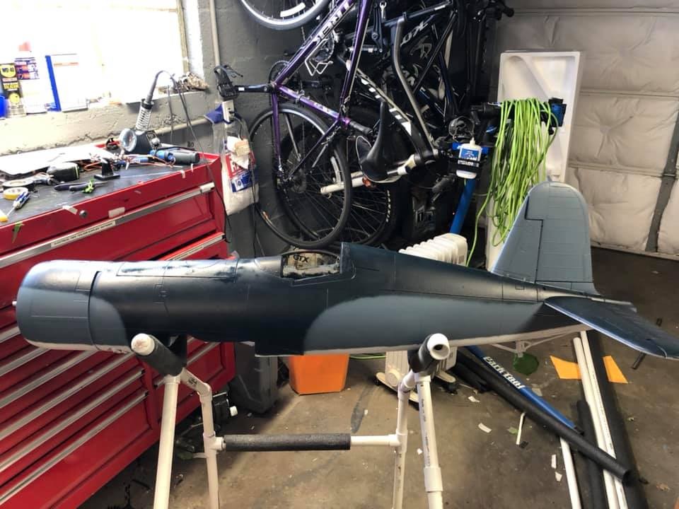

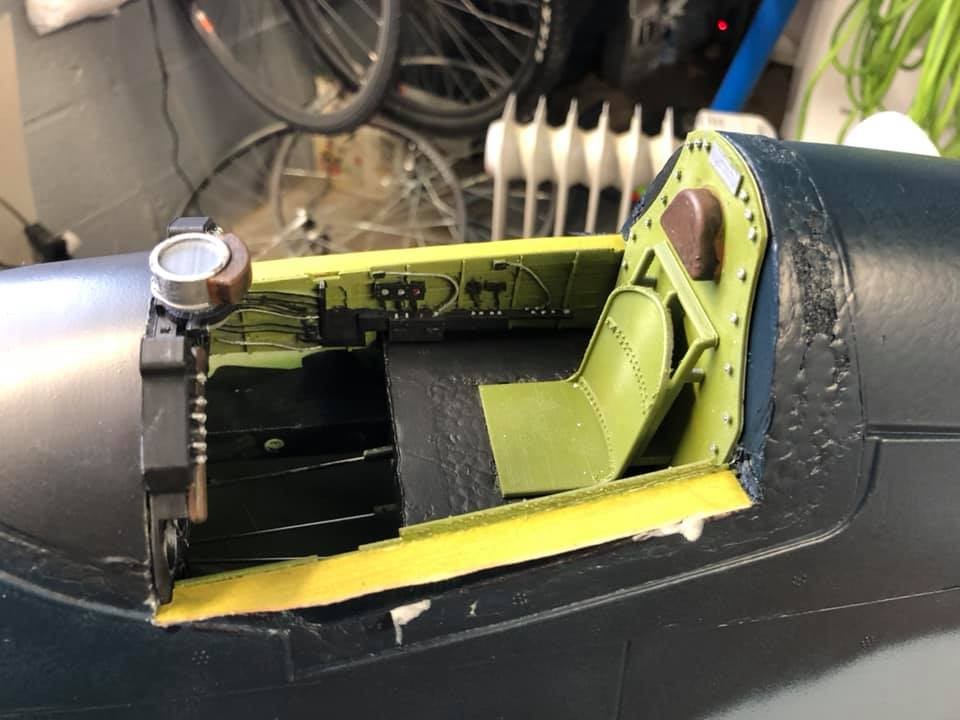

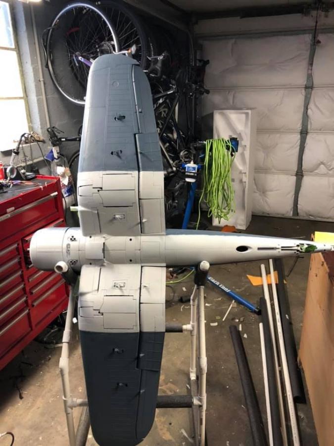

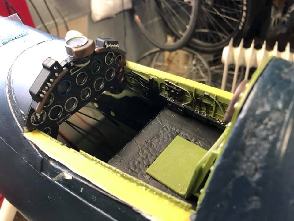

                                I got my Corsair this weekend and got to start working on it. I am painting it in the three color scheme and have decals on the way from Calie Graphics for the plane of Ira Cassius Kepford of VF-17. I got most of the plane painted up and am now working on getting the 3d printed cockpit parts installed. I am having to a bit of modifications to get them to fit. One thing that is bugging me is the two cockpit pieces on the sides extend above the foam and the back side can be seen through the canopy. I was thinking I would have to mod the canopy a bit in order to hide this. Anyone else have this issue?
                                Click image for larger version  Name:	f4u corsair1.jpg Views:	1 Size:	130.4 KB ID:	173623Click image for larger version  Name:	f4u corsair 2.jpg Views:	1 Size:	79.7 KB ID:	173622Click image for larger version  Name:	f4u cocpit3.jpg Views:	1 Size:	91.7 KB ID:	173621Click image for larger version  Name:	f4u cocpit2.jpg Views:	1 Size:	94.8 KB ID:	173620Click image for larger version  Name:	f4u cocpit.jpg Views:	1 Size:	85.2 KB ID:	173619
                                  Fits perfectly :Cool:
                                    Tim K - Nice work there cowboy! Looks like you didn't have any issues removing the canopy. How did you do it? What tools and release agent did you use? Thanks!
                                        TI - Great! I just ordered a pair from MRC and should get them about the time my Bubbletop arrives. :Cool: BTW - In terms of weight, the Robart wheels are 2.64X heavier (74g) as compared to the FL Corsair stock wheels (28g). In your opinion, could the weight increase contribute to potential problems with the retracts? I'd be interested to know what the specs call for along w/ the tested cycles. Hope they can handle the load increase w/o any long term ill effects but at some point I'm sure the increase load over normal cycles may require a beefier retract? What say you?

                                          Originally posted by Tim K
                                          I got my Corsair this weekend and got to start working on it. I am painting it in the three color scheme and have decals on the way from Callie Graphics for the plane of Ira Cassius Kepford of VF-17. I got most of the plane painted up and am now working on getting the 3d printed cockpit parts installed. I am having to a bit of modification to get them to fit. One thing that is bugging me is the two cockpit pieces on the sides extend above the foam and the back side can be seen through the canopy. I was thinking I would have to mod the canopy a bit in order to hide this. Anyone else having this issue?
                                          TK, I like the Tri-Color, big time. As for your cockpit, it looks like you've already added some extra material to the cockpit sides to increase the height, so does the portion of the canopy that's OEM painted NOT cover the exposed 3DP cockpit panel and any material you have added? Am I seeing this correctly? Best, LB
