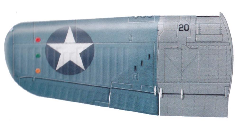

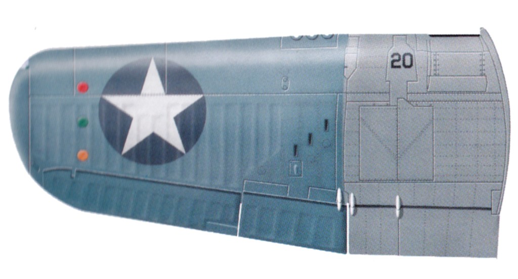

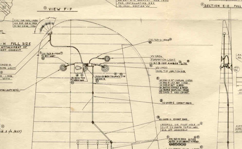

        Do not see where those red/green/white dots (decals) go? Must be for some cap or inspection port ?

          Formation lights on the bottom of the wing! Let me find a reference picture!!! Glad you are here on the Squawk... I have to cut up a brisket that just came off of 12 hours on slow heat!!! Please stand by!!

                    Here is where I think they go... Hope this helps!! :-) ;)

                            Under the right wing, I'll get an image for you...

                              • Nice picture Beeg.

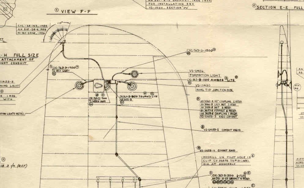

                                The red, green, and amber lights on the lower right wing were Aircraft Recognition Lights so the colors of the day could be flashed recognizing the aircraft to ground gunners as Friendly not Foe, early IFF...
                                • Originally posted by Ole-Timer View Post
                                  Nice picture Beeg.

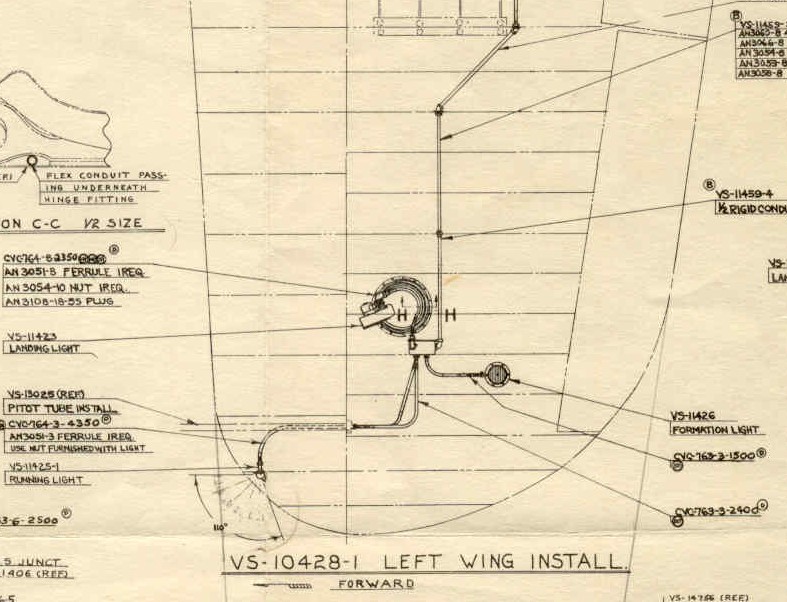

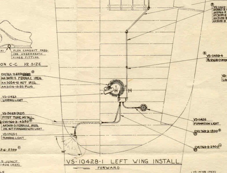

                                  Yes. Technically the the red, green, amber lights were the recognition lights located only on the bottom right wing. The "Formation" lights, on the wing, were amber and located on the tops of both wings.

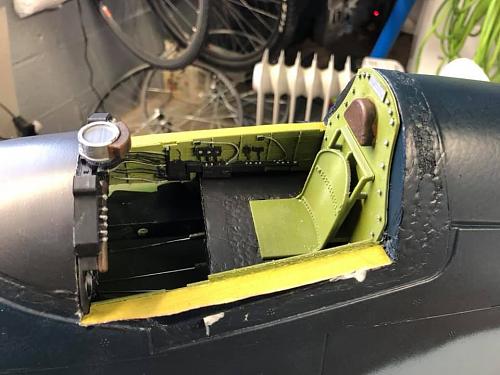

                                    Tim K - Nice work there cowboy! Looks like you didn't have any issues removing the canopy. How did you do it? What tools and release agent did you use? Thanks!
                                    I scored around the canopy with an x-acto and then pried it up. I came back later and touched up the paint.

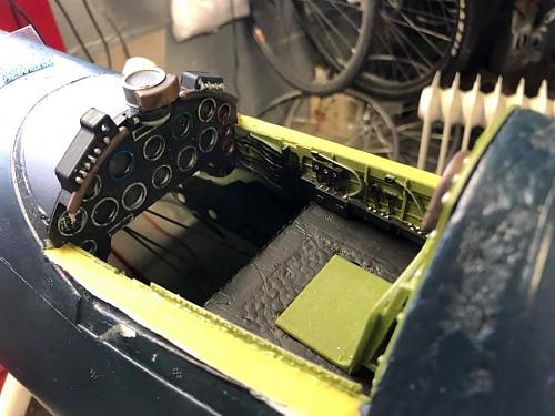

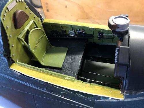

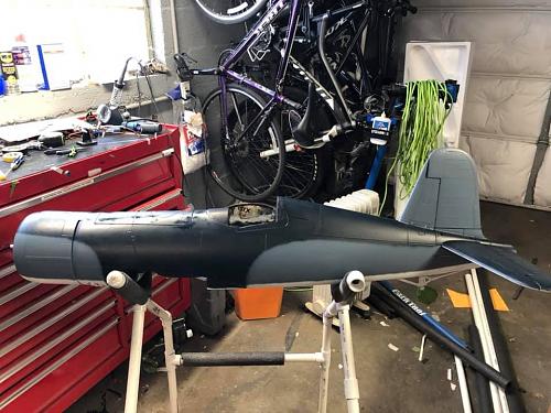

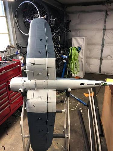

                                      I got my Corsair this weekend and got to start working on it. I am painting it in the three color scheme and have decals on the way from Calie Graphics for the plane of Ira Cassius Kepford of VF-17. I got most of the plane painted up and am now working on getting the 3d printed cockpit parts installed. I am having to a bit of modifications to get them to fit. One thing that is bugging me is the two cockpit pieces on the sides extend above the foam and the back side can be seen through the canopy. I was thinking I would have to mod the canopy a bit in order to hide this. Anyone else have this issue?

                                        Very cool information and history. I did not know that on those lights. I love these bits of information. Thanks for sharing!
                                          TK, I like the Tri-Color, big time. As for your cockpit, it looks like you've already added some extra material to the cockpit sides to increase the height, so does the portion of the canopy that's OEM painted NOT cover the exposed 3DP cockpit panel and any material you have added? Am I seeing this correctly? Best, LB
                                          Yes the sides on the 3d cockpit are higher than the painted parts on the canopy so you see the back of the panel. I am going to modify the canopy to add some additional canopy frames at the top so I will adjust the bottom frame up to cover when I do it. Im just waiting on my decals from Callie to finish this up. I am looking at least a week of crappy weather before I could maiden it anyway so no hurry.
