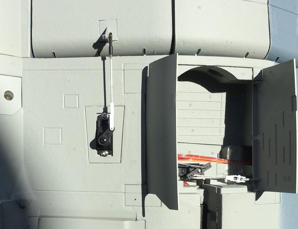

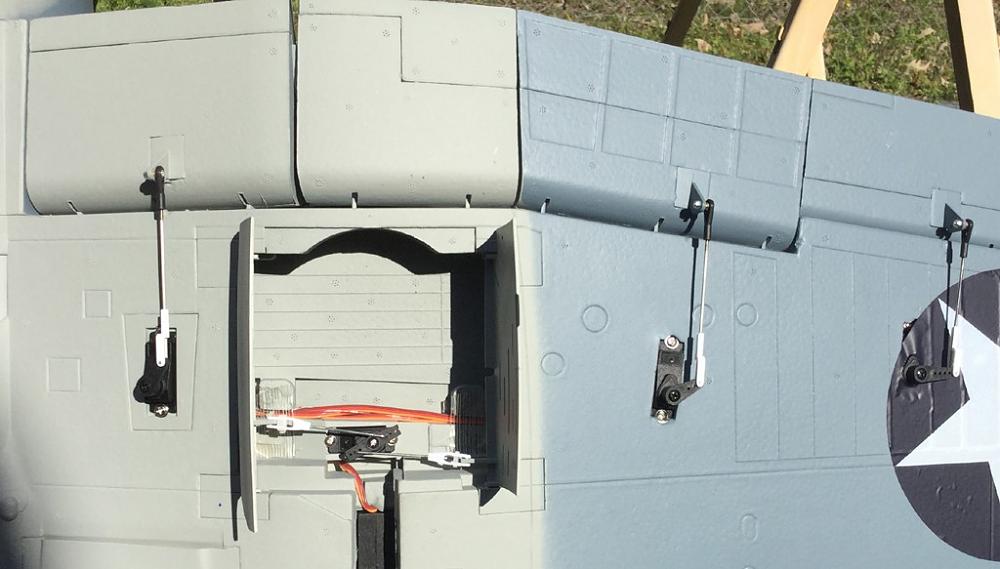

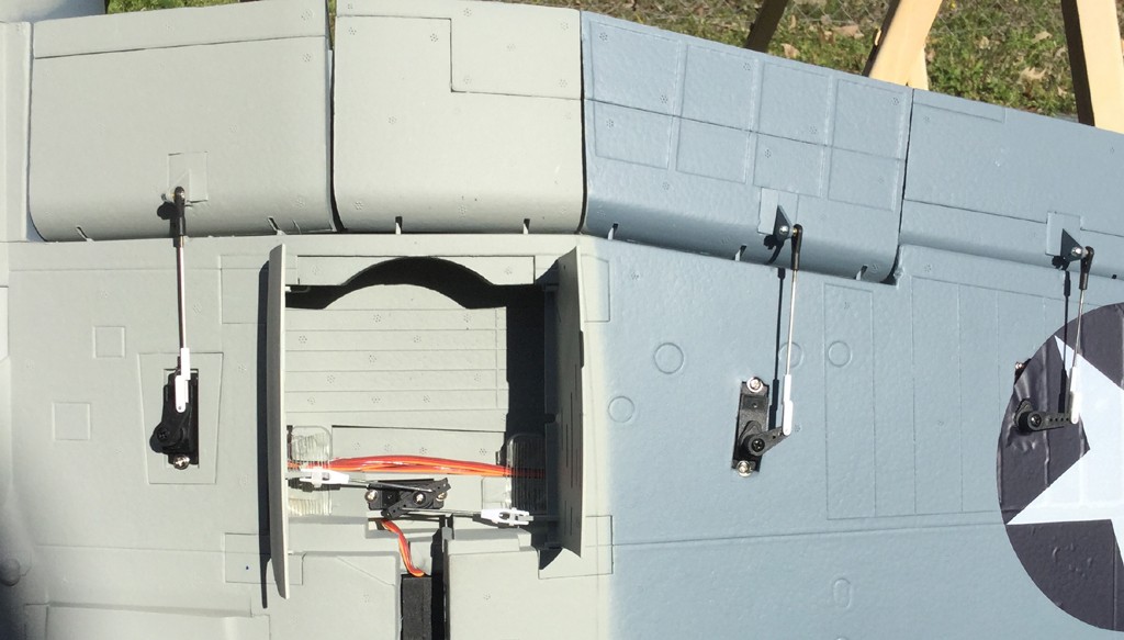

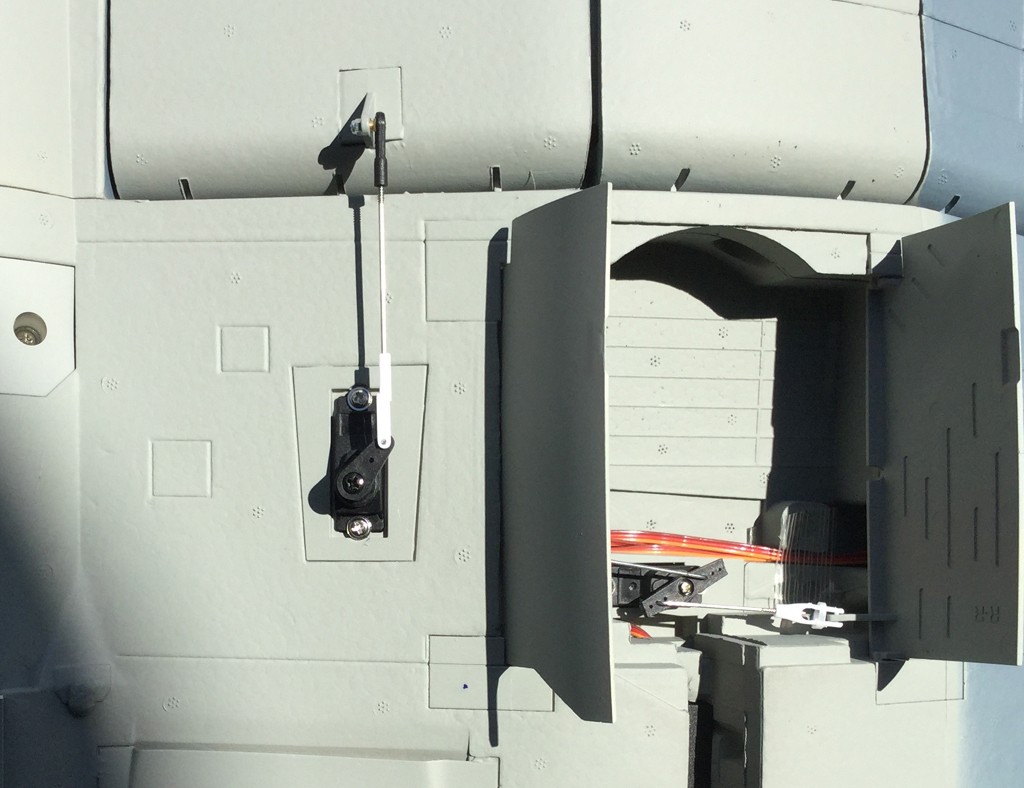

                    • I'm still in the process of assembling my bubbletop and have made some observations specific to the servos and linkage. So far the rudder, elevator and aileron servos had all required major centering and length adjustments in order to attach to the horns as per the manual. All my previous planes needed some minor adjustments which is no big deal but the adjustment required on this bird is much more than expected. I'm I doing something wrong or have the rest of you experienced the same thing? - Thanks for your inputs - Grover54

                          As for the rudder and elevator you did just loosen the friction screws until you bound your receiver right? Then center the flight controls and re-tightened the rod friction screws?
                          I think my ailerons were fine but may have pulled the arms and turned them maybe one notch on the servo spline. The flaps required pulling the arms and significant angle adjustment of the servo arms before reattaching them with flaps in full up position. Since your flaps and pretty much one way it works out perfectly.

                                Thanks Beeg. Great help and input! The worst habit I have is questioning and second guessing myself so I always defer to the experienced. I'm one of those guys that really gets rattled when there's one screw or nut left in the bag...…LOLLOLLOL
