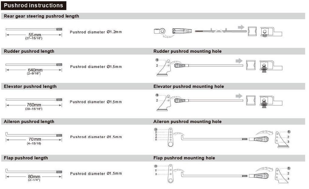

      I got my corsair today and unpacked everything no big problems with finish looks great, however one of the wing screws had bad threads and they only include just enough 6 screws, so I called and have them mailing me some new screws. Hopefully it didn't mess up the threads in the wing itself. Will see, also I will be doing control linkages tomorrow I have 6 rods and I don't know which is for which. Any help appreciated. Or pics of underside wing?! I haven't hooked up receiver or battery yet.
      • Beeg
        • 1335
        • Texas
        #1003
        From Page 5 in the manual...
          #1004
          LOL Another case of the manly I don't need no steenkin manual to assemble this toy LOL

            :) yep that's me! Also this is the first plane with this style of rod I've had nothing but eflight up til this point. Should I wait to hook up my receiver and battery before putting them on?

                No. The logical way is to bind it to a RX, power it up without rods so all the servos can center themselves. Even Eflite planes should be done this way. Remove all rods, exercise the control surfaces to make sure they move freely and without binding, center servos, attach rods, adjust rods.

                  Also, refer back to post #897 if you have issues with the flap rod lengths...
                    #1009
                    Flap rods are 80mm... Ailerons are 70mm... In my case, I had 5 flap rods and one aileron rod. I fixed it, but I did open a ticket to let Motion and Flightline know it happened....
