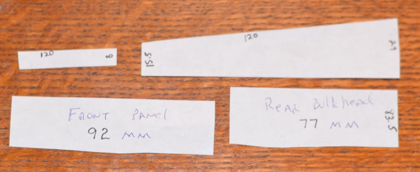

                  Aros, here is the information that you LB asked for in reference to cockpit dimensions. I PM'ed him...
                  This is from the Birdcage F4U-1.
                  I cut paper templates to the exact size and then measured them to be precise.... The instrument panel bulkhead is
                  92mm wide.
                  The seat bulkhead is
                  77mm wide and 83.5mm tall, measuring from the factory foam shelf for the factory pilot and seat.
                  The port and starboard side panels are identical in size. The rear of the side panel (touching the seat bulkhead) is
                  29mm tall.
                  The front of the panel (that touches the instrument panel) is
                  15.5mm tall.
                  The length of the panel along the top edge of the cockpit tub is
                  120mm.
                  The top edge of the cockpit sides is 8mm wide and 120mm long. Identical for both port and starboard sides.
                  I hope this is the information you were looking for, but if not, let me know and I will measure whatever you need...

                                  Thanks Hardway! Elbee is the one collection the data as I have been giving him some dimensions as well for the added panels needed as well. It takes a village my friend! Thanks again for the number crunchin'!
