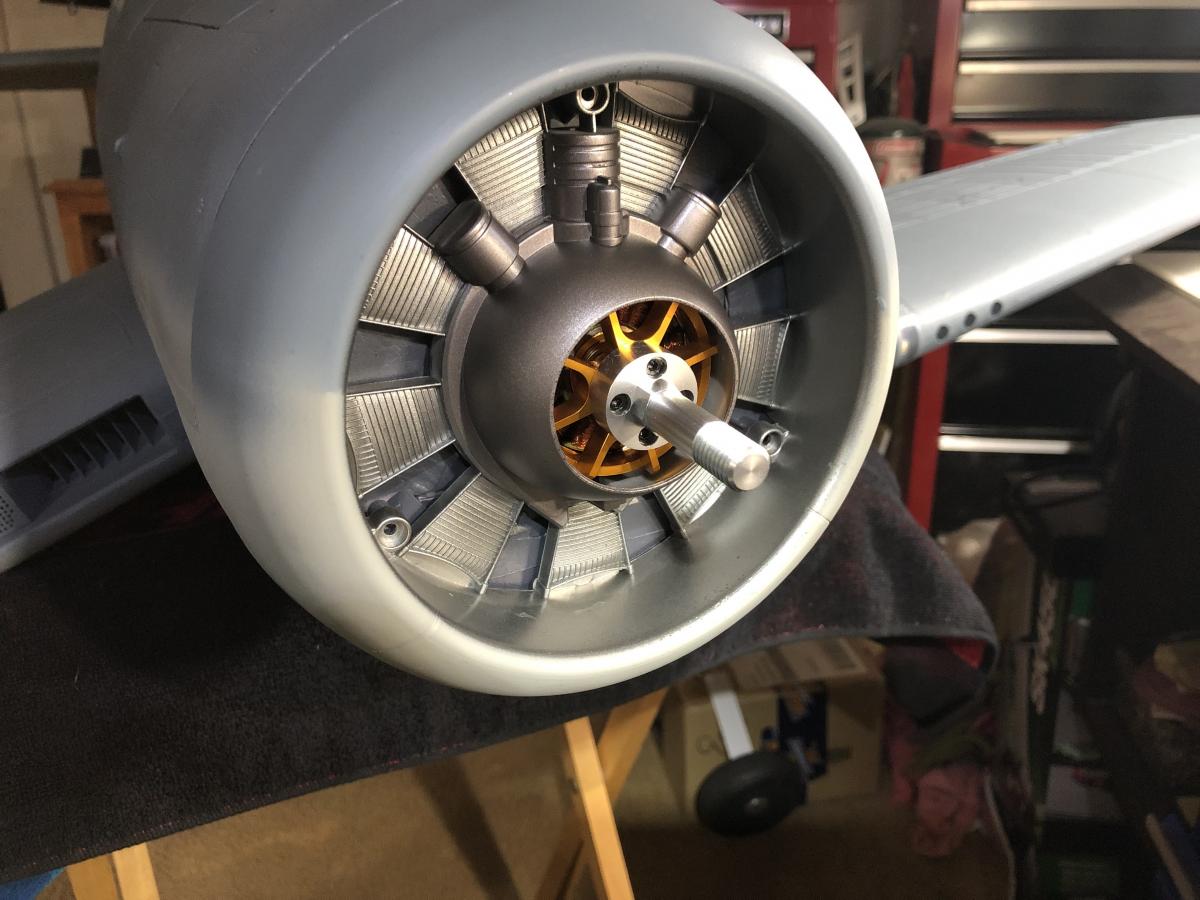

    Originally posted by theoldALFER
    Anyone know what page the detailed engine cowl resides? :pop
    F4U-1D Cowl
    F4U-1A Cowl

      I'm pretty sure that's the same part, just painted in the two versions.
      I ordered an extra one for $5 for my D.. I figure I can play with it and try repainting the inside, adding some detail to the cylinders, etc. Making this thing removable was a really nice touch by MRC.

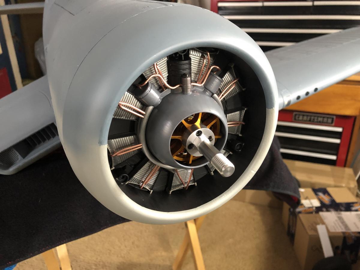

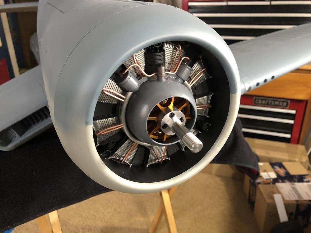

          Sorry. What I meant is that one of our fellow “contributor “ posted pictures of how he upgraded the cowl usin some electric wire etc.
          cant seem to find :Confused:

                Ole-Timer posted that data. Trying to find the post for you now....

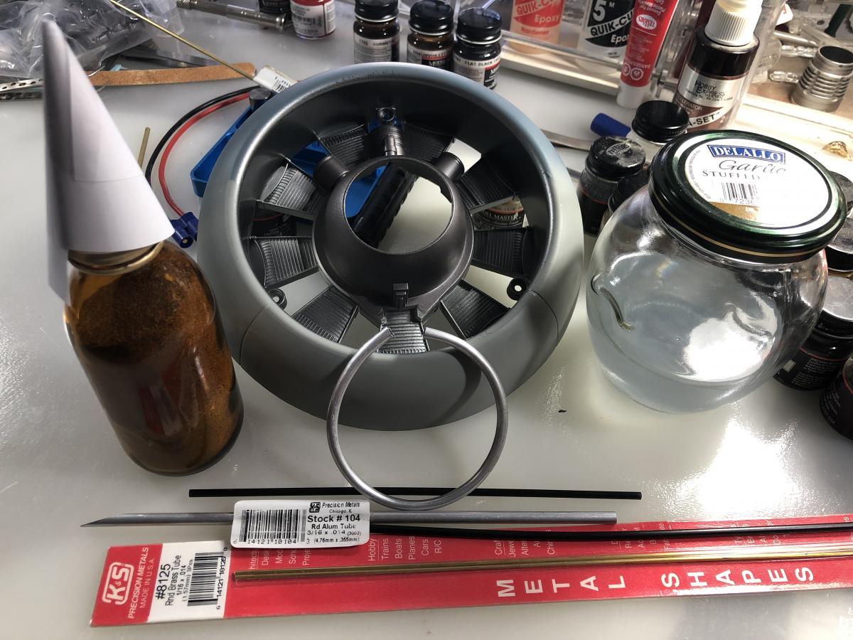

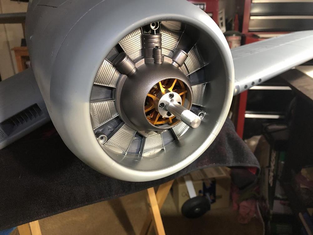

                          Originally posted by Ole-Timer
ID:	174523Click image for larger version
ID:	174521Click image for larger version
                          Alfer, post 833

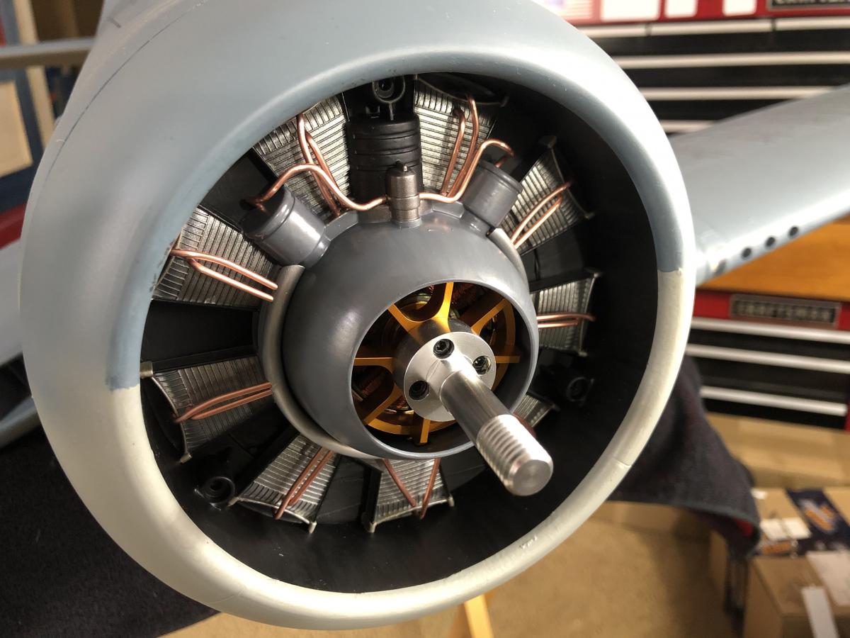

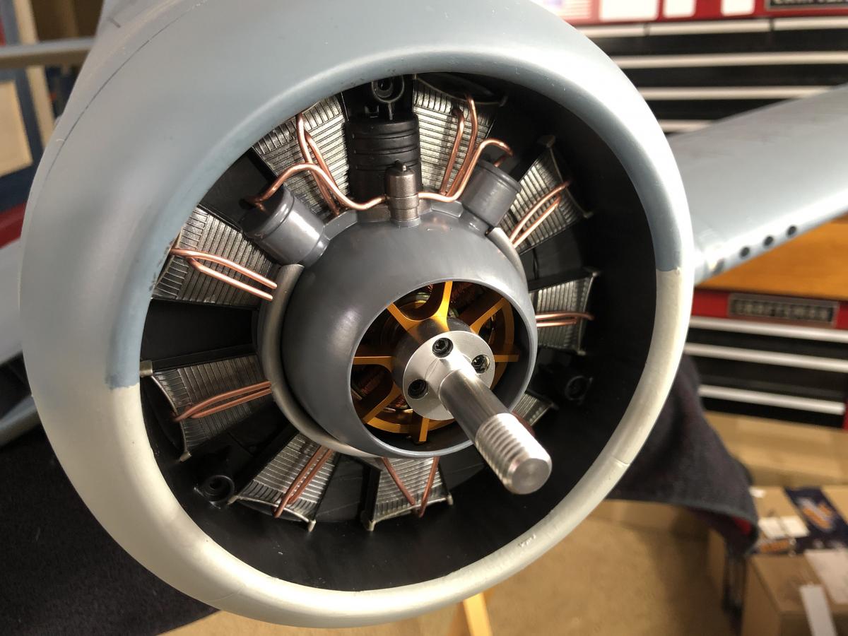

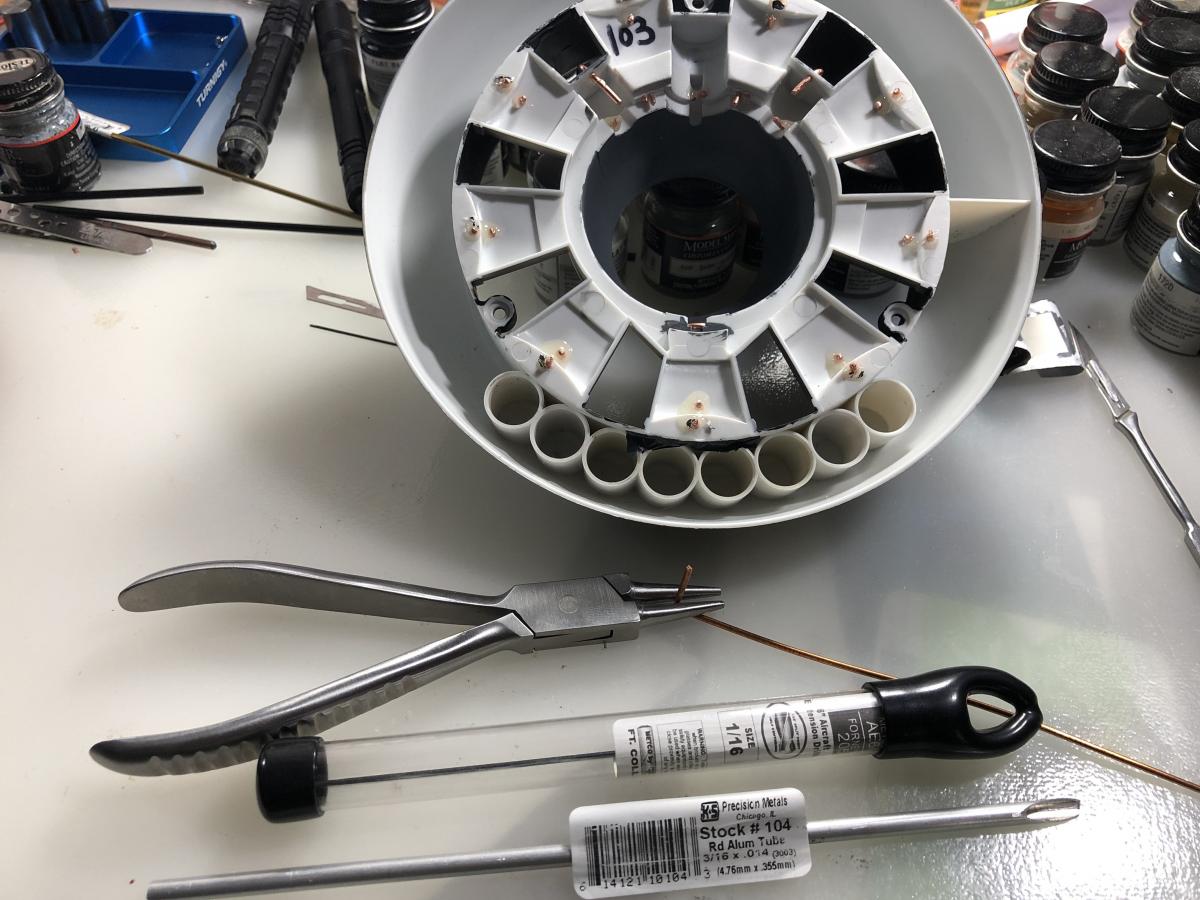

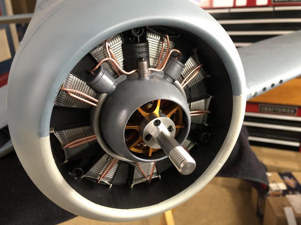

                            I used 3/16 aluminum tube filled with sand n bent, 14 gauge copper wire for the ignition wire harness. 44 1/16 holes had to be drilled to accommodate all the wires.
                            Everything fit so snug it probably didn’t need the epoxy on the backside...
                            Not perfect but at 70mph it’ll do.
                            Sorry, no 3D files here. :)
                            Click image for larger version Name:	661AE36C-4722-4582-880D-35A3464172E9.jpeg Views:	1 Size:	150.3 KB ID:	174544Click image for larger version Name:	E738BE7A-0ACC-4F32-AC1C-FE55AFA8098A.jpeg Views:	1 Size:	128.7 KB ID:	174543Click image for larger version Name:	45245E88-DF6C-4EFA-8DDE-5E1E21723282.jpeg Views:	2 Size:	114.3 KB ID:	174545 Click image for larger version Name:	CA349BCD-A52F-4730-A5DE-C9DBA390BB90.jpeg Views:	2 Size:	136.6 KB ID:	174547
                            And this one

                              #1294
                              I simply used what I had on hand. Didn’t spend any extra...
                              Posts 833 on page 42 and 842 on pg 43
