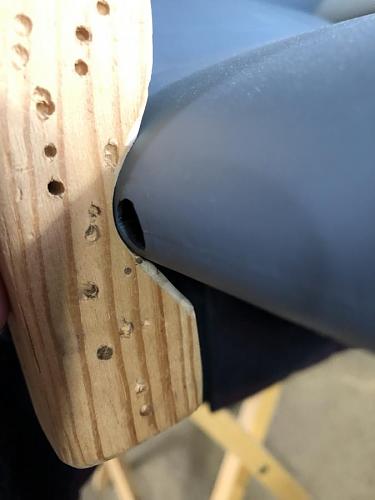

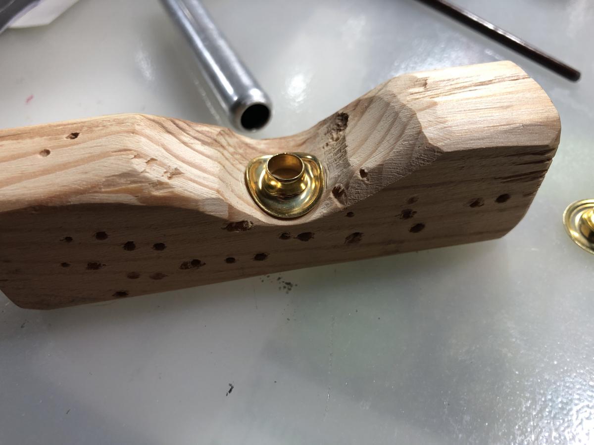

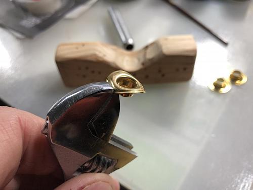

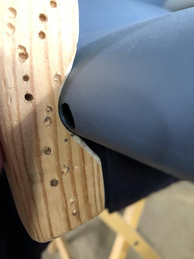

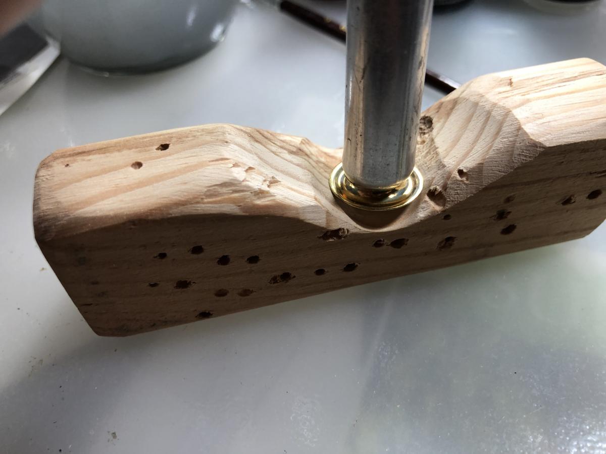

                          Gun ports on the Corsair have been bothering me. I was simply looking for any way possible to make them look more rounded and not just malformed holes in the leading edges. Since the actual guns were buried way back in the wing and fired through long blast tubes, something had to give. I stock all sorts of odds and ends with that sometimes taking a bit to remember where I stashed something.
                          I decided the only thing I had on hand even remotely close to a gun port were brass grommets for tarps. They indeed fit the slightly oversized stock holes very well.
                          Click image for larger version  Name:	77D9FD37-9098-4AB9-9329-F9CA23CD564D.jpeg Views:	1 Size:	86.4 KB ID:	178166
                          I grabbed a piece of scrap wood off the drill press and using the belt sander and dremel, form fitted the wood as a form to the leading edge radius.
                          Click image for larger version  Name:	DA6E5765-93FC-4EE0-A439-BF489548B15C.jpeg Views:	1 Size:	41.5 KB ID:	178171

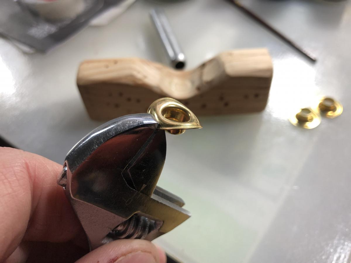

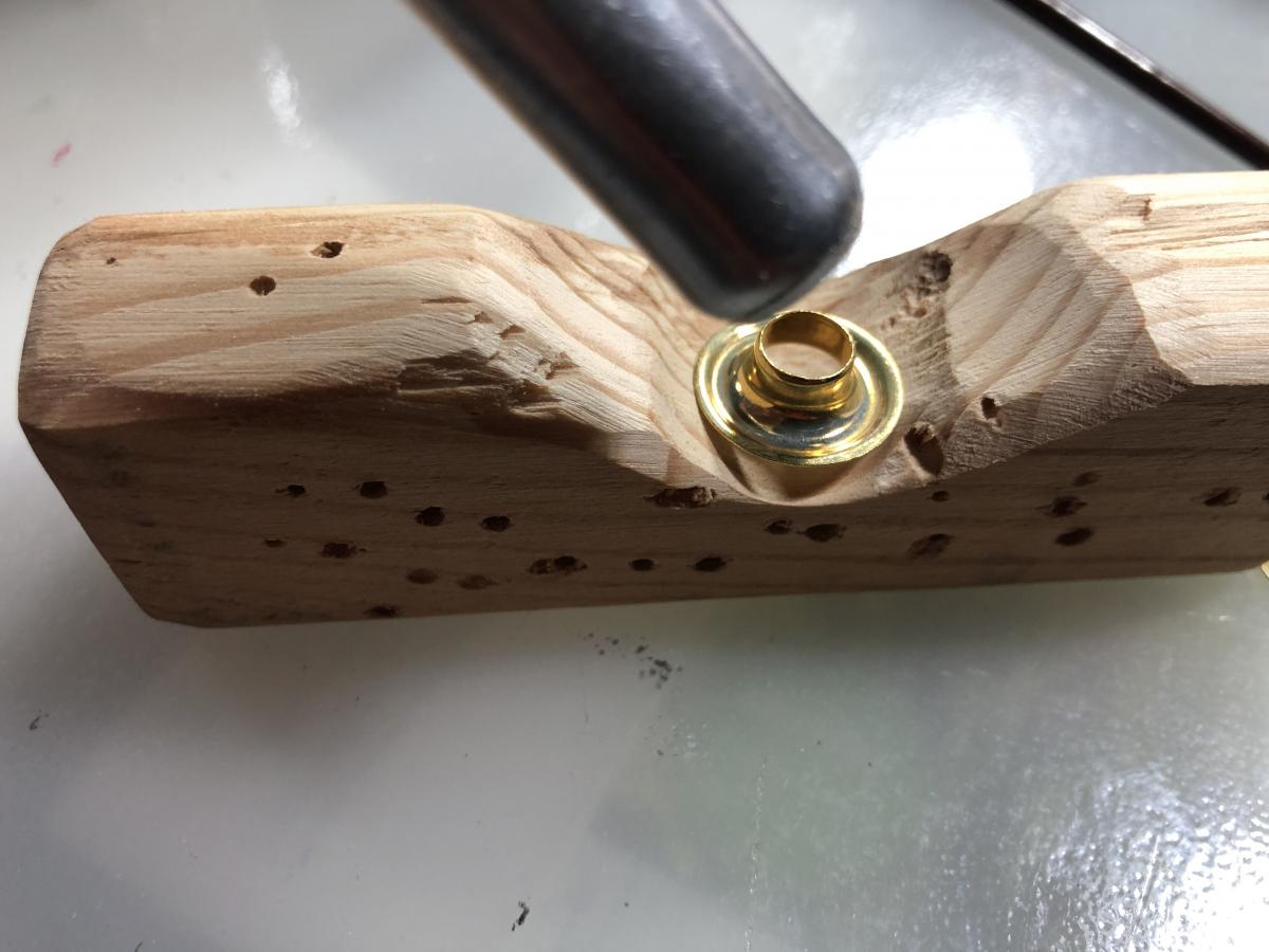

                          On a stout surface, place the grommet into the leading edge form, using a slightly larger piece of tubing over that, pound the grommet down into the form with a small hammer to attain the basic shape.
                          Click image for larger version  Name:	71447F54-DEF6-41F3-B1B1-E82119FD7F95.jpeg Views:	1 Size:	89.2 KB ID:	178167Click image for larger version  Name:	3450ADE5-51AB-41BE-AEB0-A532B6DE0C2F.jpeg Views:	1 Size:	81.4 KB ID:	178170Click image for larger version  Name:	71ADAC55-697D-4A11-8B67-3A6CB18012D2.jpeg Views:	1 Size:	85.7 KB ID:	178168
                          A small crescent wrench will fine tune any edge to fit perfectly.
                          Click image for larger version  Name:	98FE1B3D-ABA2-4251-95A1-52B04E6742E9.jpeg Views:	1 Size:	66.1 KB ID:	178165
                          Tweek each grommet to fit perfectly. I just hand painted each one for now. You can also reduce the size of the grommet’s outer diameter by sanding it down if you want a crazy scale look!
                          Click image for larger version  Name:	E3140155-CAE7-4ED2-9659-04970ABBBE4B.jpeg Views:	1 Size:	59.0 KB ID:	178164
                          ‘Or just install them as is...
                          Click image for larger version  Name:	048BC485-FD7B-4D81-94EF-2D45ACEC90FC.jpeg Views:	1 Size:	76.9 KB ID:	178163Click image for larger version  Name:	571EF01E-40F4-47D0-A6B5-332E3E623F0B.jpeg Views:	1 Size:	74.9 KB ID:	178169
                          Enjoy!

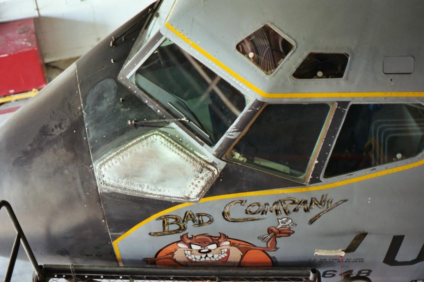

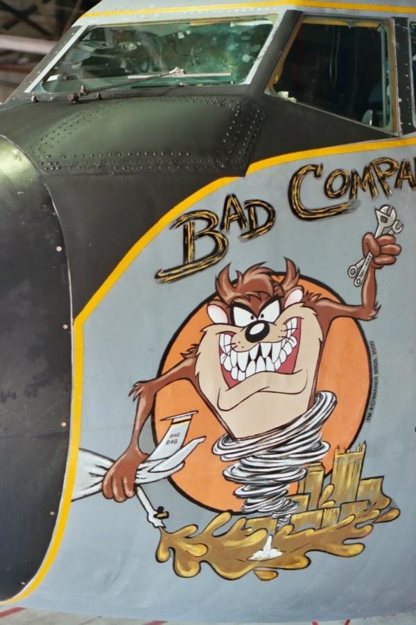

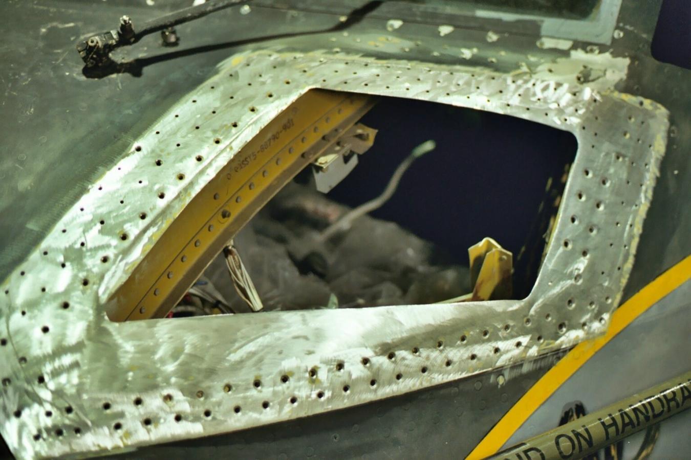

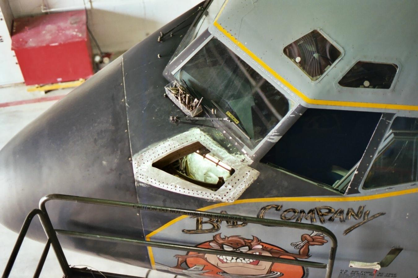

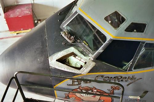

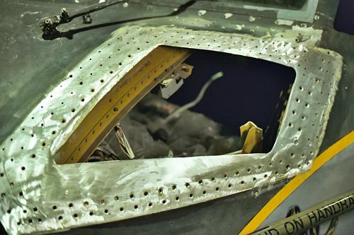

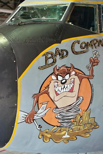

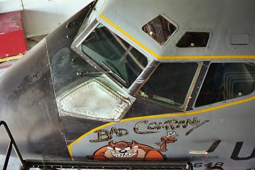

                                    Thirty years in military aviation as a structural mechanic and systems technician, there ain’t no such thing as 3D printing. You fabricate everything from scratch.
                                    Working stateside was a simple pleasure, working from forward operating locations at X Y Z where you had none of the standard large tools of the trade would make or break your abilities.
                                    A ground handling mishap punched a large hole in this tankers nose, compound curve ... Just awful... My friend John, who was also an ex Navy structural mechanic, had nothing but an aircraft tow bar, scrap wood, and a hammer to create the compound curved patches while I went everywhere to source fasteners. Had Ole Taz done and flying in two days...

                                        Not sure what today’s FAA is doing...? Sadly, they weren’t there for us then as the ground troops in Afghanistan that needed the air support couldn’t wait.
                                        There has always been and always will be technical data and specific criteria to follow during any aircraft maintenance.
                                        A patch of this magnitude required Boeing approval, and had to be followed to the letter of their wishes and tech data.
                                        We were the last unit that I know of doing large “authorized” field repairs in theater and at home stateside.
                                        Taz flew with this patch until it was retired.
