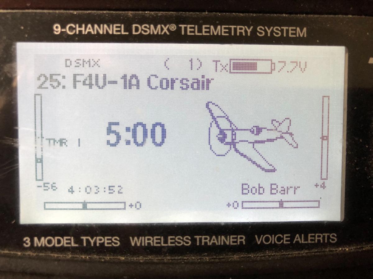

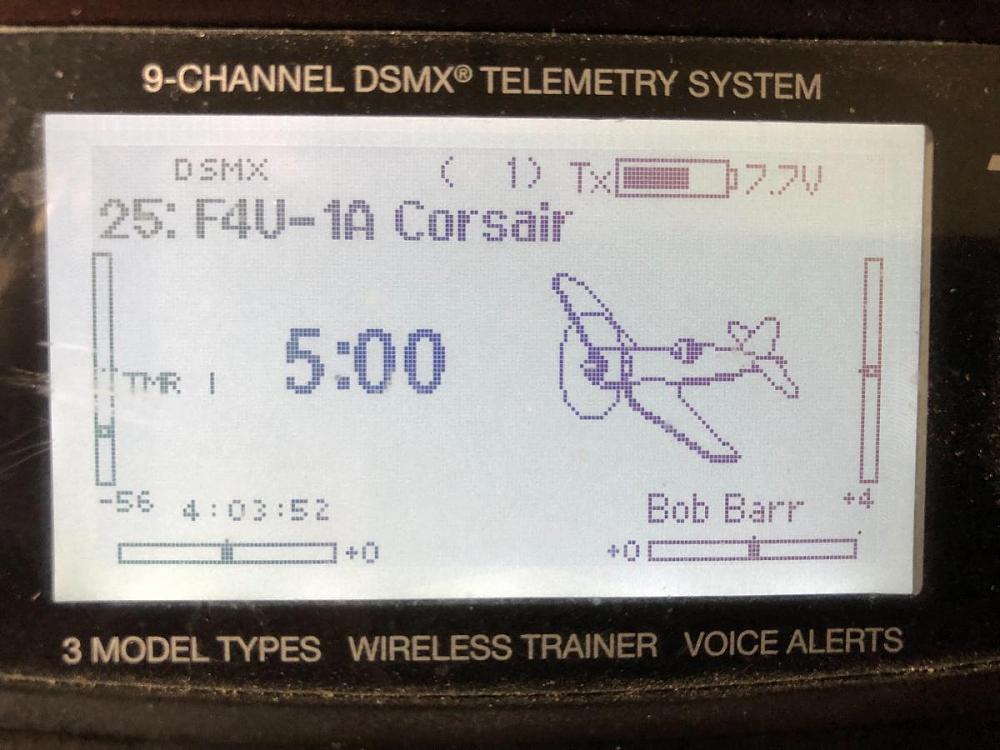

                                    Ive noticed if I deviate from the procedure and turn the transmitter on, keep the throttle off, run the throttle trim down all the way, then go full throttle, plug in the aircraft battery, hear TWO beeps, pull the throttle down, then hear the standard initiation beeps, my throttle becomes more sensitive at the lower end. If you ever hear more than TWO beeps, your now in program mode.
                                    I indeed set this speed controller as stated above and have perfect low end initial start up. With the throttle off, 22 clicks of up on the throttle and the prop rotates. That’s not quite 1/4 of the way up from the bottom of the throttle trim. With the trim nearly bottomed out I have fairly instant prop rotation on the stick.
                                    In the picture, just using throttle trim alone, this is where my prop begins to rotate. Hope this works for you.
