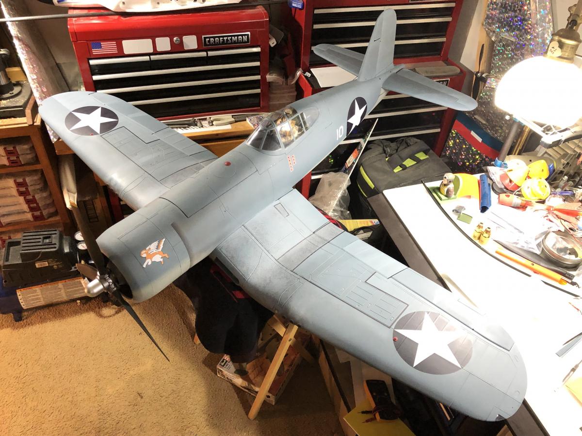

      • I got my bubbletop Corsair last week. Had a friend do the maiden on it which went well. I flew it yesterday, got about 6 takeoffs and landings. None of them perfect yet, but safe, no dings, scrapes or gnashing of teeth! I decided to paint mine up in the colors of one of the planes from the top Corsair ace (25 kills), Lt. Robert M. "Butcher Bob" Hanson, USMCR. I'm still waiting for some graphics from Callie, but I'm going ahead with detailing the engine compartment some, and doing some weathering on the plane. I think I'm going to really have fun with this one!
        • Looks great Dave! Love the weathering and engine detail. Don't be like me and hit stall speed before the flare finding out the retracts sacrifice themselves in order to save the integrity of the wing and you won't have to worry about a thing. She's a jewel!
            Sorry that happened, Aros, but you'll be back at it before you know it! I did put my landing flaps at the scale 40 degrees deflection, probably more than what the manufacturer recommended, but on advice from others on this forum, I kept the power up right into the flare and it seemed to work out ok. Got a little harmless skip on some landings, but I'll iron that out.
            On my Flightline 1600mm Spitfire, I put the landing flaps at the scale 85 degree deflection, and that works very well for me and looks cool, too!

              DG, She looks great. Beautiful detailing. Bravo Zulu. Best LB

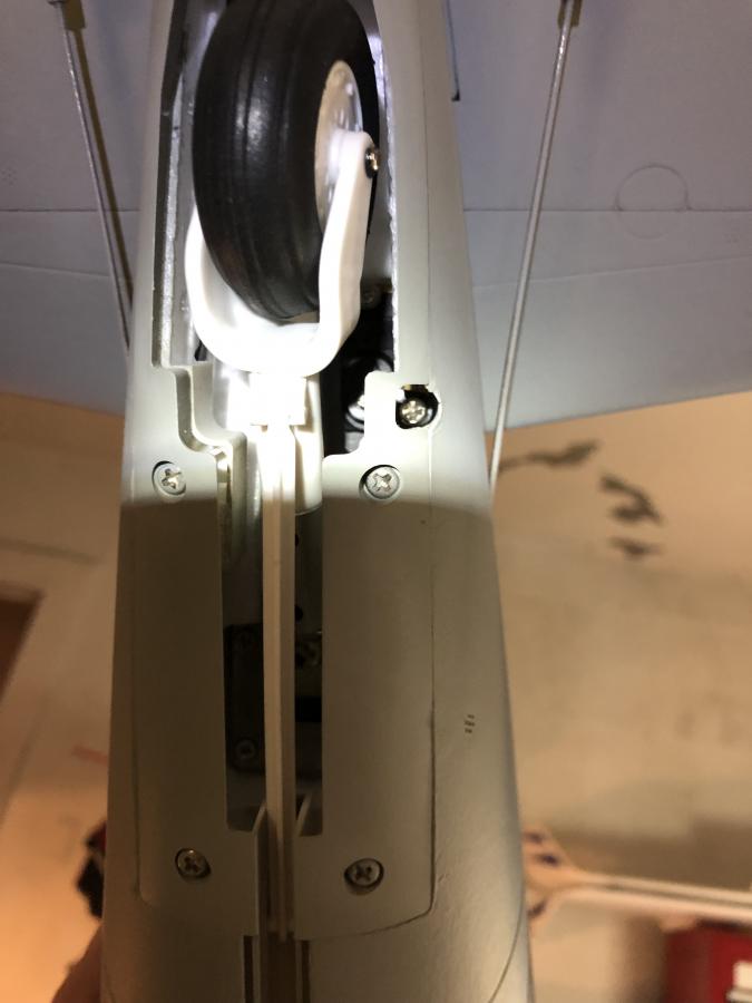

                  • Loving my birdcage but I got my tail wheel out of alignment yesterday dealing with a tricky crosswind. Still retracts fine but obviously pulls to the right on the ground. How do I fix this?
                    also, does anyone have a good color match for some touch up paint?
                    thanks
                    • Originally posted by Skosh25 View Post
                      thanks
                      Deploy the tail gear. Look down into the steering mechanism where you should see the control rod from the servo to the steering arm. There, you should see a lock screw. You should be able to deduce what to do next.
                      • Your pretty much staring the set screw in the face when you look to the starboard side of your tailwheel.
                        Its in that nice little hole to fit a Phillips screw driver into.
                        Mine was not straight from the factory and required monkeying.
                        I use Testors Intermediate Blue to do the paint deed. But in my case I’d be horrified if anything matched on the Gophers upper surfaces! Straight up is factory of course.

                            That was painfully obvious and took no more than 5 seconds to adjust.
                            Great finish work by the way!

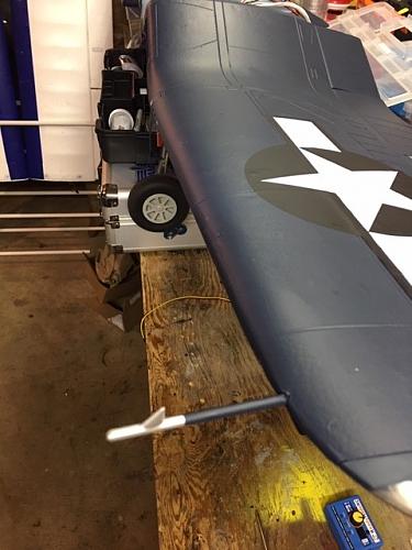

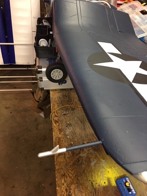

                                        • Originally posted by Grover54 View Post
                                          Pitot Tube solved! Made a minor mod to an FMS 2000 DHC2 Pitot, painted it and glued in place. Life is good!:Cool:
                                          I'm an idiot! :Silly: Spent way too much time on this damn pitot tube BUT I think I figured out why it didn't come with one in the beginning! It lasted about 5 minutes.....I broke it off loading the wings in my SUV. LOLLOLLOL I'll try to shorten it and push it deeper in the wing to firm it up but if it snaps again that's it, damn the scale police...... I'll DAP the hole and paint it. :Cool:
