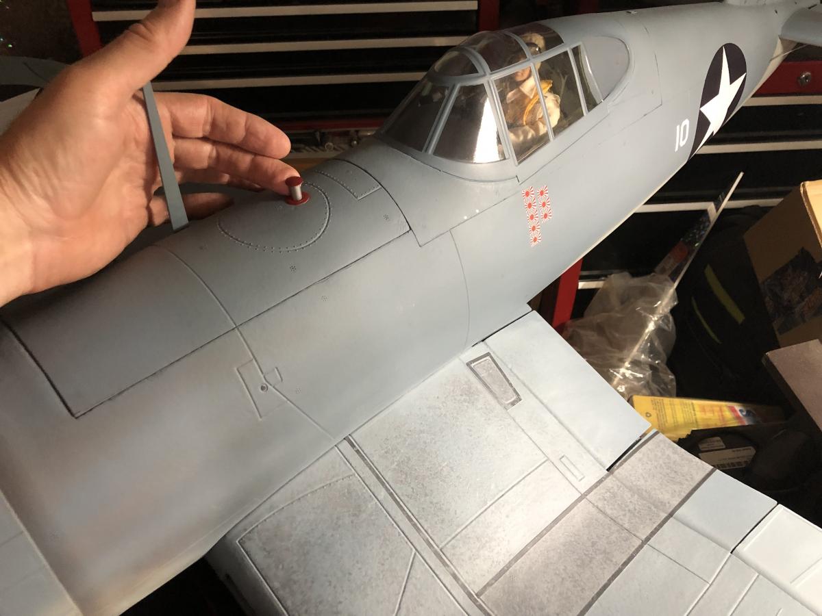

                    • I filled in the step and I painted the rear window because it looked out of place. Didn’t know that on the full scale it didn’t exist.
                      See even a blind squirrel can find a tree sometime.
                      Ken

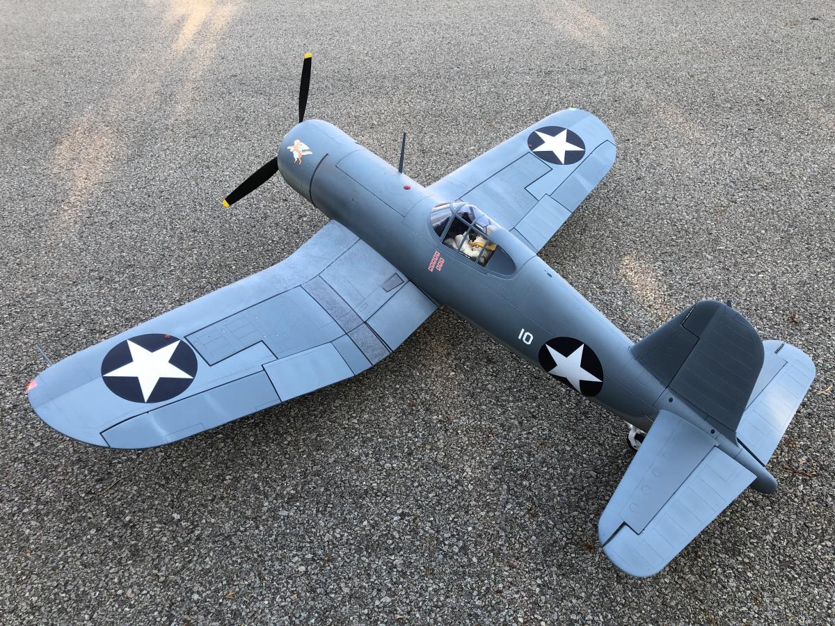

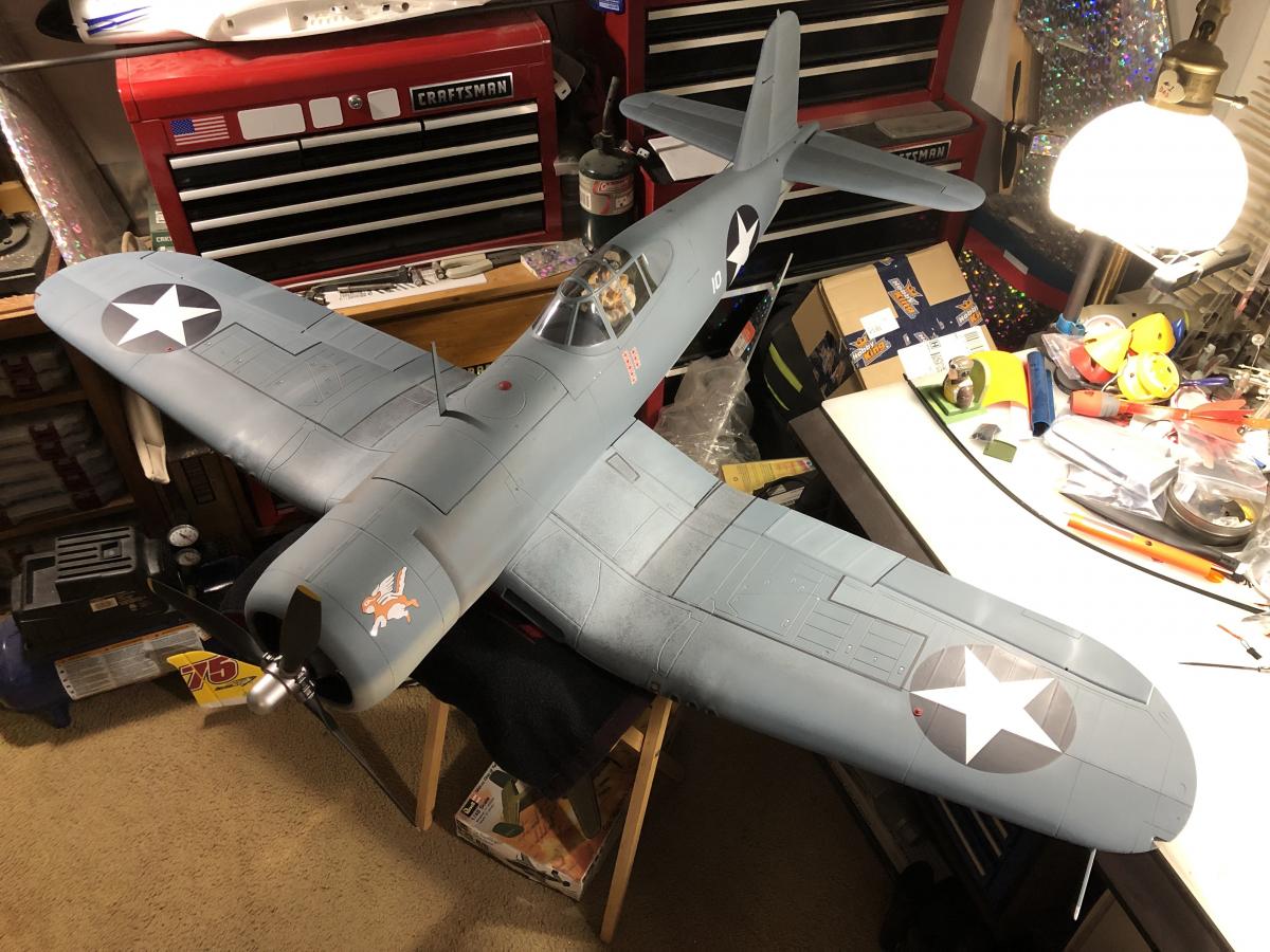

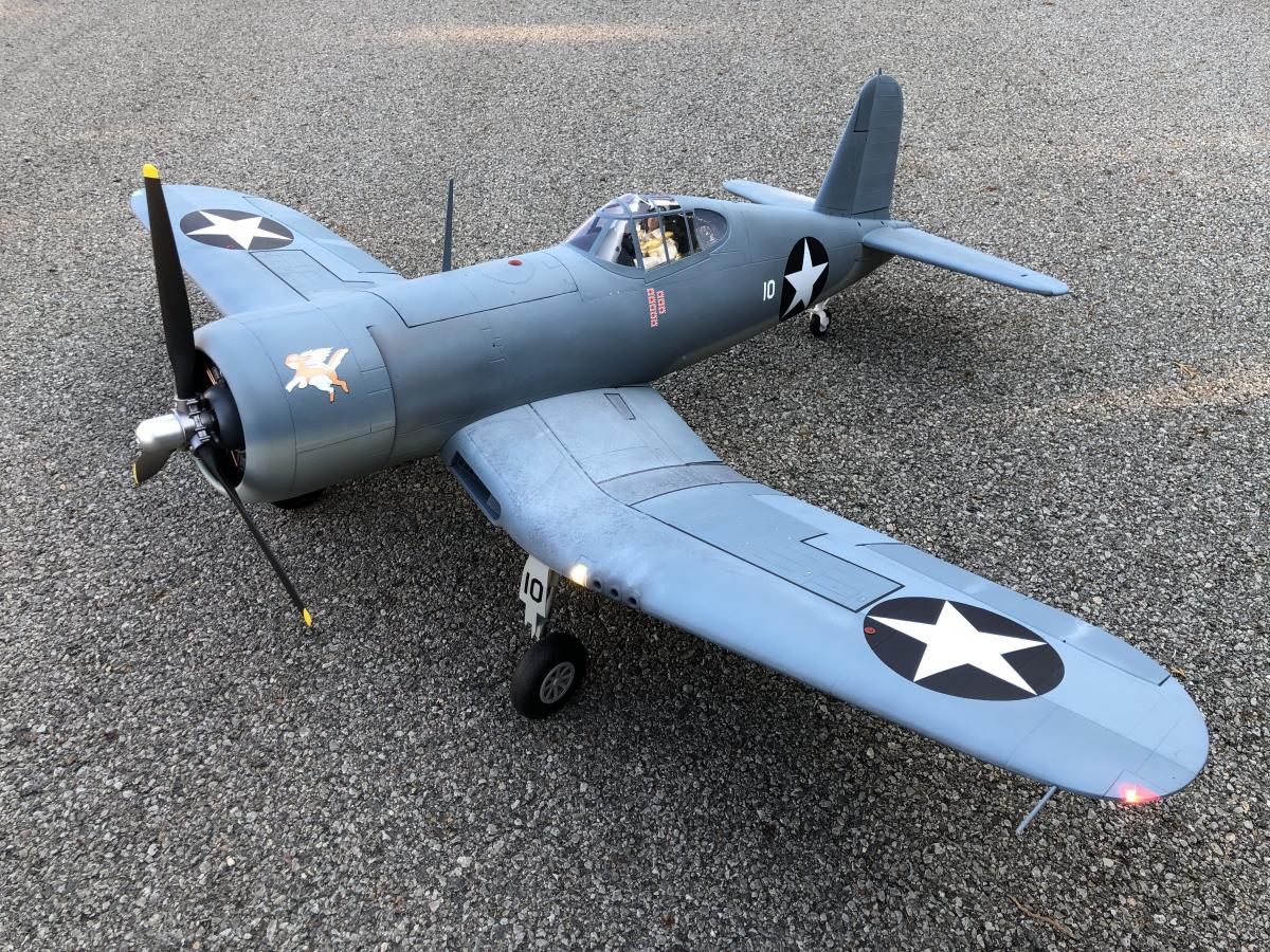

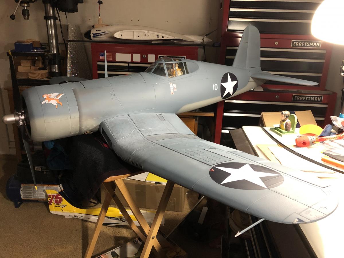

                                  Having only one view of the actual aircraft I wanted to model, I studied many Corsair pictures and in particular paid close attention to the same squadron VMF-213. It’s common for squadron aircraft to share attributes due to having similar maintenance and mission use.
                                  Before going into the paint shop I premixed four different shades of intermediate blue. One only slightly lighter than the original color, one with quite a bit of tint to lighten it for cloth surfaces and things like the top of the fuselage. Two more blues were shades in between these two. I began by masking the cloth areas off and sprayed those with the lightest blue. Removed the masking, Then I backed off and began to lighten other areas with the same like the top of the fuse, wing, n tail edges. Things I saw in photos and using a blended light effect. Once I was happy with that, I further worked it over with the two in between colors, always keeping some distance to create blends. Finally I used a couple light greys to add some odd color here n there.
                                  The sea sponge to the inboard wing worked to kinda duplicate boot marks but sanding that lightly with worn out 240 paper just took all the harshness away and blended that as well.
                                  I have used an old dry brush technique to simulate oil leaks from cowl flap actuators. Regular #2 pencil and brown colored pencil mixed. I get a pile of these two frowned down on a piece of sandpaper then apply it with a 1/2 inch brush.
                                  Since VMF-213’s birds didn’t have fuel spilled all over them, there was no need to run thinner over the paint to duplicate that.
                                  I have had years of practice air brushing models freehanding camo paint and I’m used to backing off to blend color. I shoot nothing but Model Master enamels and thin with mineral spirits. The other thing that helps blend is thinning the paint out so it can be shot lightly over wide areas to soften the look.
                                        Scale notes, for anybody interested:
                                        The rear window did indeed exist (at first), but did not have a metal frame (the painted vertical frame furthest aft as produced by FL). That was just clear plexiglass of the sliding portion overlapping the fixed plexi of the rear-view (half oval) plexi. I removed the paint from my canopy right before I repainted the frames 50% wider to a scale width -- WAY too skinny as produced by FL.
                                        Vought redesigned the turtledeck beginning with F4U-1 BuNo 17532 (according to Dana Bell's birdcage book) -- this eliminated the rear view half-oval clear panels and added solid (painted) areas to the aft portion of the sliding canopy. One big reason for the the change was the addition of a stronger turnover structure in the turtledeck right behind the headrest. This is described and shown on pages 23-28 of Bell's book.
                                        It's surprising how many of the color profiles for the Corsair include the BuNo (serial), which would tell you if the particular example you are modeling had the windows or not. From what I have read, these windows were of very little practical use (especially compared with a beefy turnover structure which could save the pilot's life).
